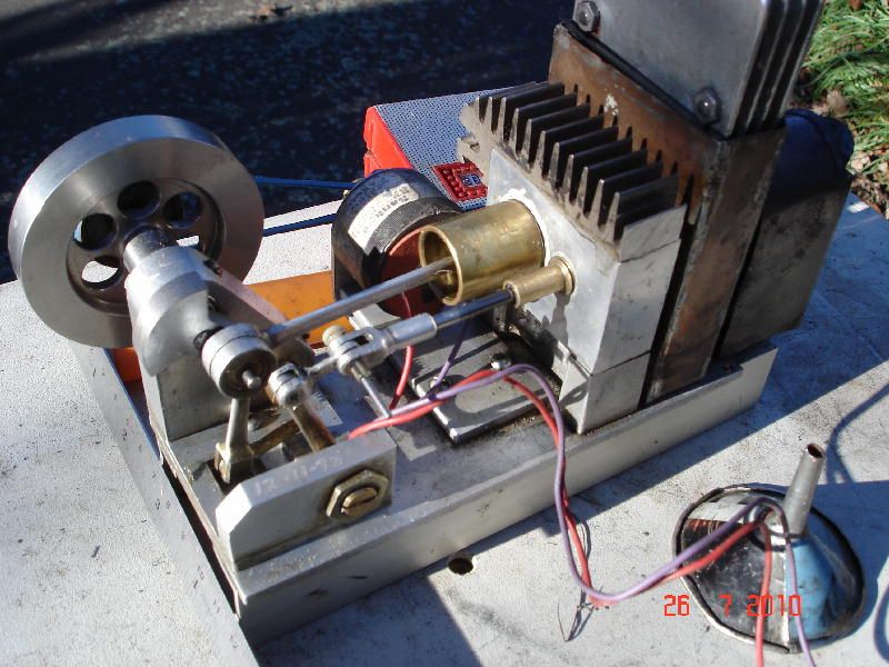

                                      This little motor is based on one built by Justin Jones in 1997, it featured in ME in March that year. It has a bore of .625″ bore and .5″ stroke on the power cylinder, and a stroke of .75″, and bore of .625″ for the displacer. It has a meths burner. It runs a little generator that supplies enough power for a 3 V radio. the capacity of the motor is somewhere about 2.5 cc. This is my 6th motor, and smallest.
                                      Justin’s one was winner in the Gnat power competion. Ian S C

                                        Hi Ian that is an interesting motor you have there, bell crank displacer drive I assume from the pic. I haven’t built anything since the quake just couldn’t get interested, but I have begun assembling tubes and other bits for a project that is a Beta design using half a Ross yoke. You just have to extend the rocker arm to match the top of the Ross yoke to drive either the displacer or the piston. I hope to come out for a visit maybe in the spring when things warm up and the earthquakes slow down a bit.

                                          Hi Mark, you might be able to get out to the Homebush open days, last years ones went well, the stables were damaged in the September earthquake, but by November were repaired and heavily reinforced. First weekend the house was a pile of rubble, and by the next weekend the rubble was cleared and the ground smoothed. When the worst happens, you just have to get up and get going.
                                          There is two versions of the little motor in ME back in ’98 GAMA , and BETTA, I desided that the GAMA would be the most efficient, with the piston so small the area of the rod going through would be noticable,(also fiddly). The gland for the displacer rod is a carbon impregnated teflon bush (theres a bit in my photo album about that). The bottom bearing for the bell crank is the ball bearing pivot from the tone arm of a record player. The original displacer was the body of a white board marker, the new oneis the shell of a AA size Ni Cad battery, its a bit too heavy, itr needs to be made of .005″ to .o10″ stainless steel. Ian S C

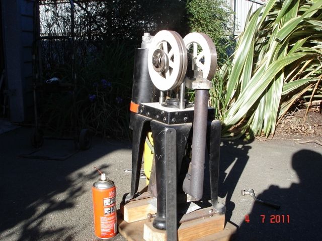

                                                    A bit biggerThis is my largest motor, a BETA type with a bore of 2 1/4" and a power stroke of 1 1/4" and adisplacer stroke of 1 3/4". I have not tested its power since I fitted a new stainless steel displacer cylinder, the old cylinder was mild steel, and had bulges in it, and the inside was flaking. Ian S C
