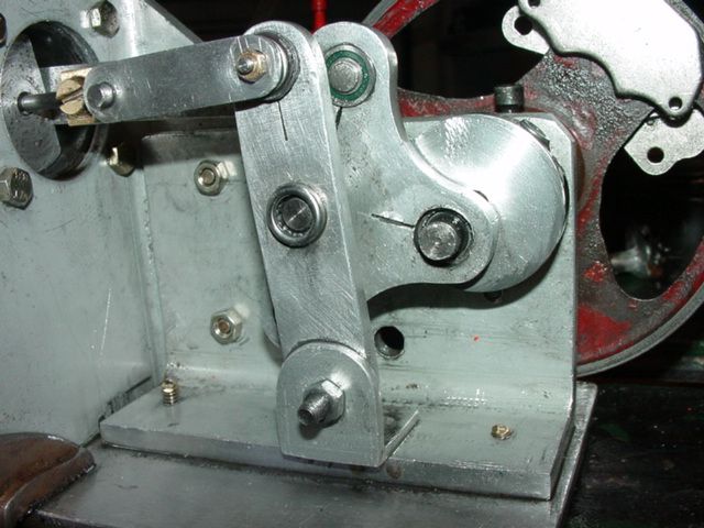

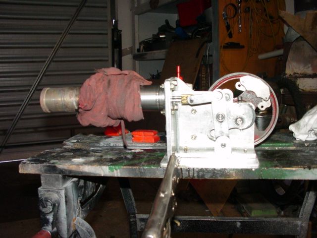

          Well, it’s going again, and all I did on reassembly was change the oil to light sewing machine oil; a little heat and wrapped the wet undies for a cooler and away she went. This type of crank, namely a bell crank and a rocker arm give near perfect staight lines to the piston and displacer and not too difficult to build. Now to build the heater, cooler and the engine mounting.
          Incidently I put two hard drive magnets that are kidney shaped on the flywheel for balance. I found the best setting was not `absolutely opposite the crank pin but a few degree ahead of it. I will post a pic of it at this stage but remember I am not an engineer and my engines are made of mostly found materials and junk parts, Ala rizzo.
          Mark
          #51728
          Mark Smith 3
            @marksmith3
            Here it is, in the raw complete with wet undies. The mechanism is a bit hard to explain without pictures in case someone wants to try this crank drive for themselves.
            The main advantage is the very low side loads on the con rods.
            As you can see the bell crank was originally a Ross yoke for a Rider type engine but for various unknown reasons not to do with the crank it refused to run so I went back to the Beta design and changed it to what you see, and it works.

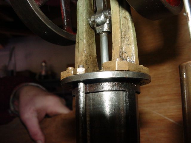

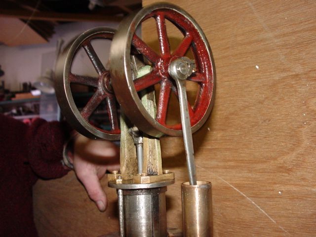

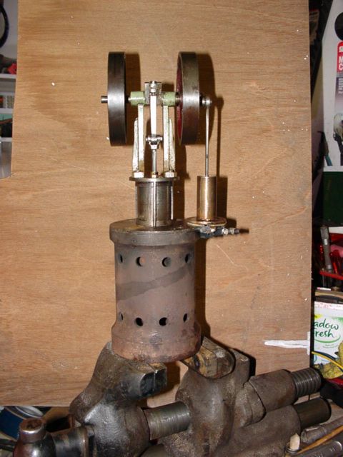

                          Can anyone throw light on this old engine, it seems to have been made from a set of castings probably maybe fifty or more years ago.
                          Mark

                              A friend has the engine above and he has been trying to get it running better, but since he started he has only made it worse; I fear he is going to damage it before he hands it on to me to fix. The main problem that could see was it leaks air at the flanges – no gaskets just gasket goo. There is no friction and it might leak back past the piston which is not a big deal so long it is at a minimum.
                              I did get it to run when he first brought it around but it took 5 minutes of gas  flame before it started and was ant power. Also it has no cooling system and the heat transfered to the cold cylinder very quickly – maybe some wet undies might help here in the interim, what think ye? This engine should easily run with meths or a mamod tablet.

                                That engine was proberbly made to run on meths. You could add fins, or make a water jacket to slide over the top bit of the displacer cylinder.
                                What is the little bit sticking out the side at the bottom of the power cylinder?
                                Think I sent a message on here, have a look.Ian S C
                                #52919
                                Mark Smith 3
                                  @marksmith3
                                  The little bit you see is a long allen screw that is supposed to block the end of the transfer tube. I don’t think it was like that originally.  The transfer tube is screwed into the displacer via a brazed boss which is threaded internally. I suspect that is another source of leakage which teflon tape should cure. But the greatest leak seems to be between the flanges below the power piston. A gasket should cure that.
                                  The displacer rod is large for such a small engine 3/16″. Also the gap around the displacer and its cylinder is large, too. I estimate nearly 1/16″; too big according to Rizzo. But the engine does run with enough heat.
