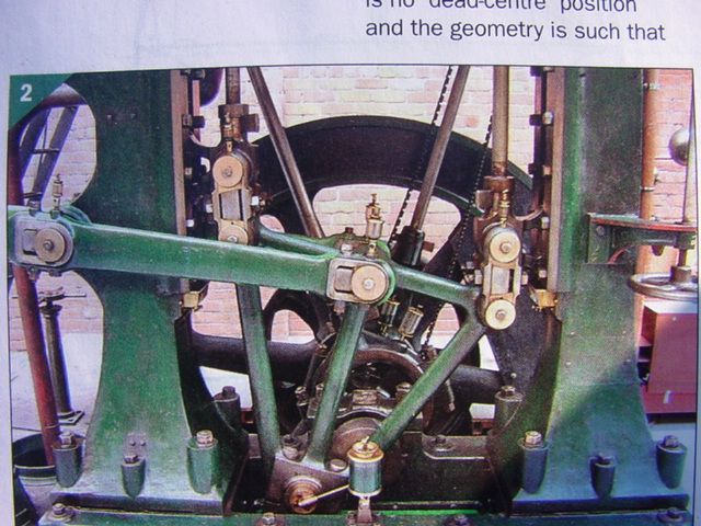

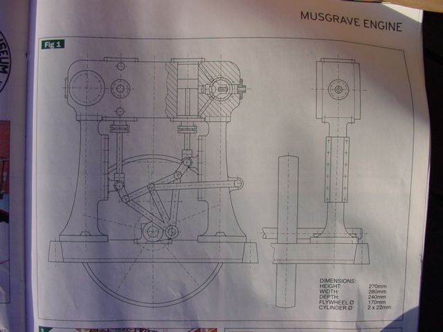

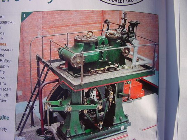

                                          #48070
                                          Mark Smith 3
                                            @marksmith3
                                            Here is something interesting. I got an ME mag from the library today and found this article.
                                            We like to call this the Ross Yoke . . . MMMMM.
                                            The article, if you want to check it out, is im ME Vol.202 No 4350 24th april . 7th May 2009.
                                            Mark
                                            P.S. for some reason the site won’t accept scanned pics so I had to photograph the pages.
                                            Edited By Mark Smith 3 on 31/01/2010 07:04:30
                                            #48077
                                            Ian S C
                                              @iansc
                                              Yes theres nothing new,even this one wasn’t new, in 1838 some one by name of Galloway (think thats right) built one with the cylinders at the bottom, crank at the top. The one in your photos, according to Wikipedia is in the Bolton Steam Museum, and is called a non dead center engine. The theory by some on the “net” is that the Ross patent is for the ballance system ie the ballance shaft.Not long in form the workshop, I’ll proberbly have a stiff arm in the morning, I’v been lapping cylinders, I’ll finnish them tomorrow, I want them like mirrors in the bore.Tried the alternative system of stabalizing the bellcrank, it looks worth while, once I get the engine running I may change from the side rod to a central pin. I found a LTD motor using that system. Ian S C
