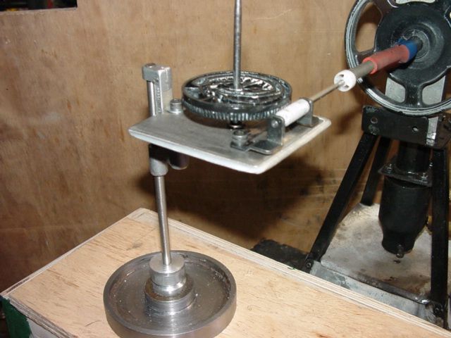

              I have made my rev counter today. It is made from bits I found around my shed, namely: sewing machine parts, 95 tooth gear and worm from a VHS recorder, and a base made from a flywheel I had turned but wasn’t happy with.
              My latest engine, The Devon runs at 820rpm while the engine you see was doing 980rpm. Next  thing is a torque arm to measure the watts or part thereof.
              By the by you said you found a bearing in part of a VHS recorder, well there are two more very nice bearings in the head rotor.
