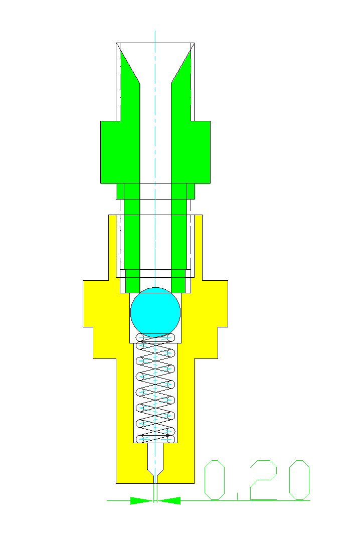

                    Roger B
                      @rogerb61624
                      Another option might be an open injector. I made this as a trial with a non return valve and a 0.2mm (8 thou) orifice.
                      There was not enough atomisation for the diesel but it might work injecting into a vaporiser
