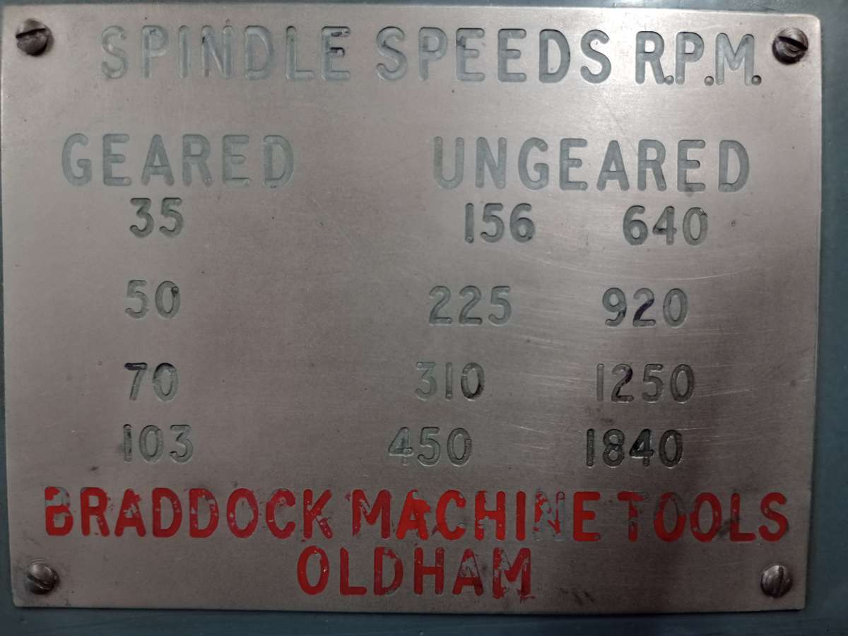

              Here’s the full speed range for the machine, which makes it quite versatile along with the vertical head. The principal issue is as I’ve said before  – the torsional reaction in the rapid feed cross shaft and under heavier cuts, slippage of the clamping mechanism. The cutter currently mounted is a new Firth 5/16″ x 4″ 16 tooth cutter. I’m using this on mild steel.
              Helical slab mills operate a lot better due to the shearing action and constant tooth contact.
              Maybe the cross shaft and clamp would be better cleaned of lubricant for use in the locked (handwheel) position to afford a better grip.
              It really would be interesting to see the original user manual for the standard machine with its high spindle speeds. Clearly there was enough of a shortcoming that it was worthwhile redesigning the drive arrangement.

                  On Mick Bailey Said:
                  […] It really would be interesting to see the original user manual for the standard machine with its high spindle speeds. […]
                  That ^^^ is an extremely good point, Mick … and is probably more widely relevant as ex-industrial machines continue to come into the hobbyist’s reach.
