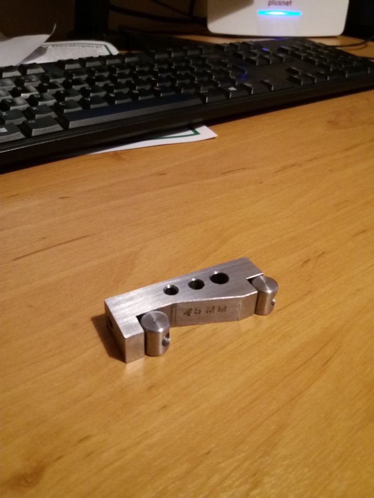

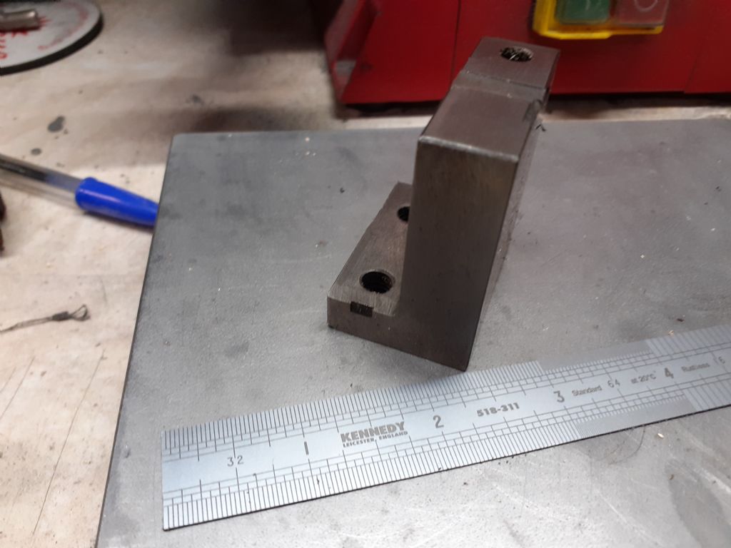

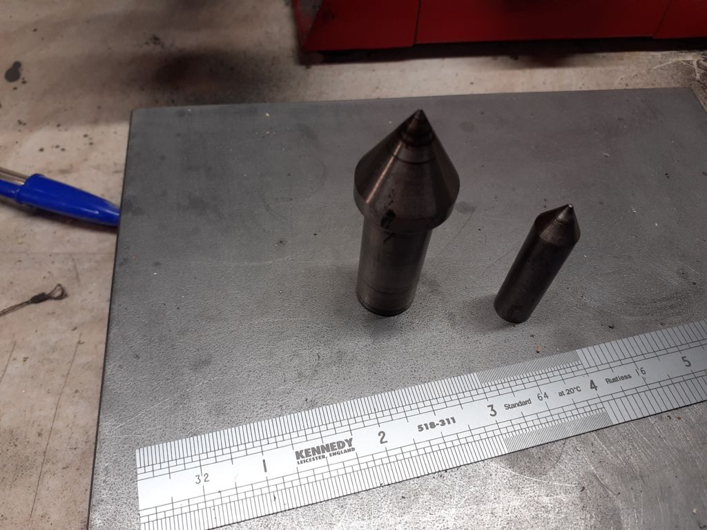

            Hi Jeremy Here are a few bit i made and are useful.
            Small angle plate approx 2" x 2" 1" with a 1/2" step with a few useful holes.

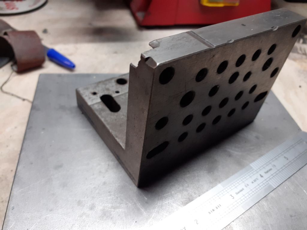

            Angle plate made from a bought cast iron angle plate with lots of useful taped holes etc

            Centers for chuck for tapping or centering. Silver steel hardened and tempered.

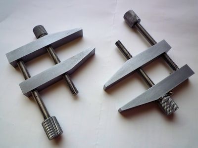

              You could do worse than make a couple of these toolmakers clamps.
              Whilst not entirely lathe work most of the machining could be carried out on the lathe at a pinch although a mill or at least a drill press would be handy. Detailed "how to" on my website:-

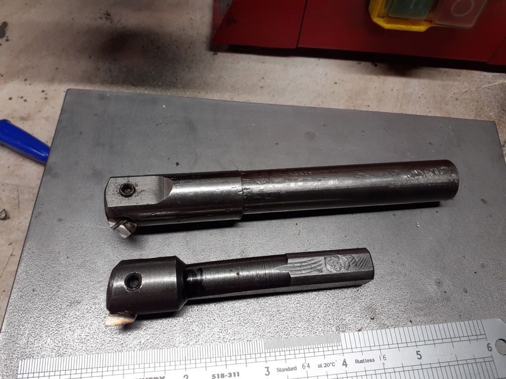

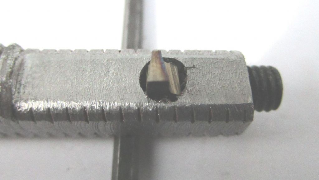

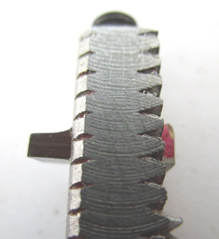

                      Hi Guys,

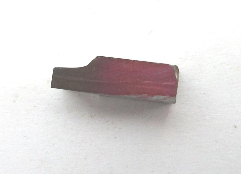

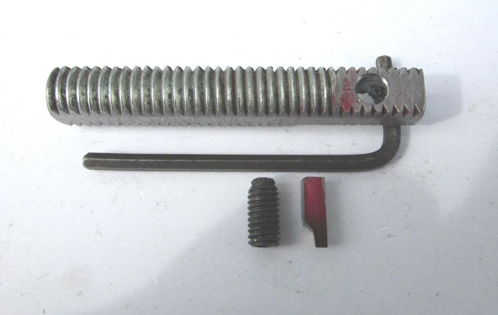

                      Here is a picture of a small boring bar that I made recently. It is designed to fit into a 12 mm bore in order to cut several 2 mm wide by 2 mm deep grooves.
                      This is a family picture of all the parts including the Allen key for the M5 grub screw.
                      This picture shows the assembled tool.
                      Looking down from the top. That piece of HSS tool steel is 3 mm square section by 10 mm long.
                      A close up of the tool bit.
                      I made this tool to machine the grooves in a labyrinth dust trap for a high speed grinding spindle.

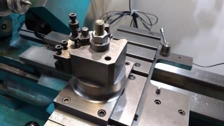

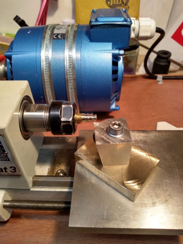

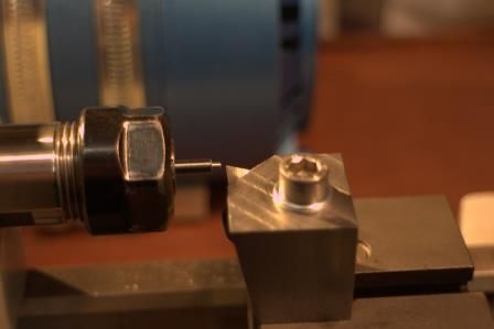

                          This is a tangential lathe tool holder I made for my Unimat.
                          This is it on its accesory base for hand turning a la "Turnado"
                          This is a replacement tool holder for my S7 to ensure rigidity and repeatable QCTP mounting.

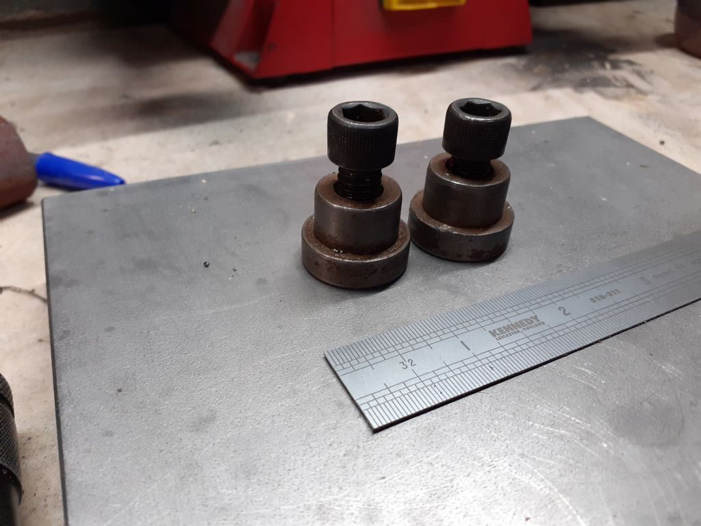

                          Jon Lawes
                            @jonlawes51698
                            What a great idea for a thread. I don't have a photo handy but my first big lathe tool project (I'm a novice) was a between centres boring bar for making my Britannia cylinder bores as parallel as I could. I'm sure it will come in useful for any other locomotives I make, but otherwise is probably destined to live in a draw!

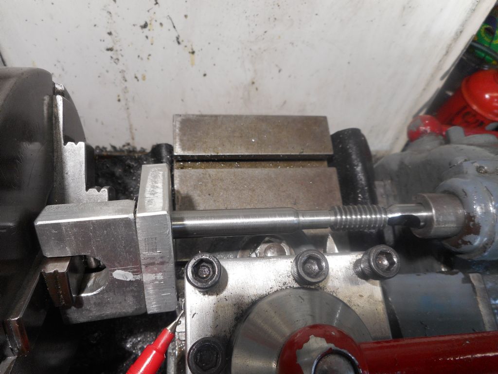

                            JC54
                              @jc54

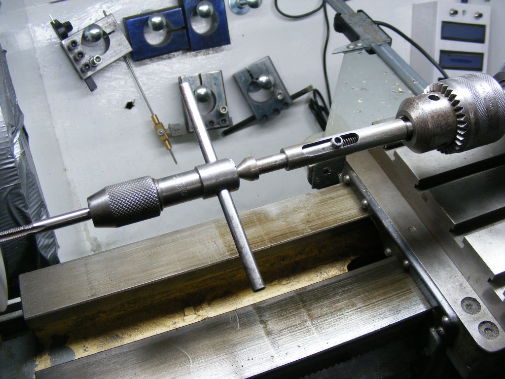

                              Easy to make and a good practice piece for us beginners. John

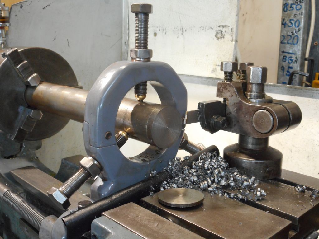

                              Hopper
                                @hopper
                                My homemade fixed steady and s previous owners rear toolpost dating back to the WW2 era.

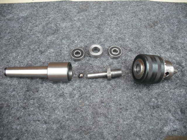

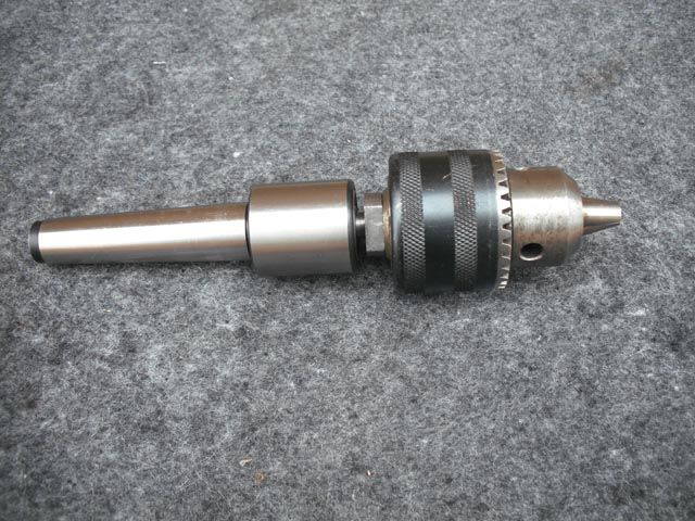

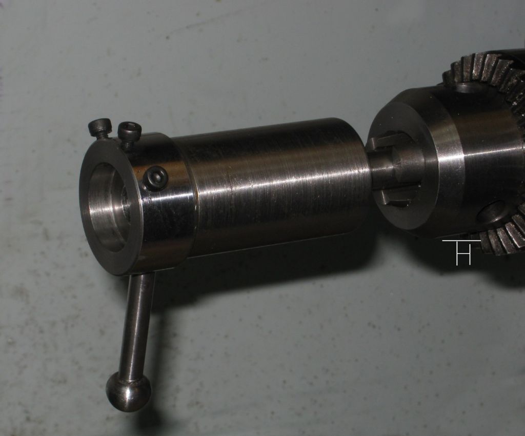

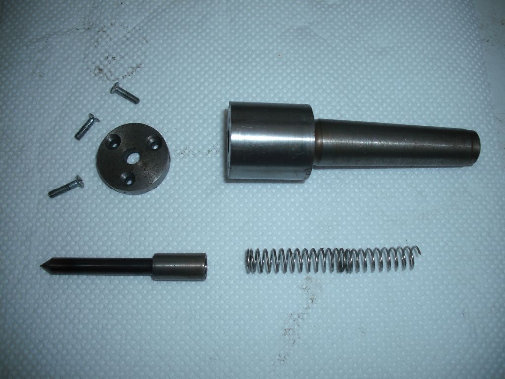

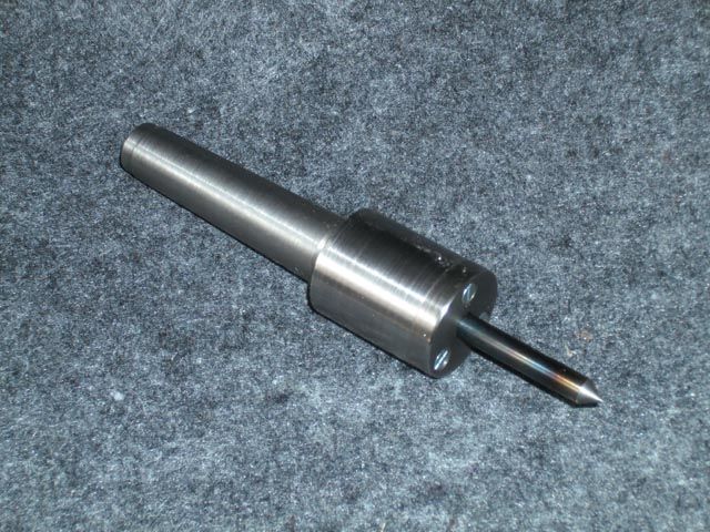

                                        Here's some tools I have made.

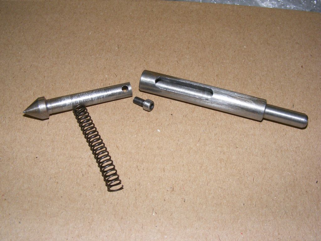

                                        Rotating tail stock chuck for supporting long thin bars or items not centre drilled.
                                        Here again, made from a blank morse taper.
                                        There is loads of stuff on this site and people are always posting links to other useful sites.

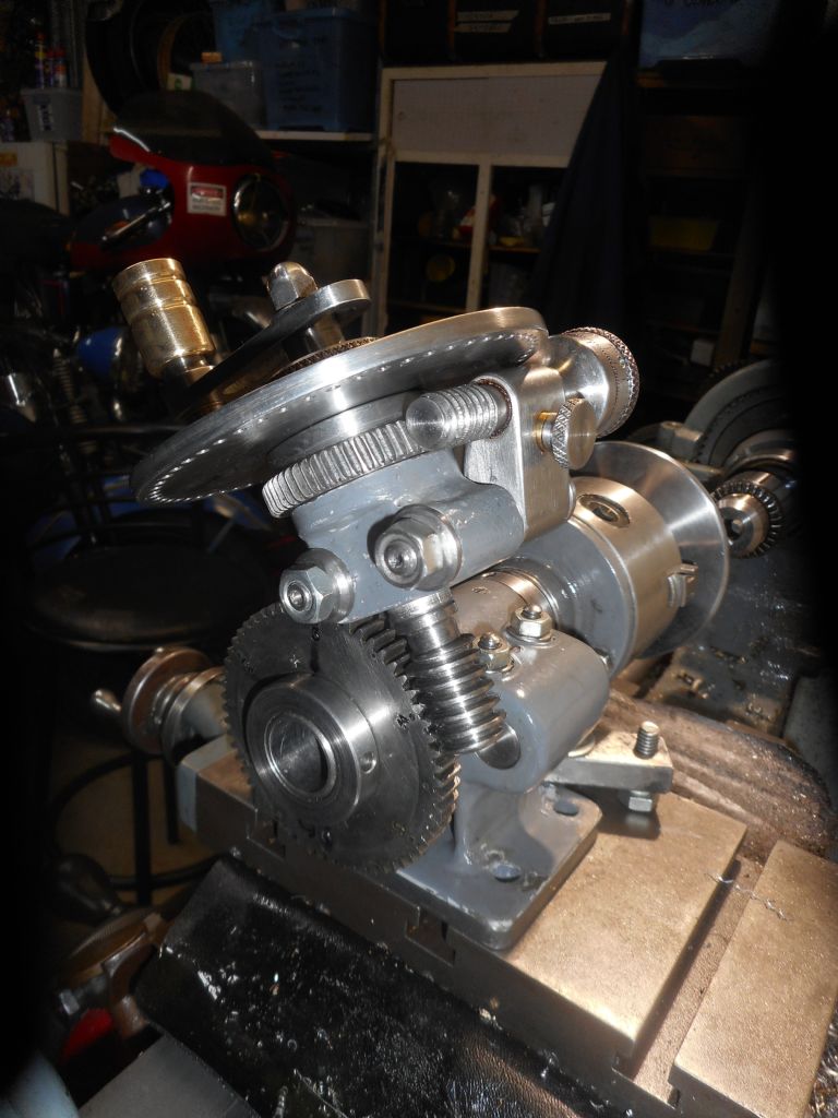

                                          Versatile Dividing Head, ala GH Thomas design but fabricated from steel bar and plate stock welded up. Shown here mounted on the lathe and being used to generate its own indexing plates. 812 holes in all. How could I ever forget?
                                          Edited By Hopper on 07/04/2020 08:16:43

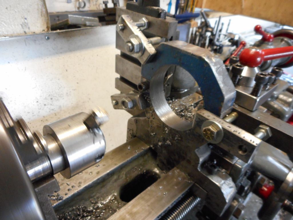

                                          #462904
                                          Hopper
                                            @hopper
                                            Homemade flycutter seen here boring the hole through middle of homemade fixed steady, which is clamped to homemade four-way toolpost. In the background can be seen the adapted Myford-style cross slide end bracket that allows extra cross slide movement inwards. Very handy on the old Drummond lathe for extra milling capacity.

                                            BOB BLACKSHAW 1
                                              @bobblackshaw1
                                              What size bearing would be best for the rotary tail stock chuck please as I can order the blank taper at the same time. All good ideas keep them coming.
                                              Bob
                                              Edited By BOB BLACKSHAW on 08/04/2020 14:46:06
                                              #463390
                                              Anthony Knights
                                                @anthonyknights16741
                                                HI there. For the one I made I just used a couple of bearings I had in the "might come in handy" box. I have just done a quick check with cheap digital calipers. Bearings are 22mmOD, on a 8mm shaft and about 7mm thick. Hope this helps.
