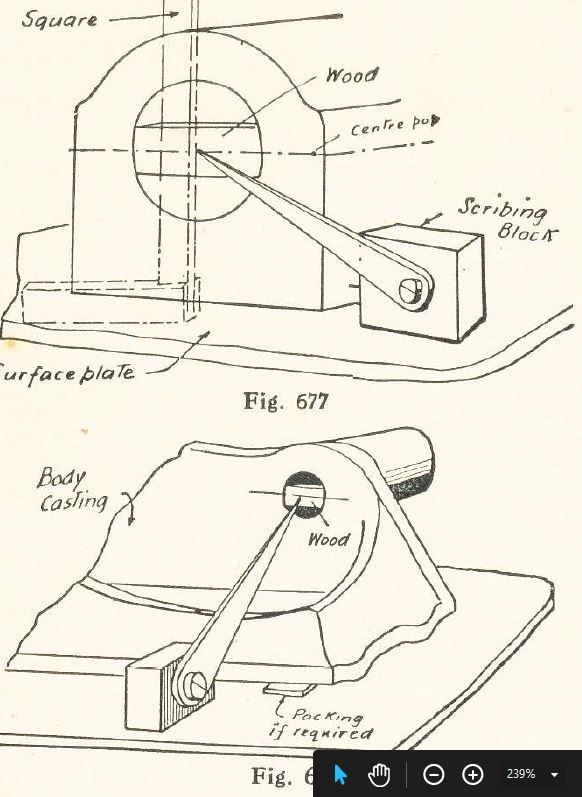

                                                #497380
                                                  I always work to full or bare rather than proud or shy fractionswink
                                                  Funny enough some one sent be an extract from a book yesterday dating from 1915, no digital height gauges then just a simple scribing block no doubt set from a rule.
                                                  #497381
