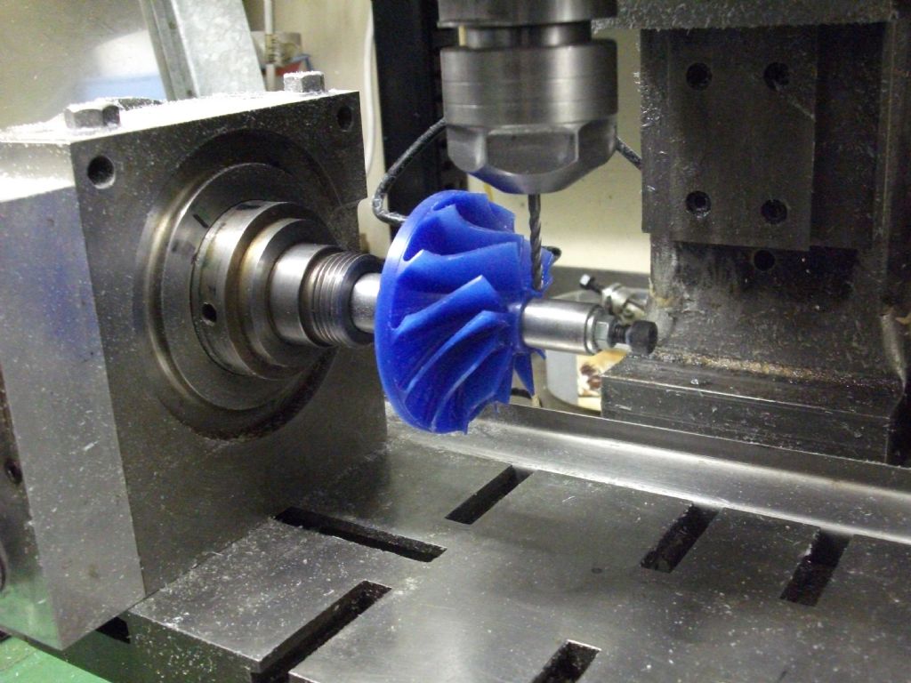

      Hi Chris
      I was given the cast wheels they are about 56 mm diameter about the
      same size used in the Wren 54 turbine engine.
      The wheel on the left is for a KJ 66 size turbine and was milled on the Dore Westbury
      cnc machine ,seen here was a test cut in wax.

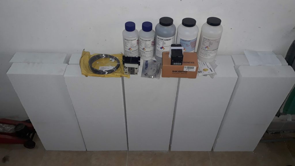

                  ChrisB
                    @chrisb35596
                    Of course you will not be using the cast aluminium for aircraft parts, I would imagine that's clear to all. That does not mean it does not have it's use tho, I normally use aluminium for ease of machining and where strength is not a critical requirement. I have a block of 7075T6 alloy which I use sparingly for special projects. Knowing how expensive the material is I don't want to waste it.
                    As for heat treating, if you have a pid controlled oven it would not be so difficult to do. Would definitely like to try it out.

                      #493436
                      ChrisB
                        @chrisb35596
                        Yes Jason, that would be similar in principle to what I had in mind and it looks like it works. There are some things I would do differently especially when it comes to electrical safety but the principle is the same.

                        I had already purchased all the material needed for the furnace quite a while ago to build a heat treat oven. They have sat there ever since collecting dust! A project for the coming winter, summer to unbearably hot here to be spending any length of time in the workshop
