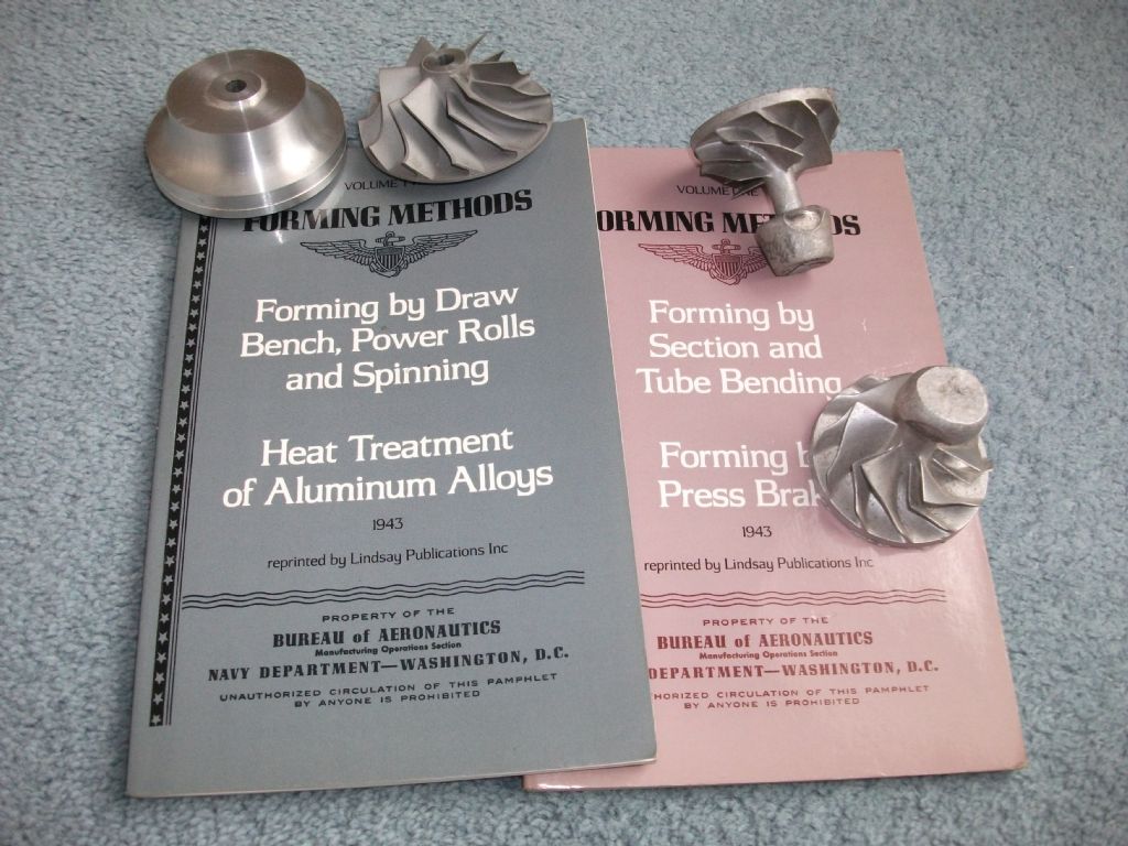

                                                John P
                                                  @johnp77052
                                                  Hi Chris
                                                  Melting these metals you will loose much of the strength of the original
                                                  alloy ,as you have found out there seems to be little information out there
                                                  on the heat treatment of aluminium.I found these two books from
                                                  Camden were most useful ,the book on the left has 35 pages
                                                  devoted to the treatment of aluminium and its alloys ,but just like the
                                                  casting will require a lot of time to make up some of the equipment
                                                  needed for this .The temperatures needed to do this vary according to
                                                  the copper content of the alloy and need careful control for the best results.
                                                  These books are still on their listing,the one on the left is the one that
                                                  you need.
                                                  It obviously can be done the 2 cast turbocharger rotors on the right are in
                                                  as cast condition and still have the test marks on the riser .For critical
                                                  components like this they are best made from a known alloy, the
                                                  milled compressor wheel on the left and the unmachined blank are
                                                  2014 t6 aluminium.

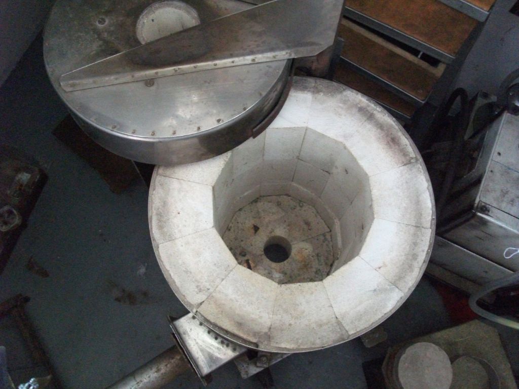

                                                  My own furnace seen here is a modified Gingery furnace use MPK
                                                  bricks built around 1990 , will hold an A8 crucible.

                                                    Are those compressor wheels your work John? Impressive!
                                                    I'm not after having the material properties in as purchased from the suppliers, I know that would be next to impossible to replicate. But if the alloy could be melted into useable bar stock at a considerable cost saving, then why not. For sure I would not use it for something like you're building!

                                                    Btw, what do you think of this Jason: https://www.metallab.net/ytongfurnace.php   He is using Ytong blocks for his ovens with good results if used lower temperatures.
                                                    Edited By ChrisB on 29/08/2020 12:10:36
                                                    #493337
                                                      While better than say a dense concrete block they will not perform as well as a vermiculite block or the "wool" mentioned earlier, I think we covered this on an old thread of yours.
                                                      However they are cheap, easily available and better than nothing so could be used to make up a simple furnace as in your link, if you are only doing a few heats a year then the extra bit of gas used would still be less than the cost of better blocks. If you find you start to do more billet casting or even get into casting parts then you can get better blocks for the MkII furnace. It could be a false economy to spend out a lot on making an efficient furnace that won't get much use as the money spent on it could go towards buying barstock.
