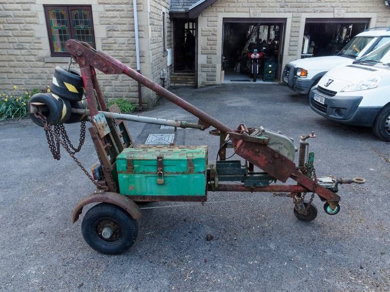

                                                  Hmm! been following this with interest and its got me wondering is this legislation retrospective ? That's to say I have an 8' x 4' home built trailer, built some 30 + years ago using a small modified caravan chassis as the base. I think the rating plate was around 14cwt ???
                                                  Should it be tested/approved since it was built before any of this legislation came into force.
                                                  It has served me well and carried many tons of material & a few machines, its been re-boarded several times and lighting, sides and strap anchor points etc upgraded. At the moment due for another refurb this winter – its very busy right now !
                                                  Comments please —- John

                                                    Legislation is not retrospective. However all trailer must be road legal and it's worth checking the small print on your insurance policy. Some insurers are limiting cover to commercial or approved trailers. A sigificant change (more wheels, different hitch etc) may trigger the need for a IVA.
                                                    Robert G8RPI.
