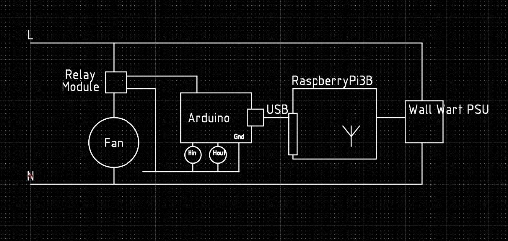

                I'd use an Arduino to control the motor and a Raspberry Pi to provide network Connectivity. The RaspberryPi series are real computers, compatible with home networks. The 3B has built-in wifi, but if this doesn't work from a cellar, they also have a physical port which could be plugged into an Ethernet over Mains adaptor. They can run headless, ie no need for a keyboard or screen.
                The Arduino Fan Controller part is rather simple: read the sensors, do some sums, and switch the fan. Also simple for the Arduino report status to the RaspberryPi and make it available over wifi.
                Rather harder to send commands to the Pi, and then control the Arduino. The problem isn't connectivity or computer capability, it's the need to decide exactly what control is required and how it should interact with the user. Then the design has to be implemented in software. Human Machine Interfaces are generally the most difficult and complex part of the job. Part of the problem is users are almost completely unable to specify what they want in advance. They don't understand sequences, events, error inputs, ergonomics, or the need to back out when mistakes are made. The programmer needs a specification and gets a load of vague waffle! The same users are excellent at pointing out what's wrong with what they asked for when they see the finished result! Anyway, this aspect of the design needs careful consideration, and may need a few prototype attempts. Not rocket-science but time-consuming, especially if the requirement is blurred at the outset.

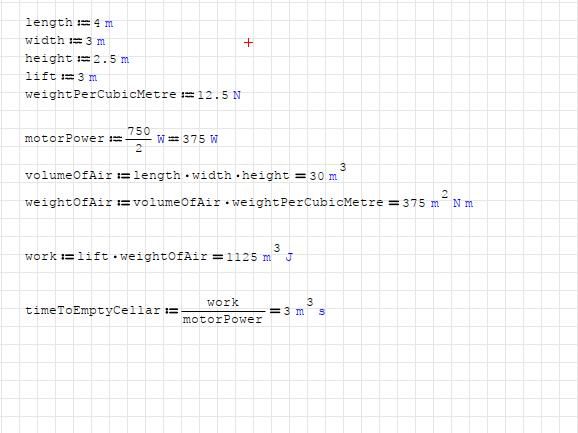

                          Head over the parapet time because I'm terrible at maths!
                          How long would it take a ½ HP motor to empty a 3 x 4 x 2.5 metre cellar assuming a lift of 3 metres at standard temperature and pressure?
                          This is my answer in SMath Studio. I tried to use Units with odd results (what's a m³s) but believe the numbers are right:
                          Three seconds assumes the fan is 100% efficient, runs at full speed instantly and that that the outlet isn't constricted. 15 seconds might be more reasonable in the real world.
                          Replacing the air in the cellar quickly is an advantage. The purpose is to remove moisture, so faster the better; a 35W fan would take ten times longer, more if the cellar is wetting the air continually.
                          On the other hand, 35W fans are quiet. A big fan firing up in the cellar at 4am might wake the neighbours!
                          Happy to be told the calculation is wrong, and what I did wrong with the units!

                                  It's certainly an alternative, not necessarily easier. Arduino Boards don't come with Ethernet or Wifi, but a shield like this or this could be plugged in and programmed. It's the 'and programmed' part that's the challenge. I accept someone versed in Arduino's Ethernet library who knew nothing about Linux might well find it easier to buy a shield, program it and cut out the Raspberry. Particularly effective approach if the interaction is very simple.
                                  RaspberryPi being a real computer means it supports Serial USB, Ethernet and Wifi at full throttle – all the tools and hardware are available. As such it makes a good bridge between the outside world and a microcontroller that only understands Serial I/O. Basically, the Raspberry does all the hard network stuff like DDNS and there's no significant limit to the size or complexity of the programs it can host.
                                  As an example, I'm using a Raspberry as a Bridge to my Arduino clock at the moment. A short script writes whatever the Arduino is sending via USB to a file (which could grow to 5 or 6 Gb). As the raspberry links automatically to my home network, I can log in and view the growing file at any time. I can copy it to another computer without interrupting the capture, stop and start the capture, process the file on the raspberry, check how big it is and anything else file related. Apart from the script all the software is standard functionality. I don't have to program anything, but could if I wanted. Unlike the Arduino, which is tiny, the Raspberry isn't going to run out of puff.

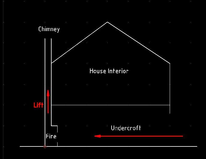

                                                I was assuming the space was a cellar and the air had to be lifted out. Less work done by the fan shifting air sideways from an under-croft, but the principle is the same: how much air will be shifted in a given time by a motor of a certain power. I don't think fresh air coming in alters the sums because the replacement air does no work.
                                                An equivalent way of ventilating the space is with a fire.
                                                The fire and chimney are a heat engine that lifts damp air up the chimney which is replaced by fresh-air at the undercroft's entrance. As the heat engine obeys the same physical laws as the electric fan it's possible to calculate how much fuel (energy) is needed to remove a volume of air in a given time. Incoming fresh air doesn't alter the amount of work done by the fire either. I hope!

                                                  smiley Dave, the incoming air does work against atmospheric pressure, which is in balance, so the outgoing air floats in the in-coming. Its more like moving a counter-weighted lift than moving the load on its own.
                                                  Its really a viscous flow problem, not a potential energy one. It would be interesting to know if your answer is anywhere near correct, it could make a good rule of thumb.
