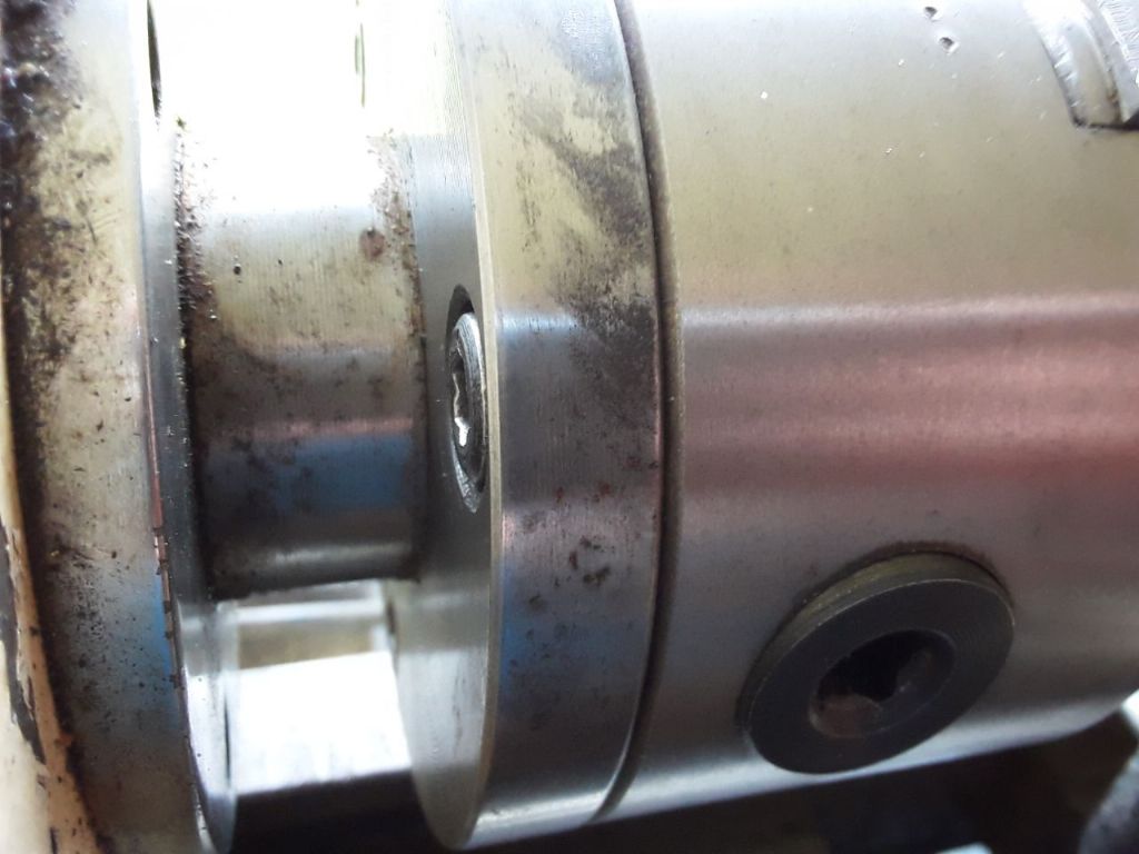

      Faceplates.. ..Just on the off-chance, you might as well give us the the spindle nose / flange dimensions.. ..even if nothing used turns up, you might at least find out if something new can still be obtained..?
      The chuck mounting is a bit of a pain.
      It's not a screw-on type, but has a mounting plate already on the end of the shaft.
      Changing chucks involves undoing three socket head screws with only a thin space to get in to them. Even the Allen key has to have a short end.
      BV20 chuck mount

        #562254
        Howard Lewis
          @howardlewis46836
          And I thought that you were going to make a faceplate for your lathe.
          If you find the the Allen screws are a PITA, why not make nuts with a reduced shank (to fit into the counterbores ) and use studs instead of the Allen screws.
          The choice of spanner to use, or the size of hexagon, is up to you.
          Howard.
          #562259
          The Real Ron Skingley
            @therealronskingley
            Well I could of course.
            But making a 'proper' faceplate would encounter the same problems with the size of chuck.
            Have to hold it somehow to turn the locating recess.
            Plenty of mods to make for the lathe, including your suggestion.
            But at the moment I just want to get this flywheel done.
            And I am saving for a better lathe, as this one is shall we say 'past it'.
