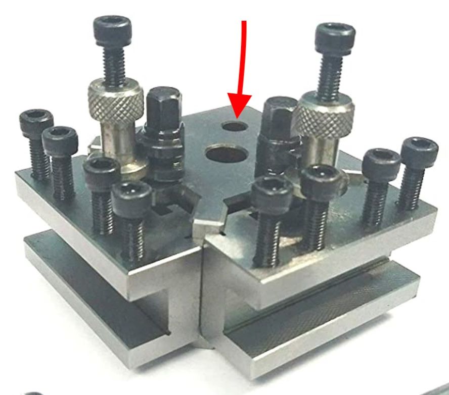

      Discovered I have a quick-change tool post.
      And it's got a purposeful looking hole in one corner.
      But no idea what it's for.
      And ideas please?
      (Now let's see if I can upload a pic).

          It's for a pin that locates in the compound slide, presumably to prevent the toolpost moving under load.

            "It's for a pin that locates in the compound slide, presumably to prevent the toolpost moving under load"
            Or possibly to lock it in a square position and not rotated.

              I've got exactly the same model ( RDG? ) and it doesn't align with the corresponding detent hole in my compound. To be fair, I think it is sold as ' for Myford and similar size machines ' maybe it does align on Myfords specifically? ( Mine's not a Myford ) I have always thought it might be an alignment hole for a pin when manufacturing?

                Unfortunately, from a practical angle, my topslide has a different dia. hole (bigger) that is square on to the centre post, on the chuck side.
                So it would have the tool post facing towards the tailstock at 45 degrees.
                But that's just my lathe (an ageing BV20).smiley

                  Ah yes, could well be a manufacturing alignment hole.
                  Anyone here have a lathe that it would align with?

                                On the original Dickson tool-posts, a hole was intended for an alignment pin.
                                The purpose of any ‘similar’ hole on a ‘clone’ is still open to question.
                                Ref: http://www.lathes.co.uk/latheparts/page13.html

                                  Ah yes, thanks. The Dickson one has the pin square-on which would make sense.

                                    Yes it's for a locking pin, and no there isn't normally a hole drilled for it on the topslide since lathe and toolpost are from separate suppliers. You have to drill your own hole in your topslide to fit..
                                    I gave up using the topslide on my Myford as it's tool flimsy and tapers are done with the CNC. I made a block to fit the cross slide to support the QCTP and drilled it for a dowel pin as I want to get precise re-registration of tools when removed/replaced – without a pin the TP will move if even a tiny bit, for example when parting.

                                            I will also look at making up perhaps a plate with a pin to engage the existing hole in the topslide, and a hole to take a pin from the toolpost.

                                                  The alignment of the toolpost matters most if you are using a parting off tool which must be at right angles to the spindle axis. For most home use having exact location is optional as long as the toolpost can be tightened securely.
                                                  John Haine's toolpost mod is the neatest and stiffest that I have seen, and it can be removed quickly if the compound is needed for a specific job.

                                                      The hole in question has often had a pin with a knurled end on some of the lathes I have encountered. If using it as a setting aid then the fit of the tool post to the fixing bolt will need to be checked.
