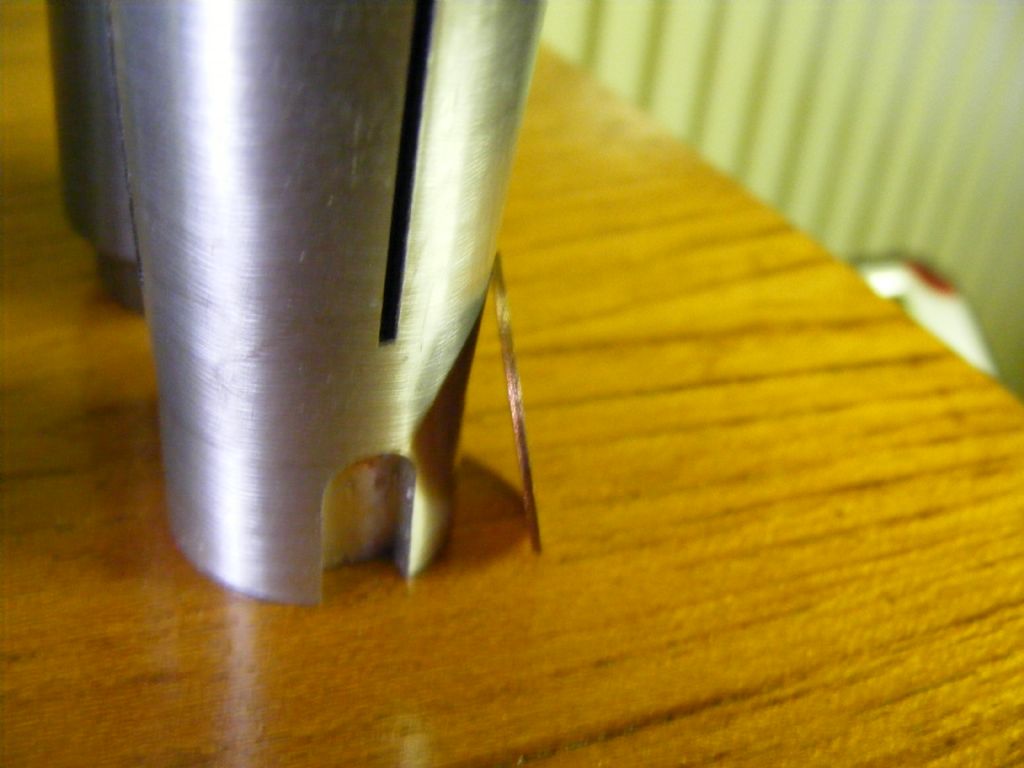

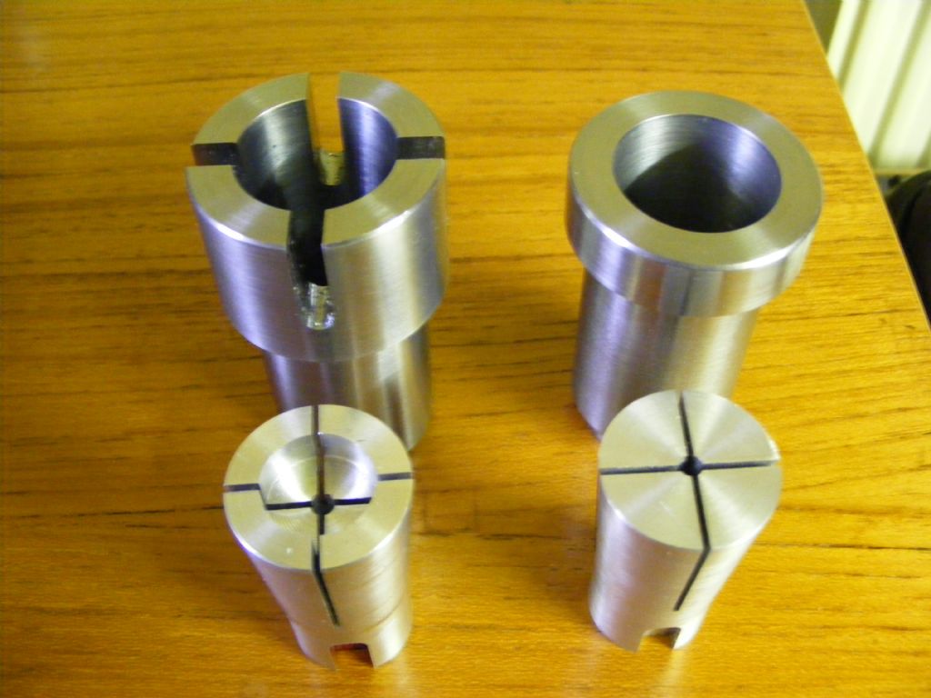

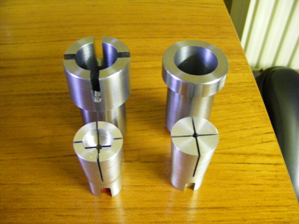

                      Have been doing some more "brain picking " Asked the brother if he had heard of B60 collets and he has used them many moons ago on a Weiler lathe. He says they are no use to me as they are a "dead length " system which means they don't alter the part position in the Z axis unlike a pull /push back collet such as the C series and the ER series
                      The B60's are installed hard up against the rear of the front face of their chuck and it is a tapered sleeve that pushes forward and so closes the collet with no movement in the Z axis. Sounded just fine for what I want, but they are no use to me… Why me asks, because they need air or hydraulics to work them, arrrgggh. All the B system are the same whatever the size. I should have twigged when I saw the front of the collet had a step
                      John S, would that be the same B60's as you mentioned ? either way sounded great until I heard about the air / hydraulic bit.sad. He reckons I should stick with the ER'S, but that aint going to happen, no way, no how.
                      I had a piece of 7075 Alum and decided to try and make some collets they have a slow pull back taper and to my surprise wok fine. Can remove a collet and replace it and repeats to within 0.01 mm so that is good enough for me So folks on here can give me their thoughts. As 1 of me tests I bored 1 out to take a 1p coin to see how short I could grip and got the 1p down to 0.43mm might have been able to shave a bit more off but that test was far shorter than anything I would ever need to hold.
                      I am also pondering whether to make a load of them in a bigger size [ maybe to accept up to 40/45 Ø ] and forget about the C16's any thought on that aspect ? All criticism welcomed as long as it's constructive smiley

                        Raymond would it be worth trying to make similar draw in collets that can be pulled into your existing ER chuck that way you would not have to change chucks, just remove the nut, insert home made collet and slip a draw bar up the end.
                        I'm assuming you are drawing them into the larger steel parts in your photo and then holding those in something.

                            Good point Jason I never even thought of that. Although I would ideally like to go up to a capacity of around 40/45 Ø You are correct in thinking the collets are pulled into the matching taper holder, the one with the 4 cut outs also match the taper and are used for the slitting. The actual collet holder is held in me ER 40 lathe chuck. It would just be a case of upping the dims to get the 40/45 Ø. Which would mean starting with around about 50 Ø stock. I could either dial in the holder in the Bison 4 jaw ind, or even use the soft jaws for the Bison 3 jaw. I am not concerned about the fact that they have a blind bore because they will only be used for short parts. These were only a "test " to see if it was feasible. I think I made around about a dozen of these blanks [ just used up the 7075 ] I actually enjoyed making them and would have no qualms of making up a load of blanks. ready for me to use when needed. I would actually do this, rather than faff around with those ******* plugs smiley.
