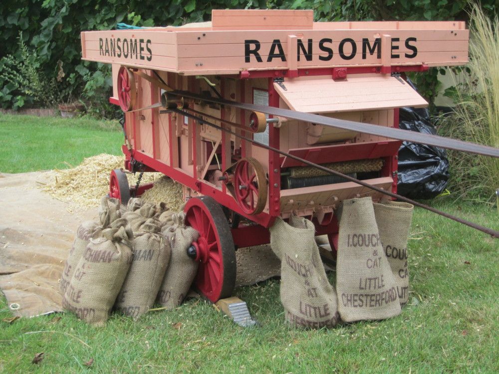

        And Ian has just come back and asked if I could post his reply:
        "This is a method that has worked well for me over many years. It gives convenience, speed of use, sufficient accuracy for most work & better access in restricted areas. If I'm taking heavy cuts or need maximum tool accuracy ( normally only when using a slot drill of the size of the slot I'm cutting ), I use an ER collect."
        And not only does the method of holding work well for Ian, so does the threshing drum, this is it in action recently.
