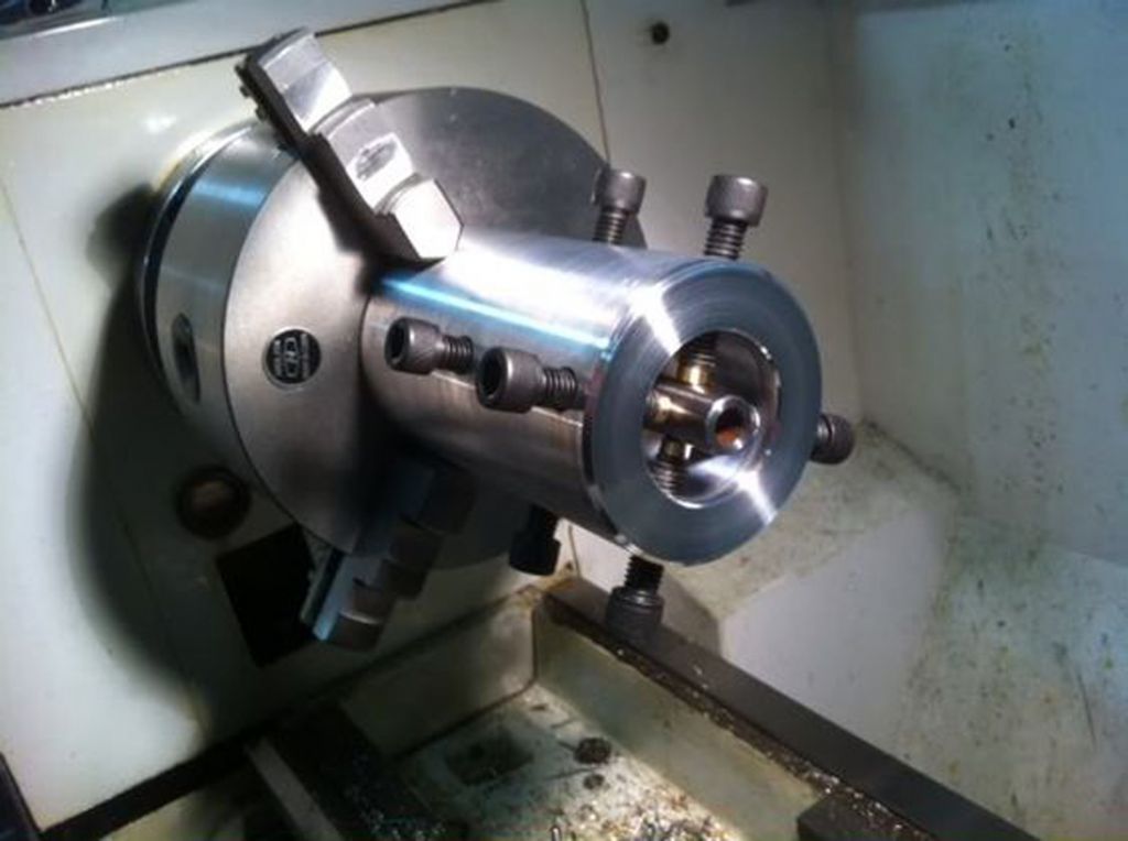

                  Make a lathe cathead. (also called a lathe spider) used to hold irregular shapes in a lathe

                      Cats head shown here in lathe chuck holding a gun barrel. It can also be used in a steady rest to turn a long piece of square or hex, etc
                      Simply made from a piece of pipe.
