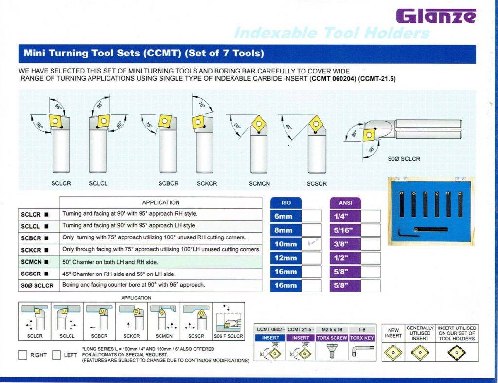

        I have quite a few CCMT/CCGT inserts which are worn or chipped on the 80 degree corners but pristine on the 100 degree. I can't find holders to use the 100 degree corners though – probably not using the right search terms. They must exist!
        Can anyone advise?
        Robin.

            Here is a link to APT Link
            If you google the tool code (SCBCRxxxx) you may find them on eBay.

              UK made and cheap..
              JB Tools
              #542203
                You can also get SClCL which is the left hand one for facing, I got both L & R from JB Tools.

                                              The Glanze holders I bought from Axminster came with this card:
                                              SCBCR and SCKCR use the 100 deg corner.
