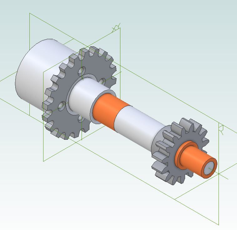

              Just dug out my drawings, finding the combined sprag clutch and chain sprocket is not going to be easy.
              If I were going to make the kick starter then I think I would make shaft #24 from 3/8" silver steel and reduce the end down to 1/4" to fit the small gear and bearing. On the other end a 3/8ID x 5/8 OD sprag clutch will run on the now 3/8" shaft. Fit the sprag clutch into a cup shaped housing with the end tapped with a ring of holes so that a sprocket with matching hole PCD can be screwed onto the end. If you are not sure of this shout and I'll sketch something out.
              This will in effect form a part like the one shown but with no need for the 1/4" shaft extension.
              Edit, the part in question is the second one down just in case anyone knows of a similar UK item
              Edited By JasonB on 24/08/2021 14:38:18

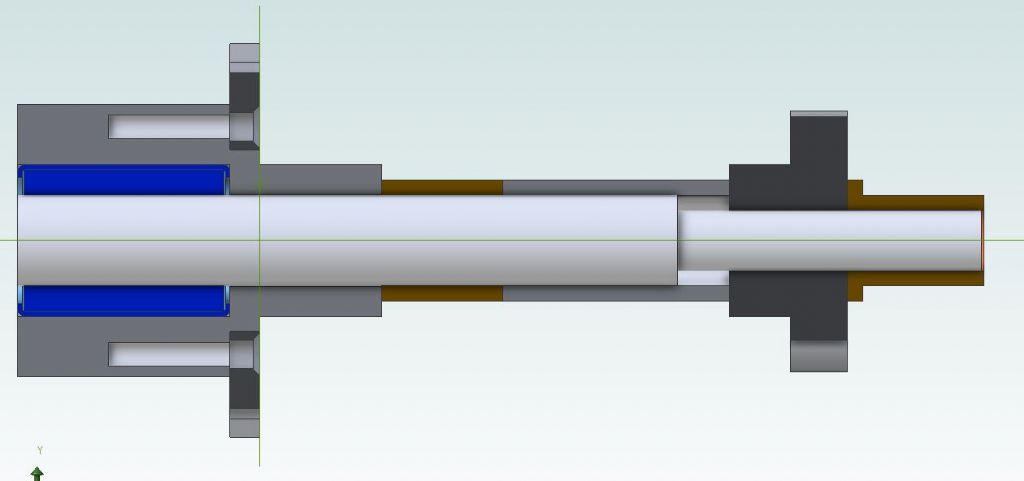

                    #559702
                      I think something like this should work. The bearings, spacer and gear sprocket are the same as original drawing. There is a new full length shaft, hub for the chain sprocket with sprag clutch inside and the sprocket itself screwed to the hub
                      #559732
                      Micky T
                        @mickyt
                        Thats great Jason I was having a little difficulty visualizing the remade part but its clear now. I still had the shaft as 2 parts in my head with the sprag clutch and sprocket attached to the second part on the left but its much simpler with the shaft as one piece probably stronger too.
                        Thanks once again for taking the time to explain it to me and definitely a better option than the bicycle free wheel sprocket that I had found.
                        Regards, MickyT
