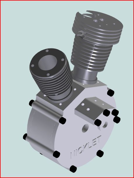

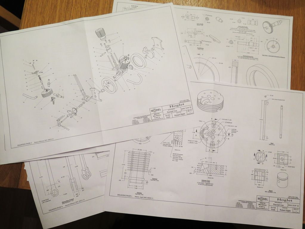

      Time for another engine build. smiley This will be my 3rd project and have decided to try my hand at an IC engine.
      With the assistance of another member I have chosen this the be a Hoglet V twin. This is very loosely based upon the Harley engine and has an open crank.
      So these are the drawings
      I will have a nosey at these for a couple of days and then proceed to start to butcher metal and increase the weight of my scarp bin. cheeky
      No postman with a heavy box on this one as it's of bar and plate construction.
      Nick

          Better hurry up and get my one finished before you beat me to it.

              If you do that then make sure you don't end up with the flywheels in the scrap box that bronze is not cheap.
              Talking of which I used hollow bronze as there is no point in paying for the bit in the middle.
              Have you thought of ignition yet? S/S do a nice little twin coil setup for the Hoglet
              Edited By JasonB on 24/02/2016 20:35:14

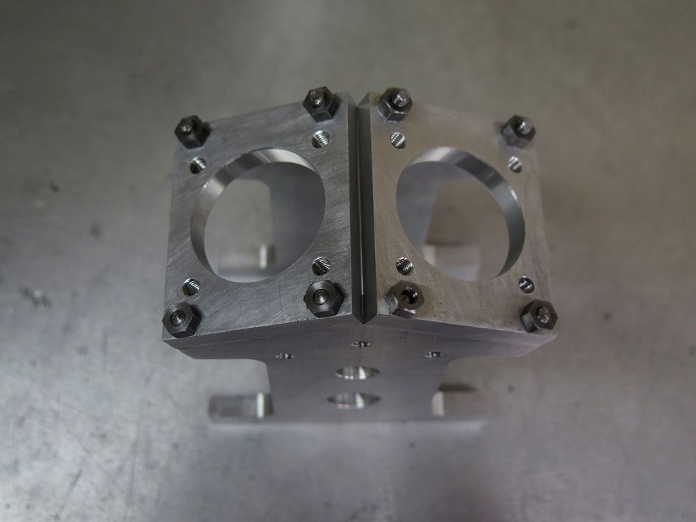

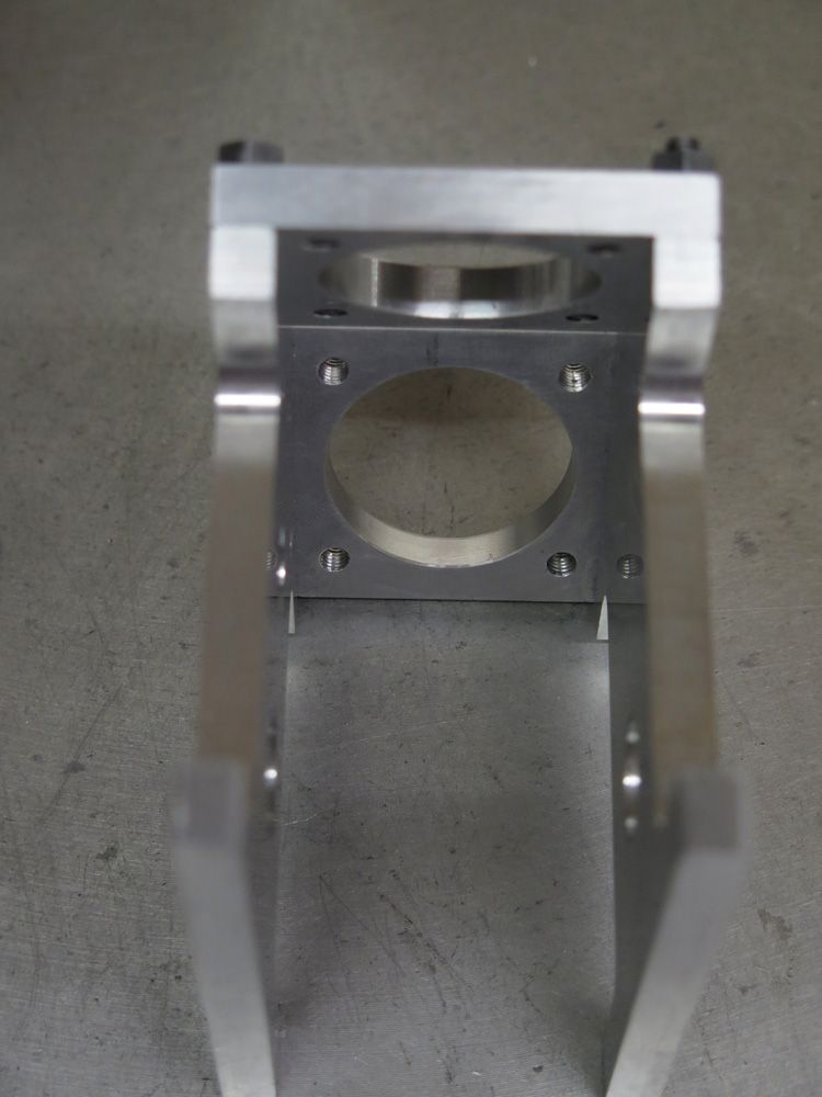

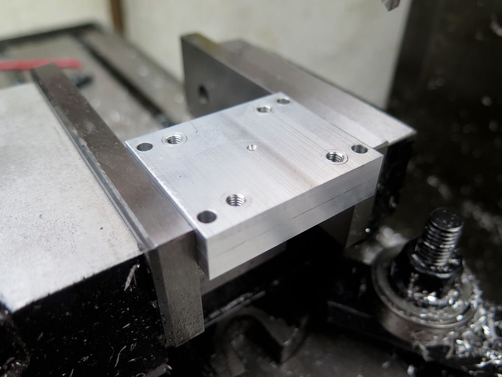

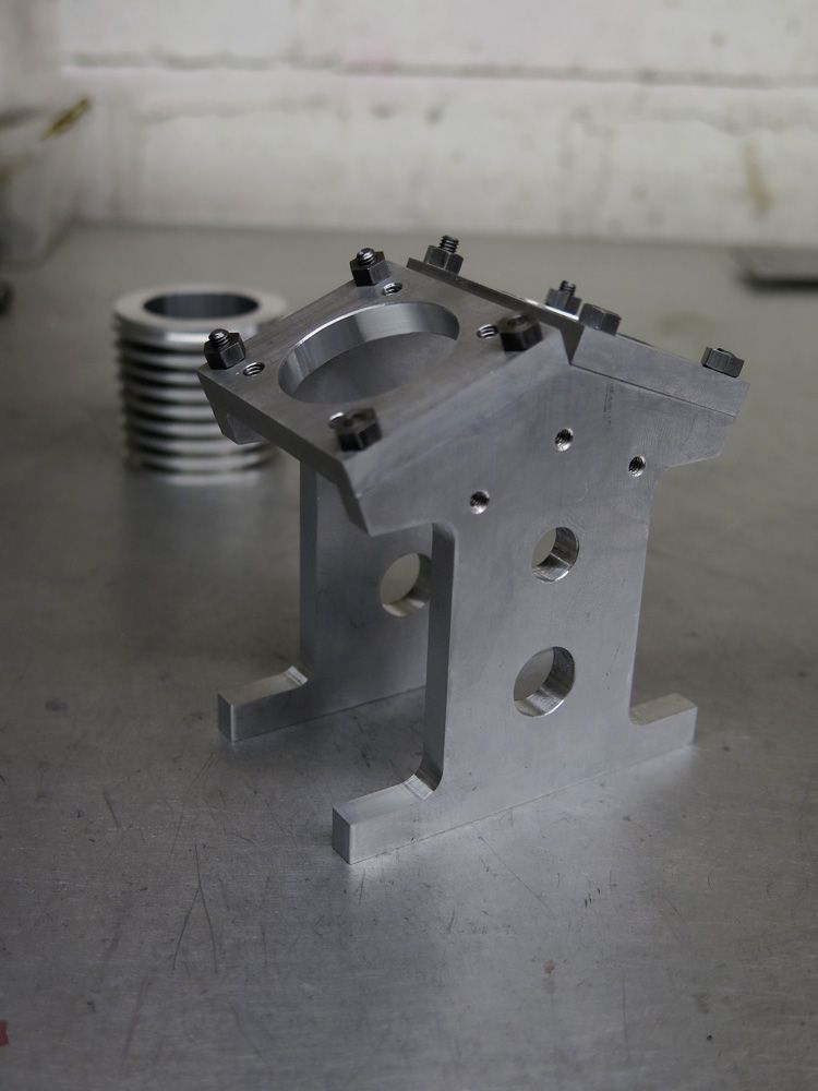

                                            I had some 1/4" plate delivered so into attack mode.
                                            I made the crankcase halves as a pair and tacked together with super glue so that I could be sure they matched and separated later. This of course means that if you drop a clanger you butcher twice as much metal for the bin. – This was my second try.! blush Fortunately I had ordered more metal than I needed.

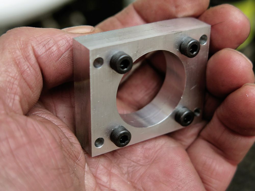

                                            The crankcase tops were also made as a pair.

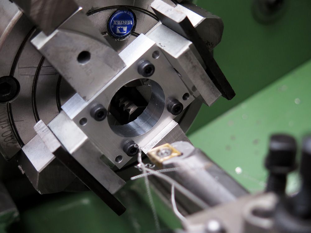

                                            I aided the superglue bond with threads to make sure they did not separate in the lathe 4 jaw while I bored out the hole that the cylinder liner will sit into.
                                            Golly.!!!! …… They all fit. smiley
                                            The studs are just temp until the cap head screws arrive. Having said that I think I prefer the look of studs (if they are all the correct length) and nuts over cap head screws. – Opinions please.?
                                            All seems true with it on the surface table. I was also surprised how rigid it was when fixed together. However I think that sooner rather than later I will make a temp base to support the bottom and stop it getting twisted during construction stages. …………. Me being ham fisted un-all. wink
                                            Nick

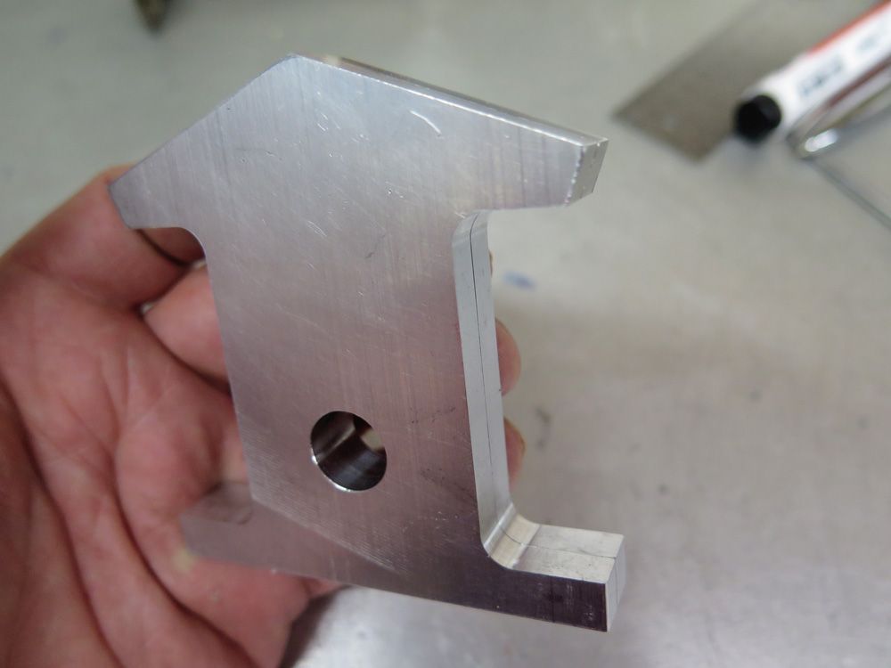

                                              Off to a good start Nick even if you did take the easy route and not do the angle cut on the crankcase tops but I won't tell anyonesecret
                                              I have used M4 button heads on mine, Assume you have converted to metric fixings too?
                                              Are you going to use the oilite bushes suggested on the drawings or just turn your own from bronze?
                                              J
                                              #228535
                                              Nick_G
                                                @nick_g
                                                Morning Jason. smiley
                                                Yes I did take the easy route with those tops. I figured that it's the sort of thing that has to match spot on or not at all.! ………. I did not have enough faith for myself to pull off the former. So I cheated and did them like lots of others have.. blush
                                                The threads will be some metric but mostly BA ones.
                                                I figured that I would turn my own bushes from bronze unless there is a good reason not to.?
                                                Nick
                                                #228537
                                                  I turned my own too. For the amount of running its likely to get the extra oil holding ability of the oilite won't matter.
                                                  If you are going to use cap heads then make sure you can get them in BA sizes before you start tapping as ones like 5BA are hard to find
