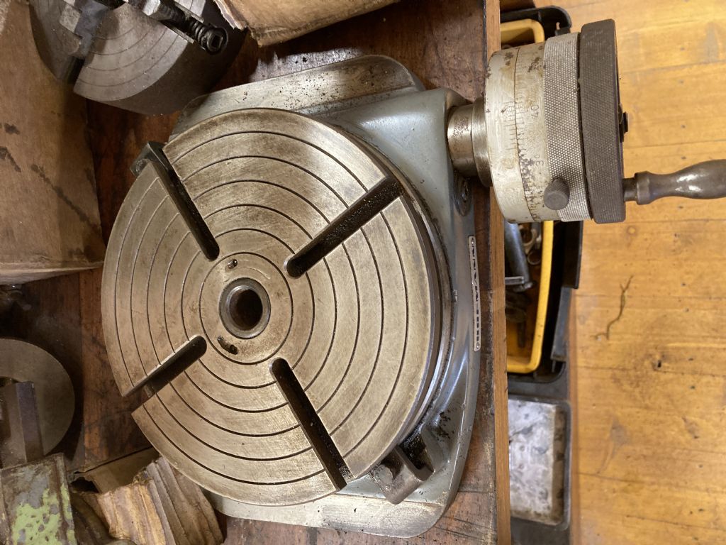

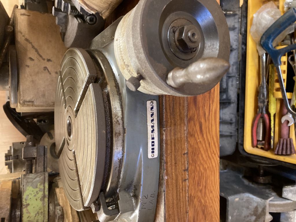

                00a19eba-20e6-41d7-a153-c8a1f3253275.jpeg76525e3f-5ea0-452d-920f-a802efeebbd5.jpegHi All,
                I have a few Hofmann rotary tables that are potentially going to go up for sale. We are just doing a bit of research into their value at the moment if anyone can help?
                Thanks
