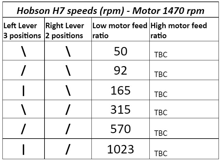

                    Hi all,
                    Just joined the group as I'm also a proud owner of the Hobson H7.
                    I did a speed test using a cheap £10 lazer rpm meter. Not sure how accurate these are? Results as follows.
