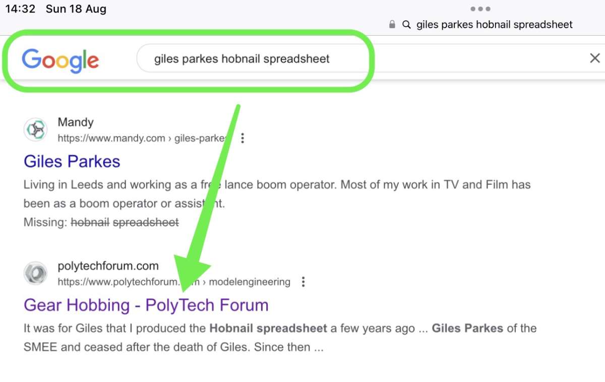

      The late John Stevenson distributed this excel spreadsheet software “Hobnail” free to those interested. Originally built by Gary Evams (does not seem active on the forum), it takes inputs of which change gears you have and spits out the required gear train for the job. I am wondering if anyone has it and would they be kind enough to send me a copy. I have messaged Gary but no answer. Many thanks for any help. Adam

          Thanks! I will check those out. John Stevenson referred to the Hobnail in his John F’s Workshop – Making Helical Gears.
