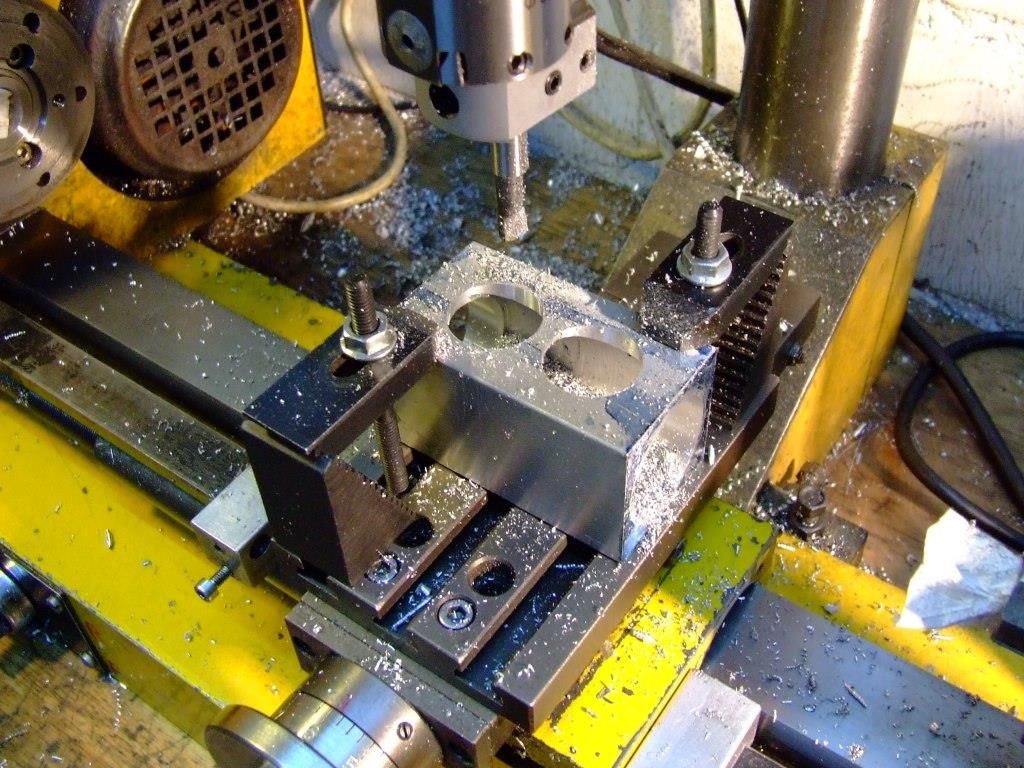

          Roger B
            @rogerb61624
            A Hobbymat milling table does exist and appears sometimes on Ebay. The one in my picture is a Unimat one in which I drilled new fixing holes to match the Hobbymat cross slide.

              Roger B
                @rogerb61624
                The T slotted table is only fitted for milling. I the picture above it is just resting on the cross slide (the picture was taken to explain to Teco what I had and what parts of the milling head I needed to order).
                Milling table in use

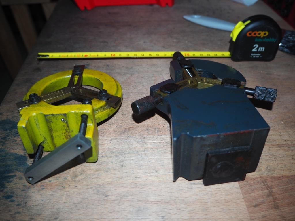

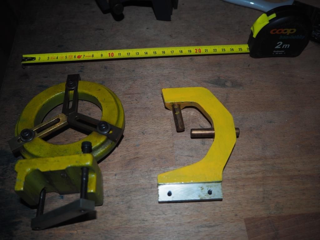

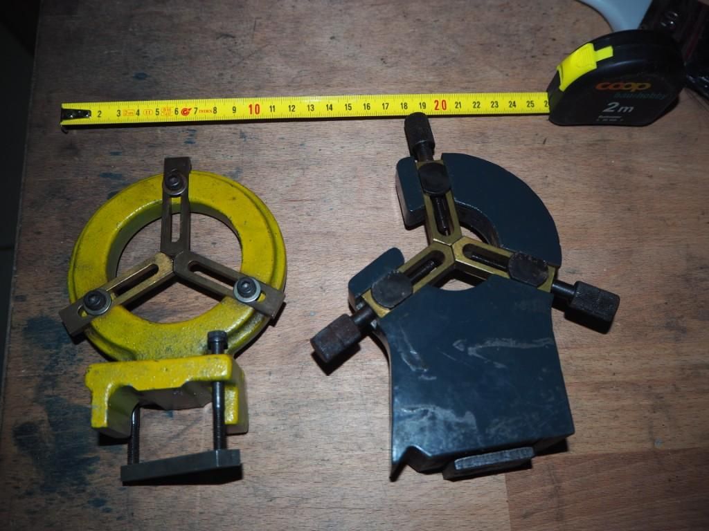

                      I have found the box with the lathe accessories in so here are a couple of pictures of the Hobbymat fixed steady compared to a Minilathe fixed steady.
                      The Minilathe steady won't accept a 50mm bar whereas 60mm fits easily in the Hobbymat one.
                      Finally a picture of the Hobbymat fixed and travelling steadies. There are tapped holes in the carriage for the travelling steady.

                      DiogenesII
                        @diogenesii
                        Roger, Many thanks for the extra views of the steadies – handy to see the base of the Prazi one.
                        The minilathe one certainly has a more substantial Body-Mass Index – it looks like there's enough "meat" in the base to make for a substantial mounting for the Hobbymat, if one had the means to cut to shape.. what's it made of?
                        The "traveller" is strikingly similar to the MESAS fixed steady in terms of the casting shape and the "coppery-looking" bronze(?) pins..

                        Roger B
                          @rogerb61624
                          Both the fixed steadies seem to be Cast Iron. I think that the Minilathe one could be modified but for my purposes a bore of less than 50mm would not work.
                          As you can tell by the discolouration I make quite a lot of use of the fixed steady very little of the travelling steady.

                          Gene Pavlovsky
                            @genepavlovsky
                            It's almost as if the steadies were hand-painted with a brush.
                            They do look useful! It's interesting how the fixed steady's design was not made to follow the D-shape of the bed.
                            The user-made steadies seem to put much more effort to copy the D-shape (even if it's just a U-bolt grabbing the bottom), but perhaps that is really unnecessary, as your steady proves?
