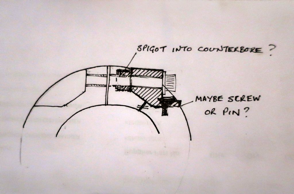

          Part 6 appears to be the precision sleeve that the quill runs in & the part that has broken off is the quill clamp.
          Looks like it is a cast iron part that has done with flexing to clamp the quill – worn to the point that it had to be over-tightened to clamp adequately. Not much left to try to re-attach the broken bit, so probably requires a new part either purchasing or making (reverse engineer the part).

            Maybe you could try a shaped block to fit into the three-sided recess to bridge the crack – see the photo's below – hopefully the sketch will be clear to you.
            If you can make a spigot that will fit into the counterbore, and add a small countersunk screw or pin beneath the head of the new lock screw, and bond the thing in with epoxy resin you might be able to repair it sufficiently to keep the machine working gently until you can find a replacement – the acetal gear trains in the later heads all seem to fail eventually, maybe a call around used machinery dealers will turn a 'dead' mill head up for you.
            Good luck..
