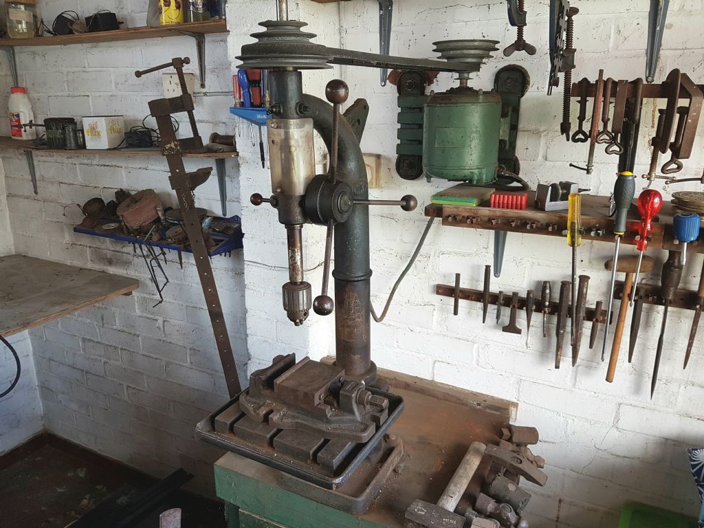

                                        Dan Reavey
                                          @danreavey17846
                                          Yes, possibly a floor mounted drill. Saw one briefly in MachineMart the other day. Looked good value.
                                          My old pillar drill:

                                                #548493
                                                  Posted by Dan Reavey on 06/06/2021 09:21:06:
                                                  Plenty of options but a general purpose pillar drill would be useful. Possibly bench mounted so not losing storage space underneath.
                                                  Sorry, Dan … I’m struggling with the logic
                                                  [please correct me if I am missing something significant]
                                                  You appear to have a very robust old drill already
                                                  I would be interested to see just how good it could become if you threw £250 at refurbishing it.
                                                  #548500
                                                  Grindstone Cowboy
                                                    @grindstonecowboy
                                                    I think you missed the part where he had to sell it when he moved house yes
                                                    Regards, Rob
                                                    Edited By Grindstone Cowboy on 06/06/2021 09:59:45
