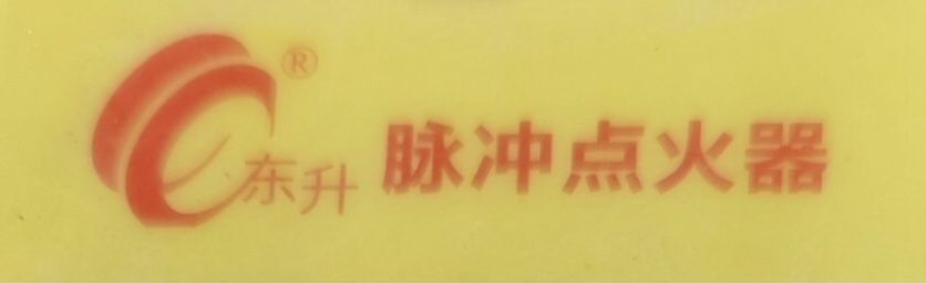

      #654054
        Posted by Blue Heeler on 28/07/2023 00:38:36:
        Posted by Michael Gilligan on 27/07/2023 07:06:57:
        Thanks for the photos yes
        The basic spec is [usefully] already translated
        … but now we know that it’s a
        Dongsheng pulse igniter
        and can start searching for more info.
        MichaelG

            #654069
              As you have already ‘emailed the company’ … I guess it was unnecessary to translate this:
              but I’ve posted it here in case anyone feels like trying an ‘image search’
              … Google didn’t get far with: Dongsheng pulse igniter
