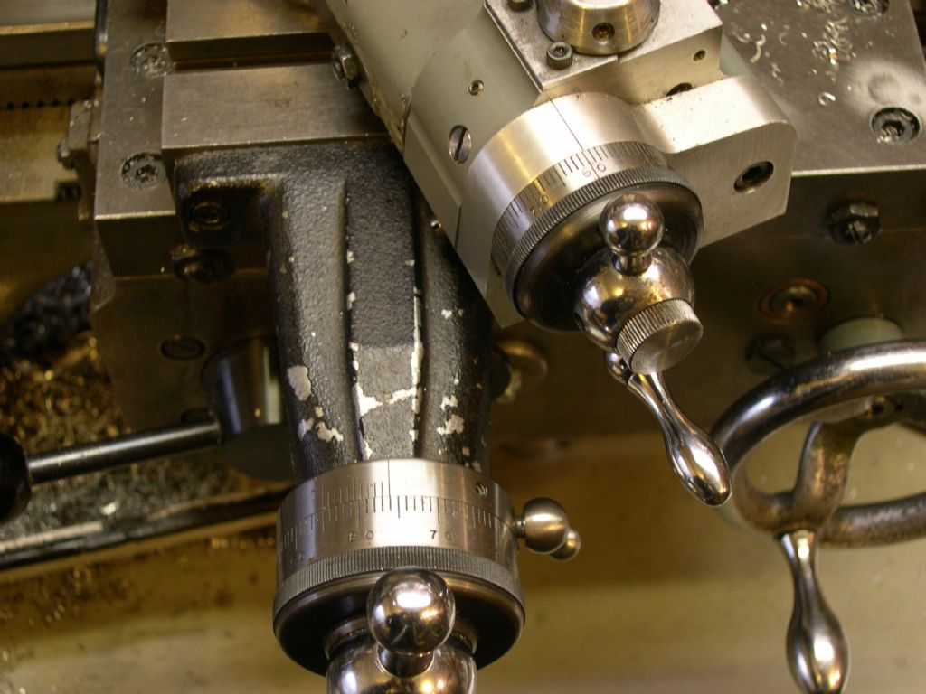

      Hi Everybody,
      What is the best method of highlighting index marks on lathe dials, steel rules etc?
      Have tried paint, felt tip pens and Typex but without much success.
      Thanks and regards.
      Len

                    Len
                    I do the same as Martin, use steel blackening liquid, in my case cold gun black. After scribing the lines and punching the numbers I use a fine file (#6 cut) to remove most of the raised material then after a good cleaning with a solvent use the gun black, working it well into the depressions of the lines and numerals. Once satisfied I use the file with the part rotating in the lathe to remove the remaining raised material and the black on the smooth surfaces. I initial tried skimming the surface as Martin does, but found invariably some of the lines or numbers disappeared, so now just use the file and find it works better. I have done many this way and find they hold up very well. dscn3394.jpg
