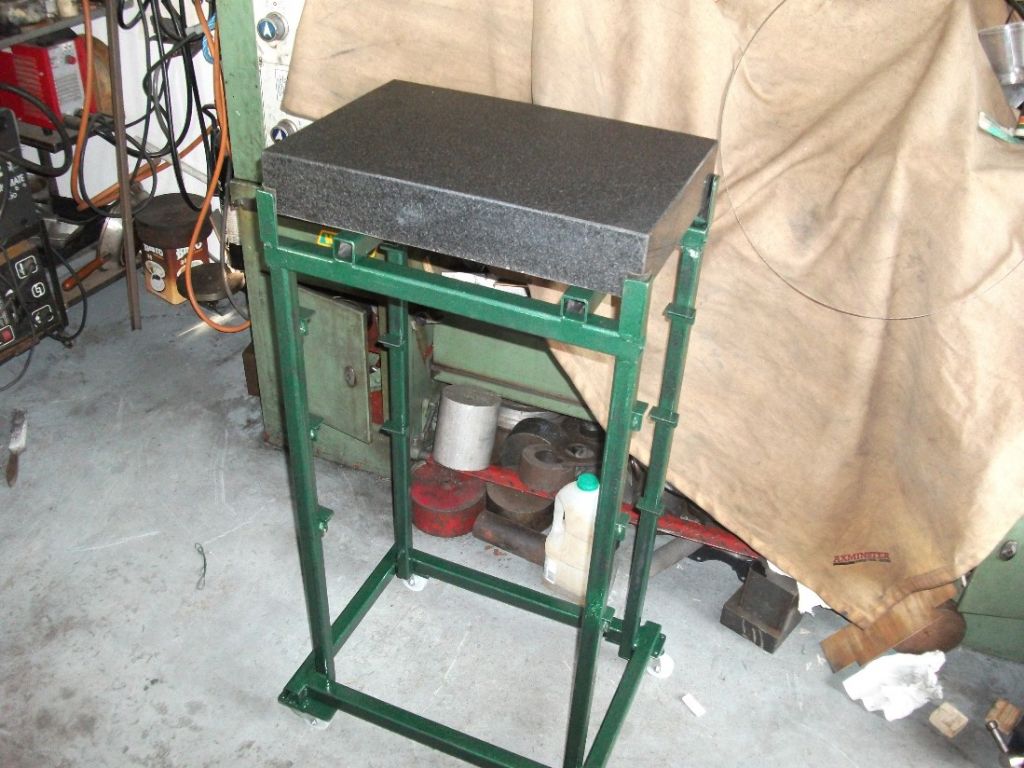

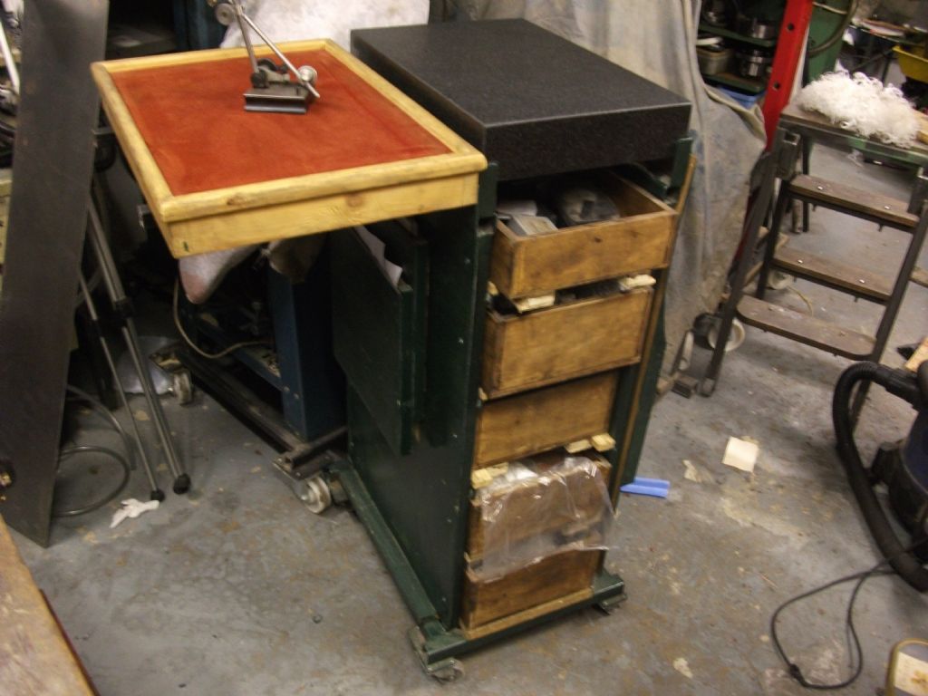

            John P
              @johnp77052
              I have my surface plate mounted on a movable trolley made from
              square steel tube,the height above the floor is about 36 inches
              which suits me.No problems with stability .
              A couple of loose pieces of square tube allows the cover to sit
              alongside the plate as a temporary storage for parts etc.
              The space underneath has 5 plywood draws for storage,when
              not in use the top is fitted back on and the tubes are stored
              inside the long top top tube of the stand.
              The plate is 12 x 18 inch.

                            John P
                              @johnp77052
                              Posted by Howard Lewis 28/07/2020 21:15:43
                              I made, if that is the right word, a granite surface plate for The WaterWorks Museum.
                              It was "floated" on a bed of wet plaster, on a sturdy (2" angle iron) frame, fitted with
                              levelling screws. In place on its bespoke stand, the table was levelled in both planes
                              before use. The stand is not moved around, but kept in one place. It is also kept
                              covered when not in use.
                              My surface plate is never moved.
                              Refering to the FAQ , question 12 on the site below
                              Mounting surface plates in the way described above is not recommended
                              The also point out that levelling is not necessary ,i suppose they would know .
                              Probably the reason the plate should not be stored in any other way
                              than on these three points.
                              https://www.starrett.com/precision-granite/precision-granite-faq
                              My own stand seen here in an earlier photo is mounted on the
                              three indicated marks on the underside,the mounting points
                              are on the two cross bars the four uprights at the corners
                              are a safety to prevent the plate from moving out of position
                              but do not touch the plate.
