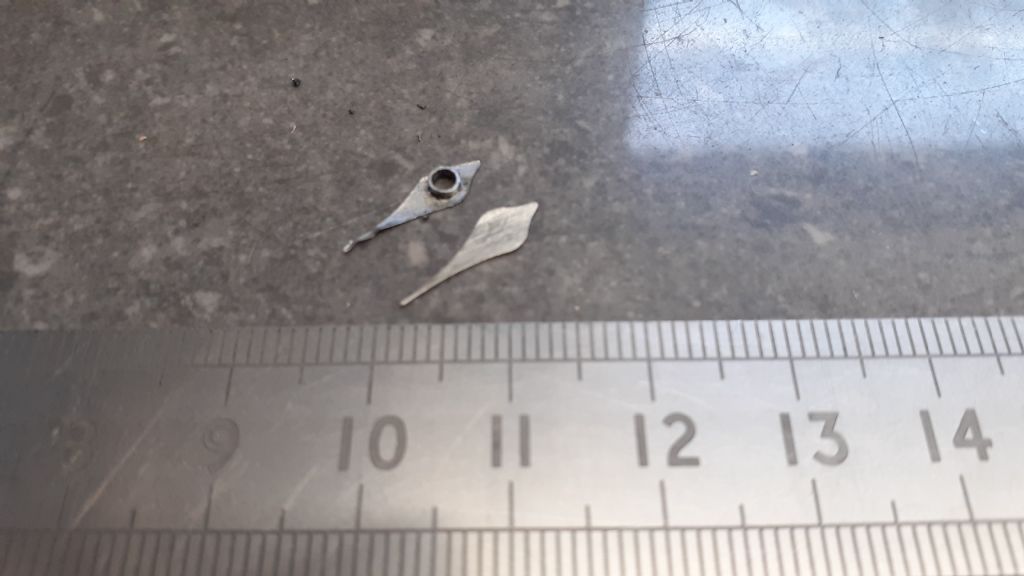

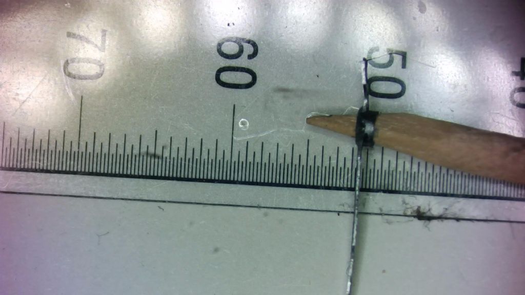

          Well, I'm getting a bit closer to my objective (though no longer 'high speed milling&#39.
          The latest attempt used an HSS 2 flute 4mm cutter at 2200 rpm, superglue, but this time to a flat fixture (no grooves) and a lighter DOC (0.10 / 0.15mm).
          The result is this
          The thickness has gone quite well (within about 0.02mm of 0.24mm across the part) and the pipe has come out better than expected.
          However, the width has not done so well, being off centre (ignore the obvious gouge at the bottom left – I turned the handle the wrong way, you think I'd learn after a decade or so of playing with these things). It's possible that I was a bit too aggressive in the trimming, or that one side was climb and one normal.
          The part has lifted off the fixture, but not until the trimming / drilling. the drilling certainly lifted the part as the drill broke through. I think I can fix that by having a clamp with a 3mm hole applied before the drilling.
          I might have another try with smaller cuts for the trimming and a consistent direction of cut. Failing that cut to an outline and finish with piercing saw and files.

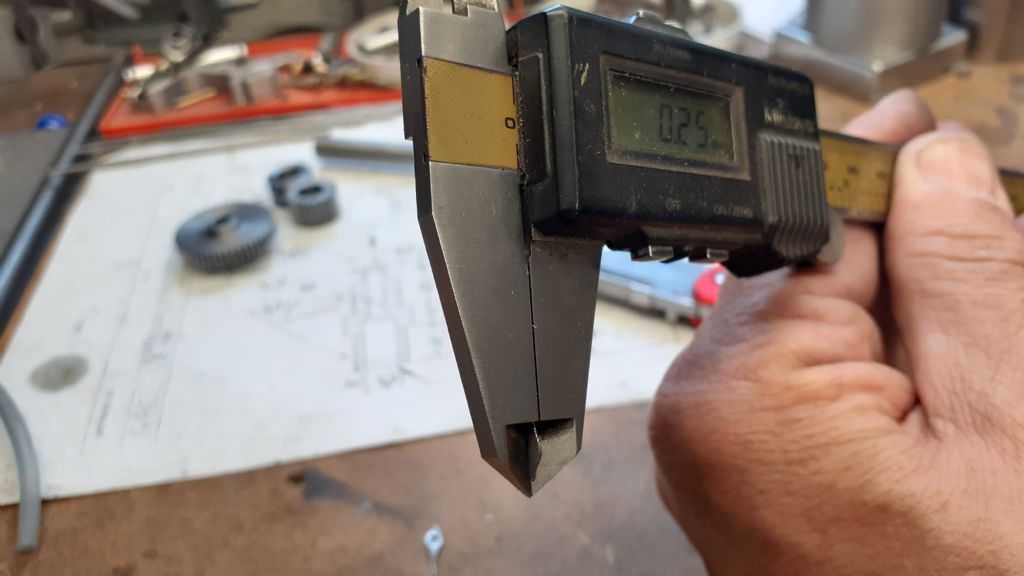

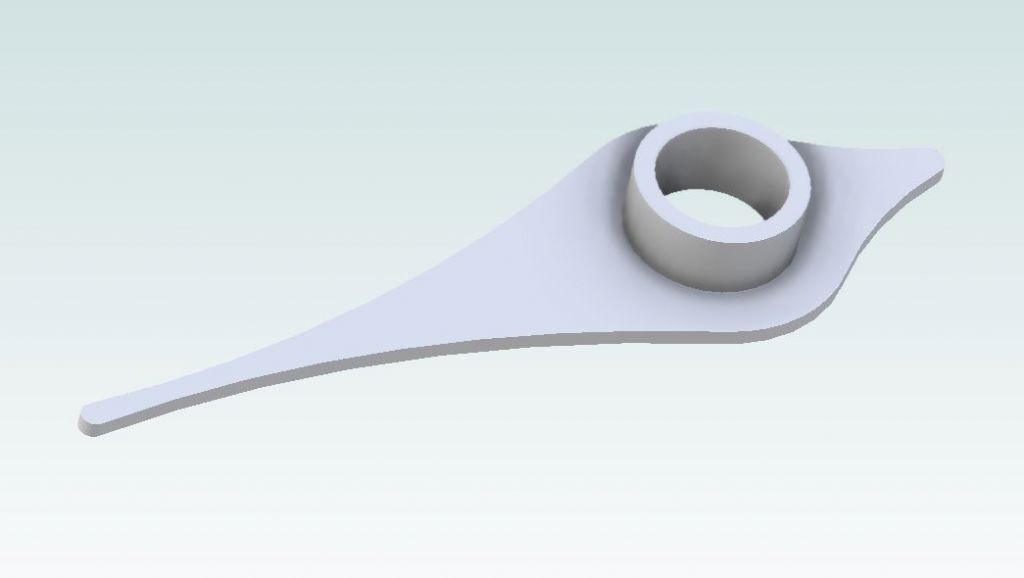

              I thought I would have a go at the "start with something solid and saw it off" method. Not having any flat carbon steel stock I opted to use some silver steel and drew out a rough watch hand to similar sizes mentioned in the thread. Boss is 2.5mm dia x 0.75mm high and the hand is 0.25mm thick and sized to come out of a piece of 5/8" SS.
              Having something solid to start with means you can take decent size cuts with a reasonable size cutter that is unlikely to break. Although I used the CNC similar could be done on a manual mill or even as mentioned above turn and bore the boss on the lathe and then mill the profile of the hand. Cutting parameters in the description below the video on Youtube
              I mucked up the height on the first attempt at sawing off the hand and ended up with a poorly shaped one of 0.03mm thickblush
              Luckily there was enough of the profile to have another go and this one came out 0.25mm as it should.

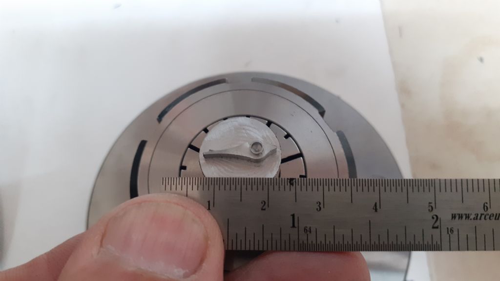

                #654597
                Iain Downs
                  @iaindowns78295
                  I've tried your method, Jason, and have made some progress.
                  Essentially, set up is as above, but with a 20mm silver steel bar in a (new chinese) toolmakers vice on the rotary table. And all manual…
                  Broadly, this worked well, but when I came to cut off the hand, the hand curled up like a little snail. In earlier messing around on the whole bar I found I could reduce this buy keeping it cool and taking it slow. Not so with this little hand.
                  It's not really uncurlable to dead flat (at least I don't know how). Uncurling results in a rather lumpy affair. My next attempt will probably include placing some kind of fixture on top of it to keep it in place, though I'm not entirely clear, yet, on how that will work.

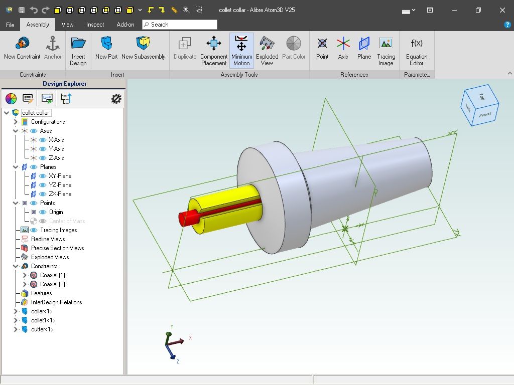

                      Ady1
                        @ady1
                        Would a support collar give you more luck, a tube with a lengthways slot
                        So a 4mm collet has a 4mm collar with a 1mm hole
                        The collar extends to the last 1.5mm of the cutter
                        Edited By Ady1 on 01/08/2023 10:10:32

                            Ady1
                              @ady1
                              Posted by Iain Downs on 01/08/2023 10:02:07:
                              Sorry, Ady – I'm afraid I don't get what you're saying…
                              Iain
                              The cutter gets support along 85% of its length, only the business end is unsupported
                              I've been looking at trying it out myself after the other 307 jobs are done but it's at the precision end of the spectrum to get it right and Ady the bodger lacks time
                              Tapering the hole slightly may also help, drill it through with 0.9 and drill the rear half with 1.0, again time and precision required, and a good drill set
