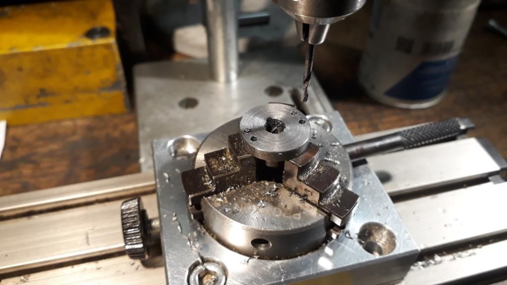

      I have owned a TBM220 with the Rohm 6mm chuck for a few years. It is generally good but at the price has obviously has some limitations:
      – The feed is by a crank and rod rather that a rack so it is not linear.
      – The column and base are not very rigid so with high drilling forces there is some deflection (but why would you be using high feed pressure on such a small machine?)
      – The size range of the collets is limited however the Rohm chuck is good.
      On the plus side:
      – The play in the quill is adjustable.
      – The simple depth gauge works well.
      – The Proxxon short series drill set suits the machine well.
      – It works well for tapping with the drive belt removed.
      I always have the X-Y table fitted and also have the simple rotary table.

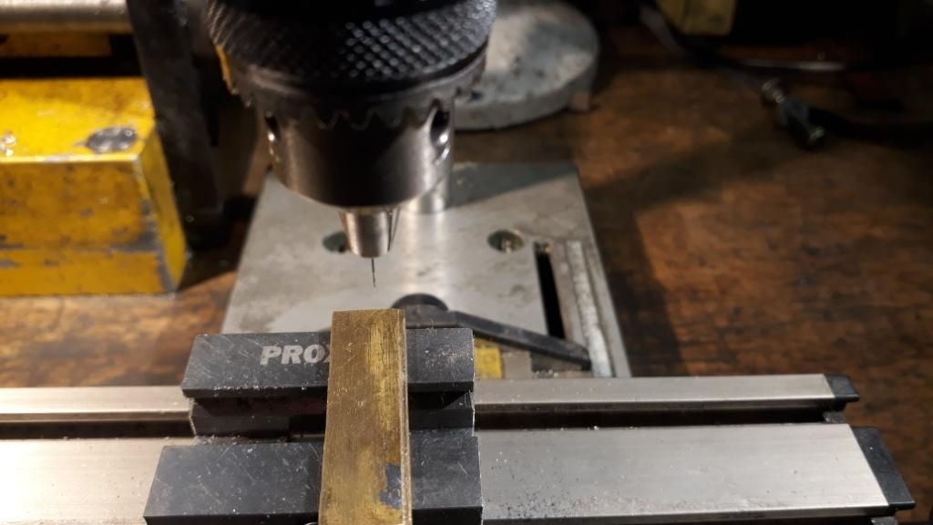

        As a quick show and tell I drilled a 0.3mm hole through a piece of 2mm brass using a Proxxon 0.3 mm drill bit at 8 000 rpm. The Rohm chuck held that with no problems but would not hold a 0.2mm bit (I generally used reinforced shank at 0.2mm or less so it is not a real issue.

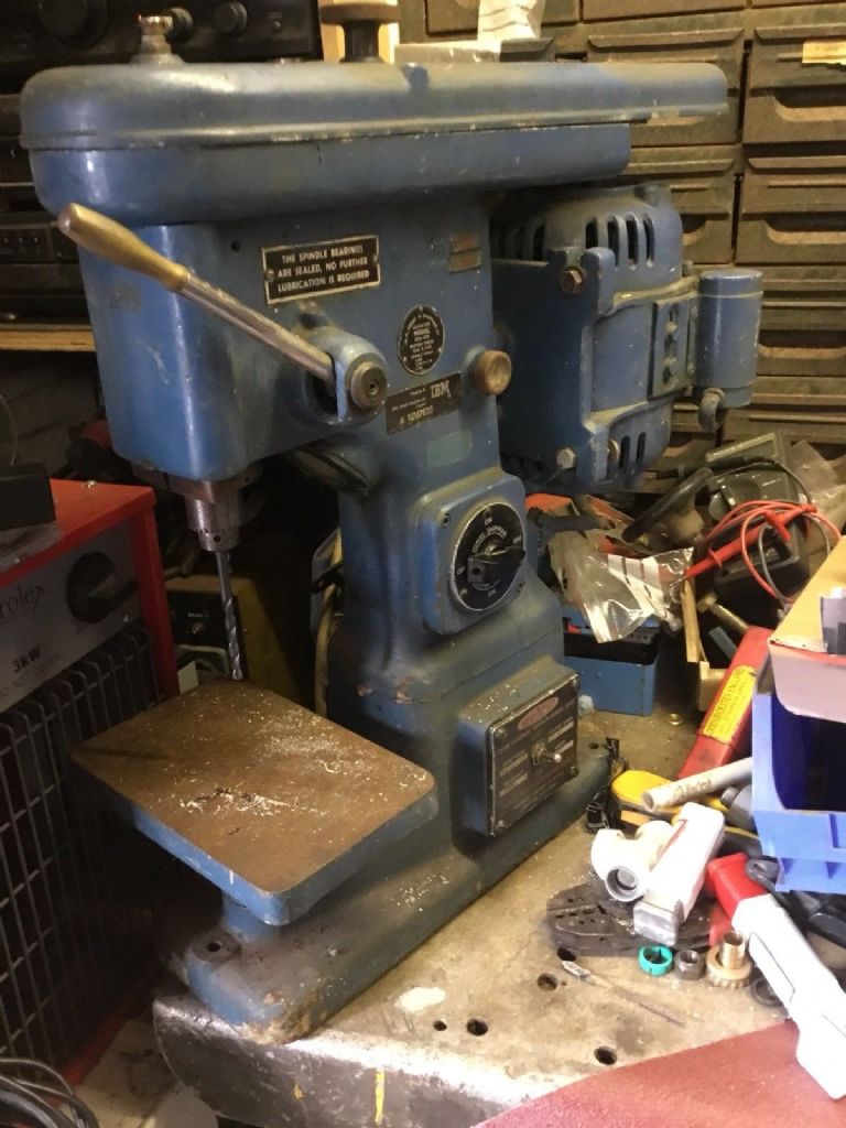

          I don't know if this would suit since it's more in the 'vintage' category but I frequently see jones and shipman precision drill presses on ebay. I bought one myself a few years ago for around £70. There's one up for sale now for £175 that looks to be in reasonable shape.
          These top out at 6000rpm, but they're VERY well made. Might be something to keep an eye out for.
          Here's a pic of what mine looked like when I picked it up.
          #598556
            I have one of those too, Donovan
            … currently partially dismantled, and on the ‘must finish this’ list !!
            The balanced motor is a good indicator of the general build-quality
            … it’s a very impressive little machine. yes
