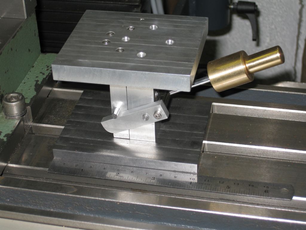

                                    Posted by Mike Poole on 22/04/2022 21:31:28:
                                    A sensitive feed is an important part of a high speed drilling spindle, sub millimetre drills need a high speed and sensitive feel to avoid breakage, the sensitive feel is probably more important than the optimum speed which can reach extremely high levels for non ferrous materials.
                                    Mike
                                    Chuck Fellows (RIP) described a small sensitive drill table and I based mine on his design.
                                    It uses a linear bearing for the vertical slide. The screw holes are spaced to accept a Myford vice and extra counterweights are available to maintain a neutral balance. It mounts on the milling machine table or in the main vice easily. It may not suit Barry's requirements for the high speed but Mike mentioned a very valid point about sensitivity.
                                    The Emerald Isle
                                    Edited By steamdave on 23/04/2022 12:50:15
                                    Edited By steamdave on 23/04/2022 12:51:13

                                      That’s really nice Dave.

                                        steamdave:
                                        When I saw your drill table I immediately thought that it could be incorporated into GHT's UPT instead of the original minidrill design.
                                        Can you point me to details of your own or Chuck Fellows design, please?

                                          ega
                                          Send me a private message with your email address and I'll send you all the info. There is too much to put here.
                                          The Emerald Isle

                                            Steamdave, very nice and a good solution to part of my conundrum. Just need to look at getting the spindle speeds up.
                                            Barry

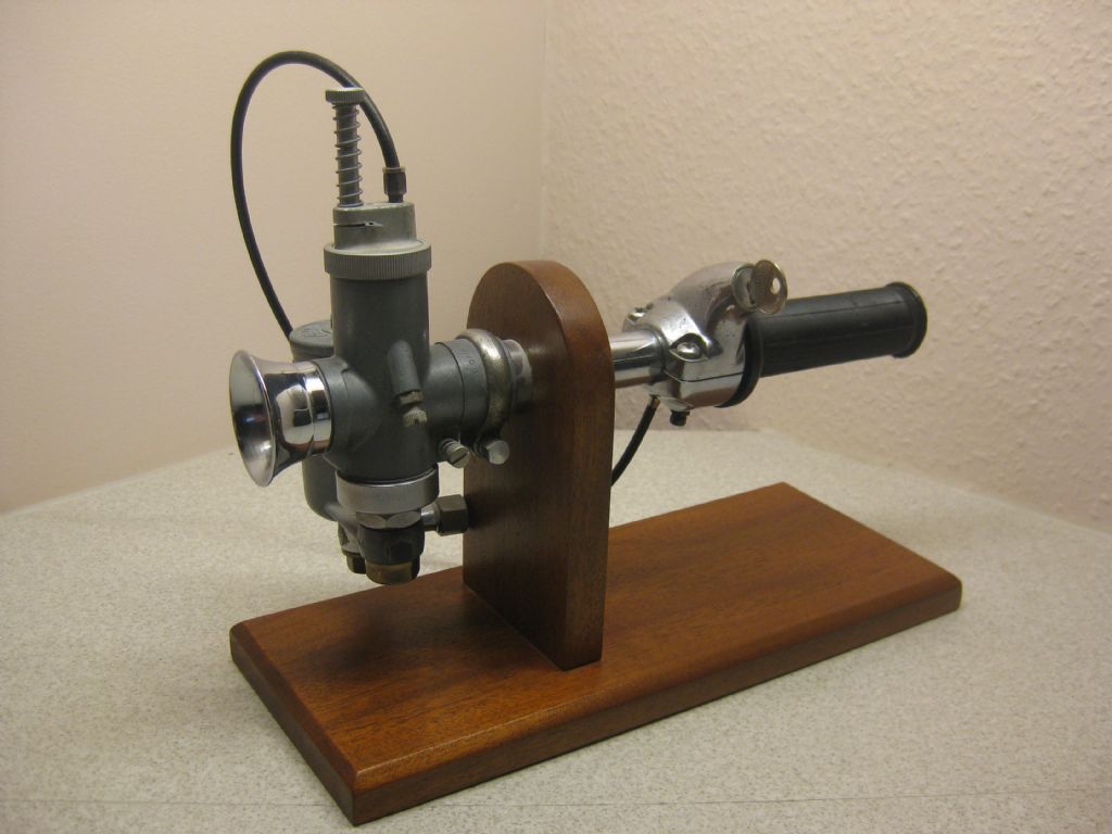

                                                There are some jobs that need a high speed. The twist grip lock barrel in the attached pic was/is secured by 2 x 1/16" pins from the inside. Tried to drill them out with regular drill press and the bit wandered off and started to chew the Mazak casting. The Meddings precision drill put the bit straight down the middle.
                                                DickAmal carb
