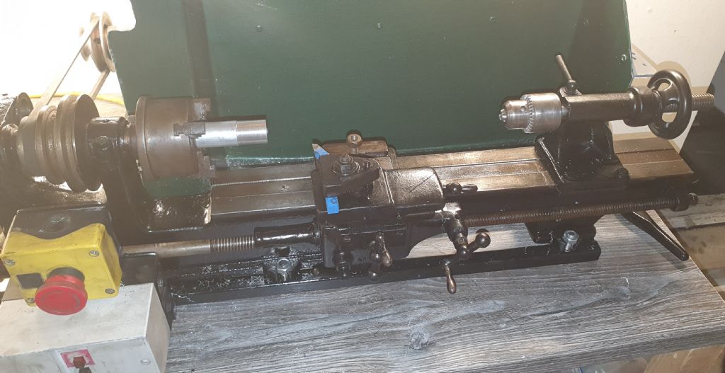

      New to forum, new to manual lathe.
      I do not know in depth terminology,
      Did some cnc lathe programs 20 years ago…
      Couple of days ago got my "new" RandA A
      Actually (go figure) it is not new and is in quite bad shape.
      But it cuts – tried on ali bilet – does the job – I guess it is nuke proof beauti.
      It is enough for me – I am not searching for microns, but…
      I would like to fixit a bit.
      There are almost no gears to transfer power to lead screw.
      Lead screw works ok with the saddle – no much unwanted movement – could be bit smoother movement.
      There is huge movement on cross and top slide.
      I cannot move the tail stock…
      That is it for an introduction of Me the beast and the RandA beauty.
      Appreciate any word on how to start with this lathe to bring it to proper state
      as this piece of history (lathes.co.uk provides nice story but no technical advice) deserves

              I do not keep high hopes for thread cutting facility to be fully restored. Quick search on ebay for parts resulted in 0 listings. As it was released under other brands maybe I will find some replacements among Winfield Grayson Zyto but it is cross checking exercise.
              First good advice would be what chuck I can fit there. I need 4 independent jaw chuck for it as this one has only 3 "outer" (do not know the term) non-reversible jaws (inner set is missing). I will take some dims soon. This will be really helpful as at some stages of the machining I need to fit rectangular work piece not on the center line (don't want to play with shim pads or others stuff).
              Cross slide and top slide have movement in screw axial direction – so I guess it will be the case of fitting new nut/thread (I did not have a look inside yet to see if there is correction in that direction – to exited to play with it and unfortunately discover more things that are to be fixed).
              Saddle/lead screw is probably a good cleaning job and greasing.
              Paint to be stripped.

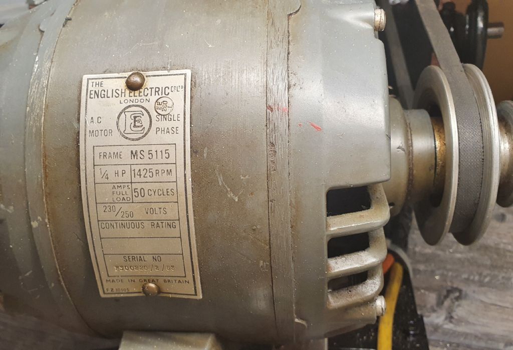

              Belt need a proper tensioner pulley (first job on the lathe?).
              Motor would use a bit of service too.
              I will post some photos soon.
              Best regards
              HD

                      Hi all and thank you for advice.
                      Some things I do know some I did not. In any case It is good to have a reminder. I am not complete engineering newbie.
                      Other matter is English it is not my first language so for example things like grease and lubricant even if I do know technical difference I may misuse the words… I would not misuse them on the machine
                      Regarding movement on the slide screws – I do not mean clearance – I mean MOVEMENT (in big letters because it is quite amount ) about 1mm
                      Lots of books proposed to be read… I am rather hands on person – somehow with touch I learn better. I will follow some of the the suggestions.
                      Model making – I am not model maker – I purchased the lathe to make couple of components for my robot/rover. I knew it will be steep learning – especially when buying lathe for rebuild. But rebuild/refresh will teach me a lot.
                      Yet after initial fun – I see that I will be using this for much more. And watching how material is shaped by the tool is mesmerising.
                      Photos as promised – it does not look that bad – but the devil is in the details.
                      BR
                      HD

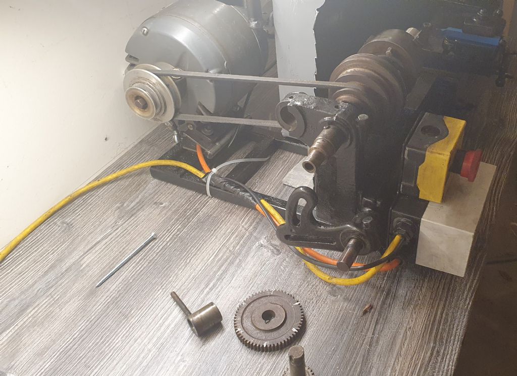

                      #574096
                      Bazyle
                        @bazyle
                        Find the search facility on the front page of the forum. There have been several threads about the RandA lathe in the last couple of years.
                        The changewheels for this lathe are 20DP, 14.5 pressure angle which are the same as Myford post WW2 but use a small pin and hole to link them instead of the keyway. So you can get Myford gears and modify them. Don't get confused by the old pre WW2 Myford and Drummond gears which have bigger teeth and a much thicker pin.
                        Almost all RandAs have broken back gear owing to mistreatment. The genuine gears for this are ever so slightly different (1.5% larger) from the changewheels but it looks like you have lost half of them so can use modified changewheels.
                        Don't rush into anything. I can give you some more info when I have read all the posts in this thread slowly. It might be better to not get changewheels yet and consider using the plastic sets sold for mini-lathes.
                        If you are enthusiastically taking bits off beware this. The apron, plate that hangs down from saddle, has a handle to move it and a lever that lifts the half nut up onto the leadscrew. This lever has a small spring and ball bearing to provide a detent in two positions. The ball bearing is magnetically attracted to the floor underneath your bench and the spring is designed to achieve escape velocity as it heads for the open window.
                        Edited By Bazyle on 03/12/2021 00:15:15

                          I am not going to put all apart at once as I need it to do some job for me first. The plan is:
                          0. Find some time from other works (house build project, heat recovery unit project, christmass special projects)…
                          1. I am going to make a good sturdy place for it (destination is brick wall mounted heavy counter top – should do as a base initially) and fix it down.
                          2. (need to run – will finish later )
                          #574122
                          H D
                            @hd60253
                            cont.
                            2. Have a look into slides and try to cancel excessive movement without spending money (mainly assessment)
                            3. Make a tensioner – with pulley machined on the lathe – to cancel unnecessary vibrations from there
                            4. Do some work (axels, spacers for my wheeled robotic platform WaRP)
                            5. Return to slides with possible replacement components…
                            6. Refresh main screw/saddle (trying to avoid a visit to the orbit in search of the spring)
                            Taking into account other rolling projects… I am set for next 6 months…

                              By the way I suggest you try and rig up a countershaft rather than a tensioner. You really want a 1:2 reduction from motor to mandrel as the top speed for these plain iron bearings. You can make rig with plywood pulleys.
