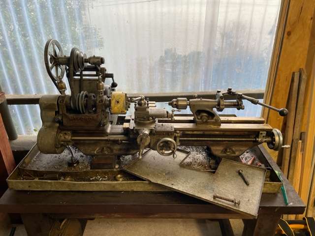

      Hi All
      First confession, I have never used a metal working lathe. That said I am an engineer by profession so not 100% clueless, maybe.
      I have an ML7 that was my fathers. He must have realised his days of model building were coming to an end as after his last project he coated the bed in a heavy grease and packed things up. When I inherited it I had nowhere to put it so it, along with everything else, ended up in a container. I am now about to extract it and get it cleaned up.
      Containers seem to encourage corrosion, at least this one does, hopefully the grease will have provided some protection. They also seem to cause rapid destruction of some plastics/rubbers and encourage a tough black mould on others. I picked up the dividing head and some other accessories last time I visited. The paint finish has pretty much fallen off but there is only light corrosion on the bare metal parts.
      So my questions are around what do I need to do before turning it on in order to avoid damage. I’m mainly thinking lubrication here. Do I need to strip, drain, clean, refill or do anything else ML7 specific other than a surface clean and resupply oilers and lube points? I have found ML7 specification equivalent lubricants.
      The motor will probably have suffered a bit so I’ll approach that carefully but am half expecting a replacement will be required.
      Any ideas welcome. Cheers

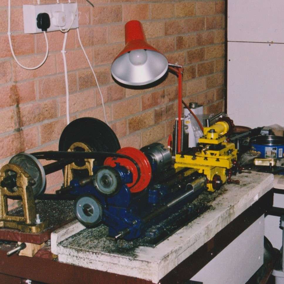

          I inherited a pre-war Myford that had been stored in a similar manner. I stripped it down, cleaned every, used quite a bit of bright paint, built a good bench, lubricated it and used it. It came with a motor which worked.
          I would not do the work now. It took a bit of time and I am too old.

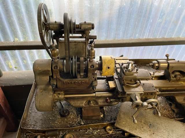

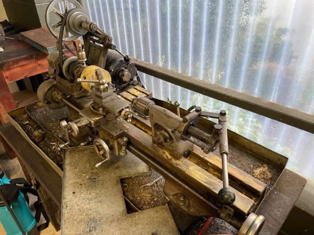

                              Well, after quite a lot of effort I now have the lathe. Not yet in its final position but where I will do the first clean up. Its both smaller than I remembered and heavier than it looks. On first inspection it seems to be in better conditon that I expected. I’ll start cleaning this weekend.
                              Lathe 1Lathe 2Lathe 3

                                To answer your original question about oiling prior to start-up, you should oil all the rotating elements through their lubrication points – spindle, countershaft, gear-train and leadscrew – all lubrication is total-loss, so any oil film will have been broken in storage so that all components will currently be in a metal-to-metal state.
                                As Dave says, rotating everything by hand and liberal (initial) oiling will restore an oil film.
                                The headstock spindle oilers look to be the OEM ones – there is a needle inside which is raised or lowered to control oil flow through the mechanism at the top, I can’t see whether yours have levers or a knurled cap….whatever lifts the needle up opens them, lowering the needle closes them..
                                If you don’t have anything with the correct nozzle to fit the oil nipples on the other parts, probably best to temporarily remove them and fill the hole with oil prior to commissioning – put them back in to keep dirt & debris out..
                                Is the machine on wooden blocks? ..once you have it up and running you will need to check whether it is cutting straight & true – to a great extent this depends on the stability of the mounting, so environmental changes in the wood may induce a little twisting, which tho’ barely perceptible may still give issues if trying to turn parallel lengths..
                                Do you have the ML7 set-up / installation manual?
                                Much useful information inside, I think one can still find a pdf online..

                                      I did a very rough level up today just to reduce any stresses on the machine while I work on it.
                                      Diogenes, it is on wooden blocks, well spotted. These will be replaced with metal at some point.
                                      The oilers are leaver type. The LHS one appears to be all metal, the RHS one looks to be transparent, plastic, glass?
                                      I have a pdf of the manual and a new pump oiler should arrive soon. I did clean up the old one but I recalled it always leaked so thought I’d try an upgrade.
                                      The tray seems to be  a home made one. Its now pretty rough and one corner is split. Its repairable but a bit nasty so I’m thinking about making a new one.

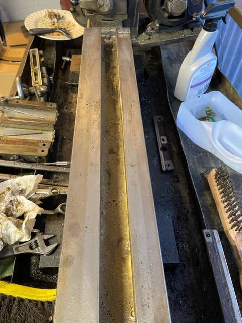

                                      I started taking the grease off the rear of the bed. Its tough stuff, gone pretty hard, I think it was something for pumps originally. Underneath all seems good, just dirty and messy.
                                      The main degradation, so far, seems to be the paintwork, I tried cleaning a couple of patches with some meths and a lot of paint fell off. I’ll get some kero and try that, maybe things go better.
                                      Now another question. The chuck does not seem to rotate. Is there a lock that could be engaged or will it be seized? I have not applied any pressure past a gentle push so far.

                                          Spray can automotive degreaser works well for cleaning old machines like this. Followed by WD40 to final clean and leave an anti-rust layer while you are working on it.

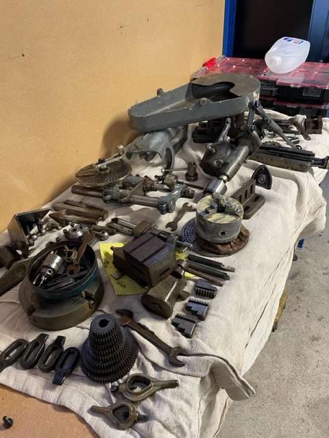

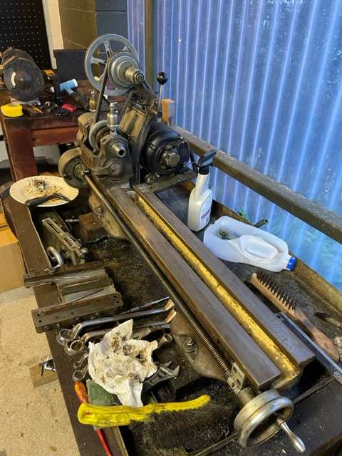

                                            Righto, some progress today. After checking lever positions to make sure everything was ok I applied a bit more pressure and things moved. After the initial resistance things moved easily but as I had not added oil I did not push my luck and left well alone.

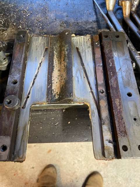

                                            The tail stock came off to improve access for the cleanup and then I found I could not move the carriage. I started removing it from the top down and trying the occasional push or light tap to see if I was making progress. In the end I had the apron off and just the saddle remaining. Still not moving. Eventually after I tried some upward tapping it moved with a bit of a sticking sound. I think some sort of grease-vacuum-glue condition had developed.
                                            The chuck came off easily.
                                            Anyway its partially dismantled and in need of a clean, which I’ll get onto tomorrow.
                                            I’m now wondering about stripping it and repainting. The thing I’m not sure of is realigning the headstock. Is this a difficult process, is there a standard approach? It seems to be a nice machine and fairly easy to understand from the little I’ve seen so far. It’s a 1950 model so a new coat of paint and a proper clean up is probably not overkill.
                                            I’ve attached a photo of some of the bits and pieces that came with it. There are still a few more. Some I’m unsure of including the dividing thing. Lots to learn.
                                            CheersLathe 4Lathe 5Lathe 6Lathe 7

                                              Re-aligning the headstock – my advice is leave it well alone, it’s easy enough to repaint with it in place.

                                                The Myford  ‘dividing thing’ is treasure in its own right

                                                  I’m with Rod, lube the headstock and leave it alone. The Myford dividing attachment is a handy and valuable tool, there is a set of separate instructions for it’s use. Good Luck. Noel.

                                                      FWIW, like the others, do not distrurb the Headstock. “It ain’t broke, so don’t fix it!”
                                                      By all means clean and oil. That simple work will work wonders.
                                                      Even if some of the paint is missing, cracked, or flaking the machine will still do what it is required to do.
                                                      If you want to repaint, the belt cover will be a guide as to the “correct” colour. No doubt, some auto shop, locally, can mix some for you, when you need it.
