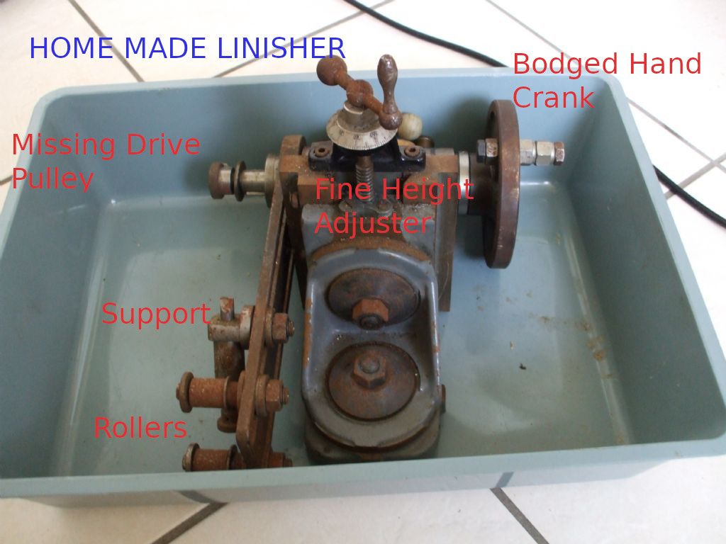

      hi guys im Gary from Belfast .. i have just bought my first lathe a Myford ml7 tri leva … bought it on Sunday and it took me three days to completely strip it and clean it because the last owner lets just say wasn't as fussy as me .. used a lathe in school many many years ago and always wanted one so took the plunge and bought it ..
      the guy gave me a lot of spare parts and tools along with a weird looking attachment so i will post pics soon and ask a few questions if you don't mind ..

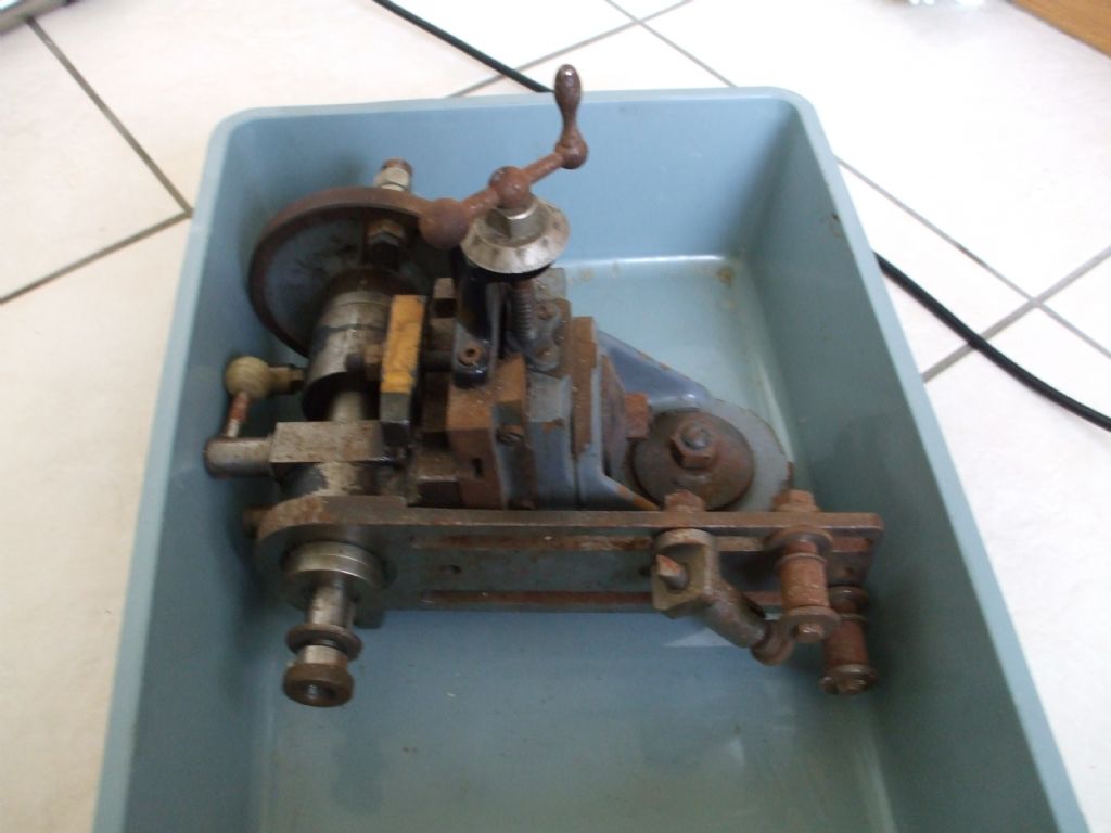

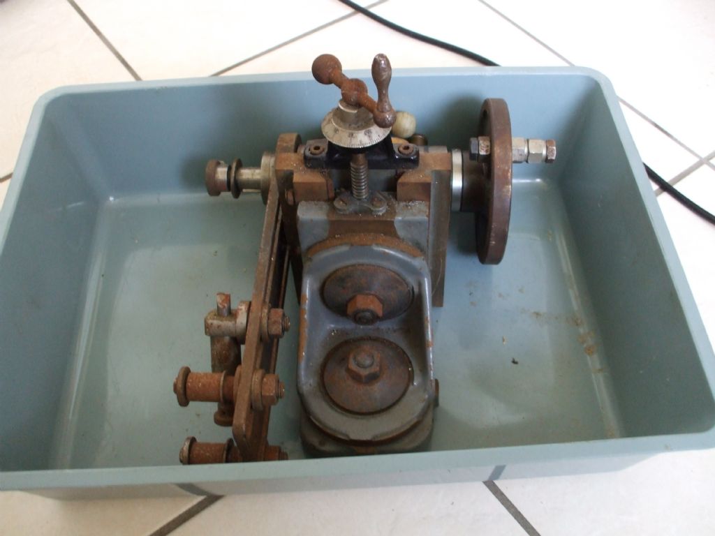

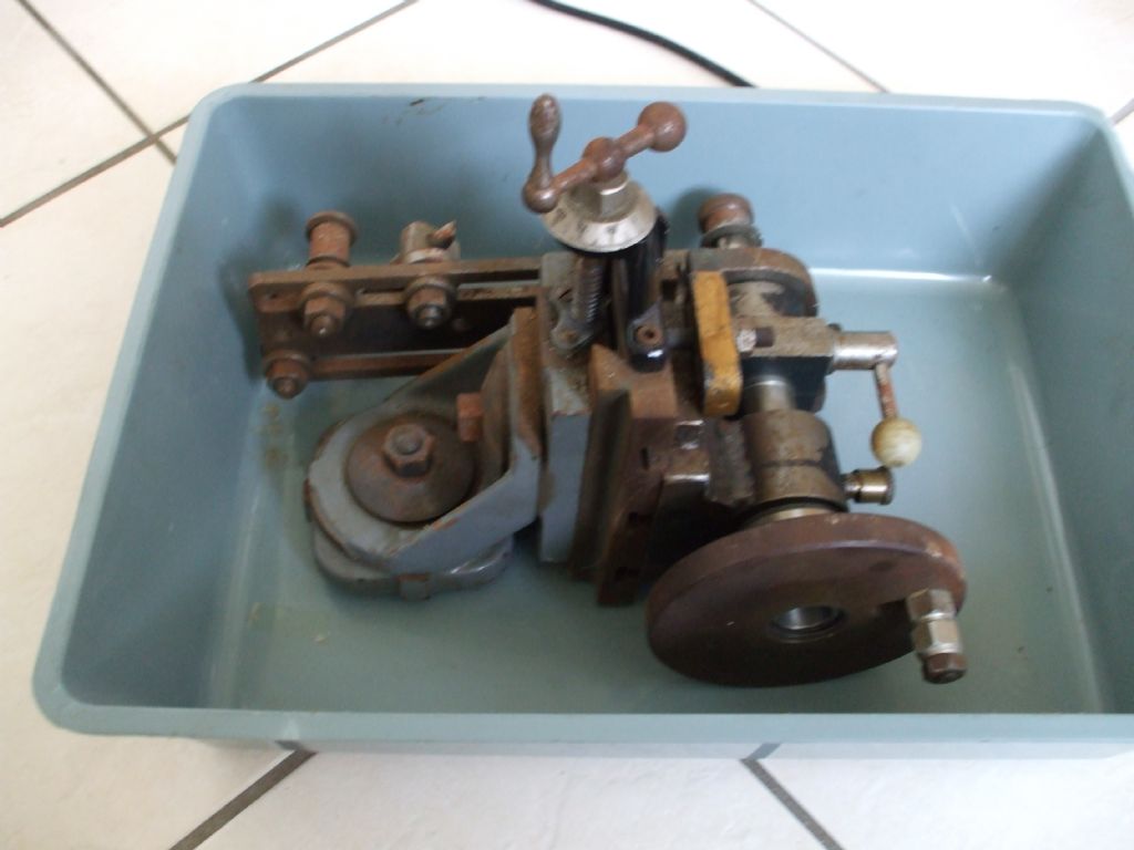

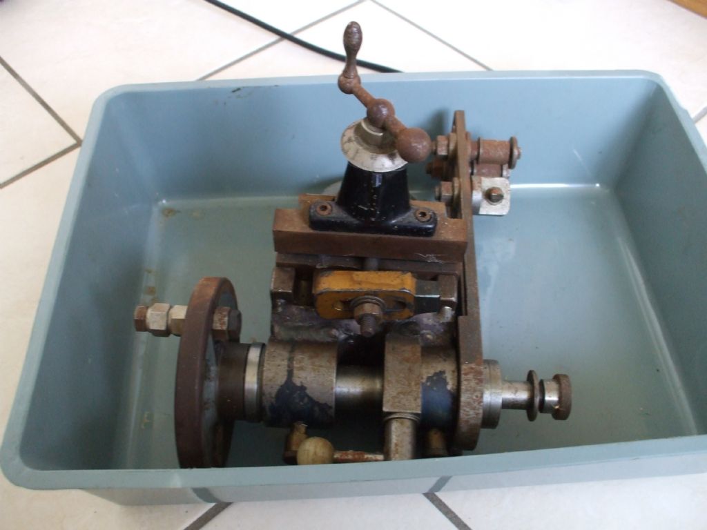

                dscf3325.jpgdscf3324.jpgdscf3323.jpghere's some pics of the attachment ….dscf3322.jpg

                  anyone know what this attachment is ?
                  #587126
                  noel shelley
                    @noelshelley55608
                    The main part is a swivelling verticle slide, but what's mounted on it will need a better man than me . Welcome to the forum. Noel.
                    #587130
                    BASS 666
                      @bass666
                      Posted by noel shelley on 24/02/2022 21:11:44:
                      oh i see the slide now .. it's defo a weird contraption attached to it …

                        Posted by BASS 666 on 24/02/2022 11:59:58:
                        The item in the middle of the upper slot appears to be a plunger, probably to engage a gear for indexing.

                        noel shelley
                          @noelshelley55608
                          Good one Mike, that would account for the lock on the spindle – though fairly large diameter wheels ! Noel.

                                              My guess is it's a home-made linisher or belt sander.
                                              On the left, a large drive pulley is missing. A complete device would drive an abrasive belt over the two rollers at left front. The chisel thing marked 'Support' supports the underside of belt when work is being sanded: possibly the chisel held a platform which is also missing.
                                              The precise height of the belt relative to the chisel/platform is controlled by the dial handle. This part of the device is an adapted slide.
                                              On the right, the bolt and nuts are either a temporary drive handle or a dog intended to be driven by the lathe's faceplate.
                                              The photo is a rear view, and in operation the belt would be on the right, and the arm adjusted more vertically, something like this commercial example.
                                              My feeling is it's a lash-up of parts rather than a commercial product or kit. Someone making the best of what he could get hold of. Dates back to the time when lathes were accessorized enthusiastically because workshops were tiny and power tools expensive.
                                              Today small belt sanders are under £100. My guess is a new one would out-perform BASS666's fully refurbished device and be a lot more convenient! Assuming my guess is correct that is! Although I'm not impressed by the device itself, the parts it's made of are useful. The swivelling do-dah is well worth having on it's own.

                                                well mate you could be right because i have no clue as to what it is but i will say the chisel part looks like it was sharp at one time so if it supported something it should have been more squared off imo …. the sad part is it will prob get binned as i have no use for it …

                                                  As before, don't rush to bin it. Firstly a Myford Vertical slide is not a cheap attachment, and secondly it gives you the ability to do basic small milling tasks in the lathe, so binning (!!) or selling it will only reduce what you can do with your new investment.

                                                    My money would be on a double swivel vertical slide with an indexing attachment fitted to it. The item that SOD has labelled "support" is the detent plunger that engages with the space between teeth on the indexing gear that is fitted to the end of the main shaft, (labelled as missing pulley by SOD ). The holder for the detent plunger can be slid along the slot to accommodate various diameters, and hence tooth count, of the indexing gear wheel. My guess would be that the two "roller" type parts could be to carry/guide a weighted cord that is used to ensure that the indexing gear is kept against the appropriate face of the indexing detent plunger.

                                                      i will keep the slide and see if anyone wants the other part for the cost of post ….
