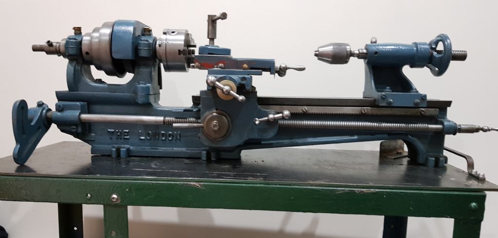

                      #374275
                      rich simmons
                        @richsimmons63485
                        Posted by Neil Wyatt on 01/10/2018 22:50:47:
                        Welcome to the forum Rich.
                        Have you got any pics of your machine?
                        some here of the work in progress

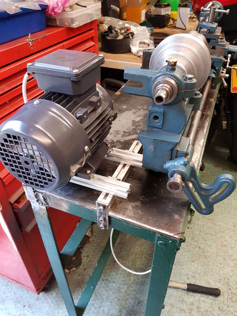

                        #374276
                        rich simmons
                          @richsimmons63485
                          #374277

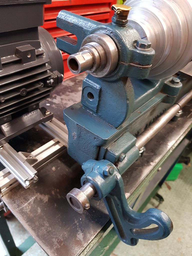

                          rich simmons
                            @richsimmons63485
                            #374278
                            rich simmons
                              @richsimmons63485
                              Posted by Brian Wood on 02/10/2018 08:45:37:
                              Hello Rich,
                              Without checking, I feel pretty sure Myford 20 DP change wheels will be compatible, Grayson lathes were copied from Myford.
                              You might find the bore sizes to be different but that can be addressed by either sleeving or boring as necessary and then restoring the keyway [0.125 inches wide]
                              Regards
                              Brian
                              im not sure exactly what bits im missing to drive the leadscrew from the spindle. you can see what ive got from the pics
                              #374428
                              Howard Lewis
                                @howardlewis46836
                                Since you seem to have no Change wheels, you could use 20DP gears from a Myford 7 Series (These use keyways, the earlier ML Series used pins – AVOID), or spares from the current oriental machines, although they will be metric (Module) gears, and will certainly need sleeving / boring to suit. Keyways will be either 3mm or 4mm.
                                If you choose that route, among the UK suppliers would be Warco, Axminster, Chester or ArcEuroTrade. Look at their websites. If you tell them what you are doing, some may be more helpful than others
                                You have the banjo, but will need to make up Studs to carry the gears on it. It would be useful if you could make up a tumbler reverse, whilst you are about it.
