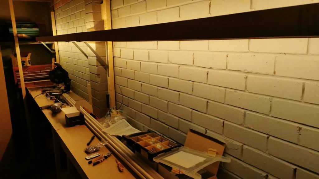

      Liam Cook
        @liamcook40712
        Still awake Howard, just
        Thats really interesting, . Especially about the rust my garage come shop is dry except for 2 small corners on the floor which suffer a little with damp, but I've a mini in there from the 70s which has sat for 5 years with no additional rust, despite all the bare metal so it's good enough (I hope). Nothing a bit of blue won't keep right with a light coat of oil, even WD40 isn't bad as long as its applied a few times a year.
        When its my turn I think I'll get a slightly beaten up, second hand one, can't be doing with absolutely pristine things, makes me feel bad getting them dirty or dinging them! Like the satisfaction of fixing things as well, not absolute beasts of a job as they sap too much time for the reward, but changing bearings, cleaning back and painting, fixing small issues.
        For reference, heres the ol shop, its changed a lot since here, electrics been run throughout and its a lot tidier, this was mid project running all the electrics in and building the worktop and shelves. Eventually a lathe will go where that toolbox is and I'll bring the worktop out another few hundred mil. It looks really narrow because its just over 5 meters longshop.jpg

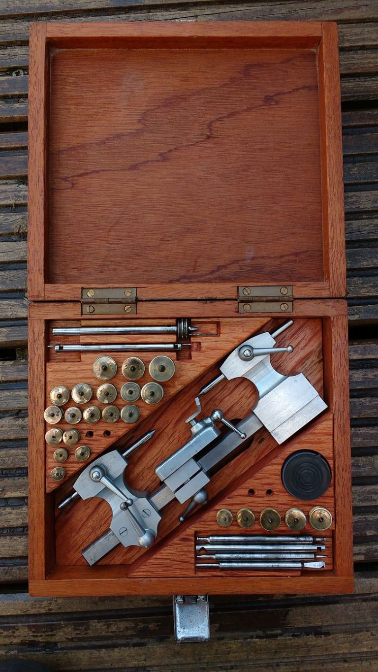

                                        jaCK Hobson
                                          @jackhobson50760
                                          Posted by Nigel Graham 2 on 06/02/2021 21:30:59:
                                          PS _ I forgot. I once had an elegant watchmaker's turns,
                                          Ah yes! I pimped my turns:
