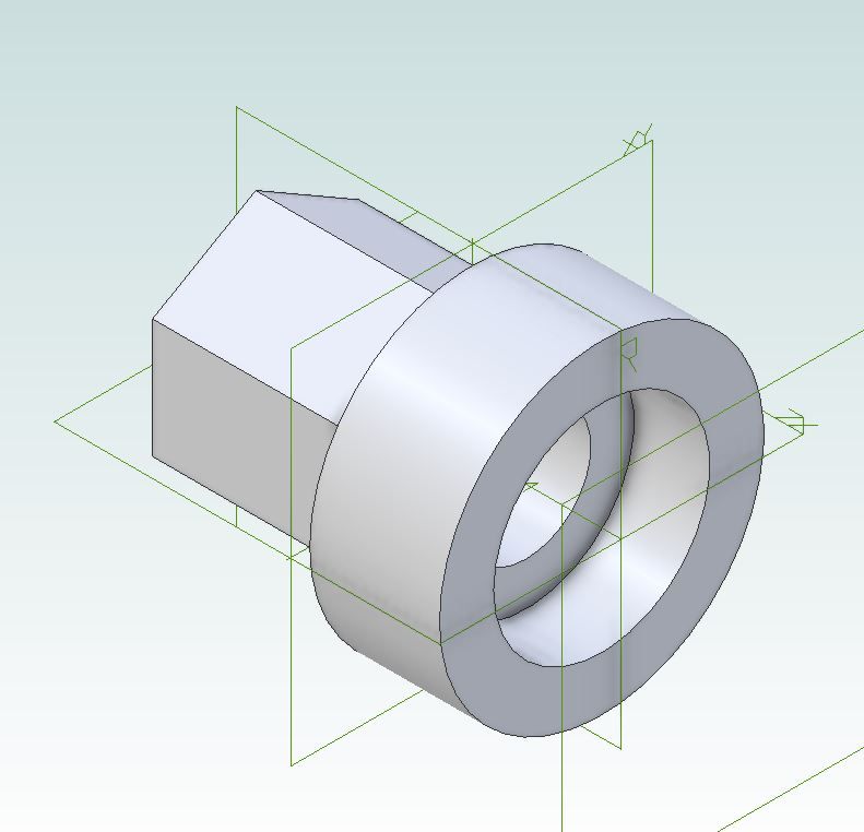

  • #573401
    pgrbff
      @pgrbff
      Do these have another name? I can only find them for sale in the US. Where might I find one in the UK?
      I'm in Italy so my search engine would not give me as many good hits as someone in the UK.

            Buy a cheap (i.e. 'soft' ) 6-point socket and either put a handle on each side or turn it into a round 'adaptor' to fit a split-die holder?
            Edited By DiogenesII on 29/11/2021 07:29:33
            #573404
               Ir read it as wanting to hold round dies in a hex block
              Should be easy enough to make one from say 1.5" hex bar or just mill six flats onto some round bar, bore a pocket for the die and add the grubscrew holes.
              When I have not been able to turn a die in a standard holder I have used the round holders from my tailstock dieholder and used grips on them.
              Edited By JasonB on 29/11/2021 07:30:38
              Edited By JasonB on 29/11/2021 07:34:20

                      #573410
                        Thinking about it a bit more I'd probably make them like this. That way you could get a socket on the end or if in a tight space use a smaller pair of Stillsons spanner to turn the holder

                          Posted by JasonB on 29/11/2021 07:29:26:
                          Unfortunately I'm a woodworker not a metalworker. In the process of restoring an old bandsaw.
