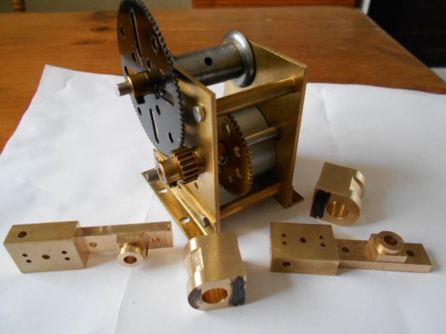

                                      dscn1164.jpgThanks for the replies, as stated the cylinders do look rather small and would look out of keeping for drains but worth some holes that can be plugged .
                                      A slow progress picture that Bill asked for.
                                      The large gear was slightly out of centre so I had to offset the bearings by .2 mm for it not to bind with the other gear, plus not as the drawing owing to what I could find in the shed.
                                      Bob
