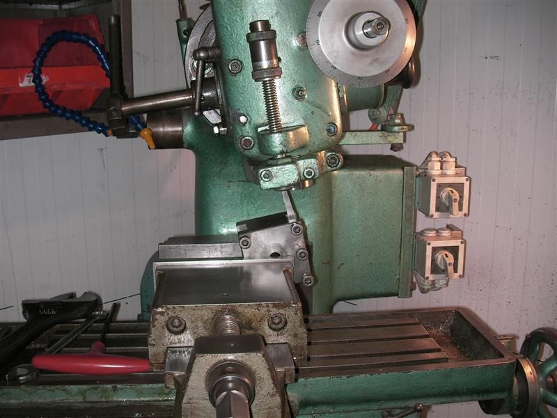

            I had one of those for about 12 years, a nice little milling machine. I got 6 collets with mine all imperial, I imagine that was the full set when it was sold new.
            I was dismayed by the lack of tooling options so I removed the spindle and posted it to (the late) John Stevenson. He let a piece into the end of the spindle and machined it to accept R8 collets. After that, it was a much more useful machine.

                If you have a lathe with a 4-jaw and fixed steady you could easily do the work yourself. Pull the spindle and put it in the 4-jaw. Turn out a pocket in the end and press in a slug of something tough like EN24 steel. Bore it and rough turn to your taper angle by holding the back end in your 4-jaw and the front bearing running on the fixed steady.
                Now re-assemble the milling spindle and tip the head over to the half-angle of the R8 taper. Clamp a toolpost on the table, line it up dead on the centre line of the spindle and use the Z handwheel to lift the knee and cut the taper. Now you'll have a R8 taper that's running perfectly true to the spindle.
                That's how I did mine.

                      When I bought my Herbert 0V I replaced the spindle taper with a 4MT, the main reason being that I had 4MT tooling from the mill the 0V replaced. I finished the taper exactly as Pete R described. Not that easy to do but well worth the effort.
                      With hindsight, I would have preferred to use a 30INT taper. The advantage of the International taper is that its not self locking unlike a Morse. Both Morse and International tapers give a far more better location than R8. Also, R8 mountings are known to wear on the parallel diameter with the inevitable affect on accuracy. Providing the mounting is accurate in the first place I don't think that will be a problem with the amount of use our machines get!
                      Incidentally, I replaced the existing bearing arrangement with tapered rollers for a more ridgid support of the spindle. Doing this enabled me to reduce the overhang of the tooling and gain a little more vertical capacity.
