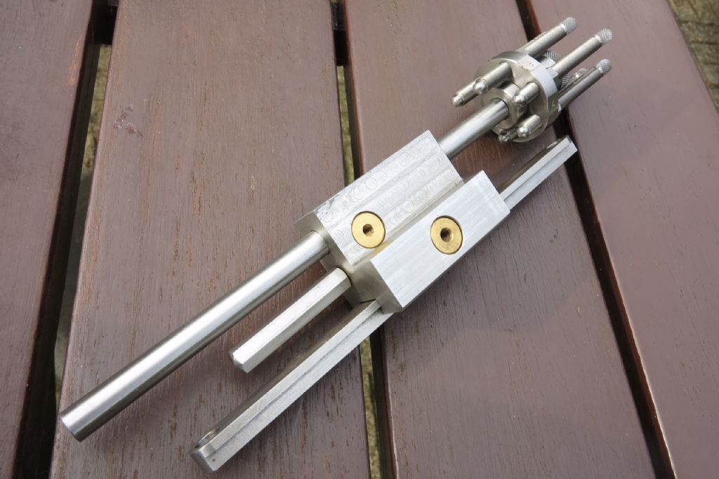

        Hi
        Has anyone made and installed the Hemmingway multi position saddle stop kit on their Myford 7. I'm fairly new to model engineering and am having difficulty understanding the plans. In particular the main block needs to be split in a couple of places but I'm not sure where. Has anyone got any photos of the build or final product which would give me a clue?
        I've phoned and emailed Hemingway but they haven't answered.
        Any help would be much appreciated..

          Hello Jonathan, I will dig mine out and send photos if you give me an hour or two. It’s a really good piece of kit.
          #502268
          Baz
            @baz89810
            Have made a couple of them, PM me and I will send pics etc. Would upload them here but is a bit beyond my abilities.

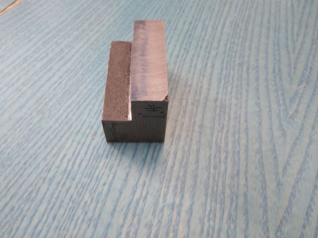

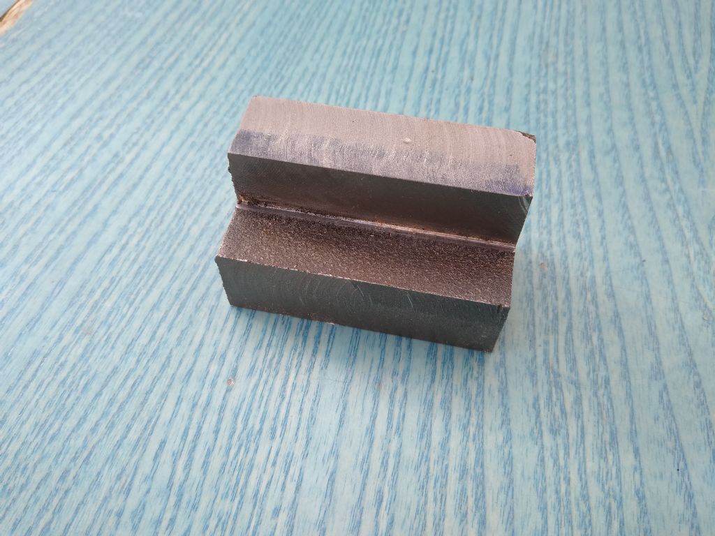

              Have you got a photo of the casting – the Hemmingway site only shows the end result.
              #502289
              Jonathan Blake
                @jonathanblake46754
                img_20201020_144922905.jpgThanks for the rapid response folks.

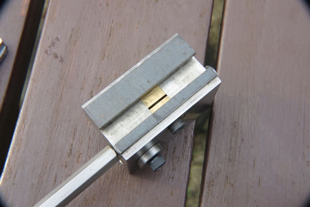

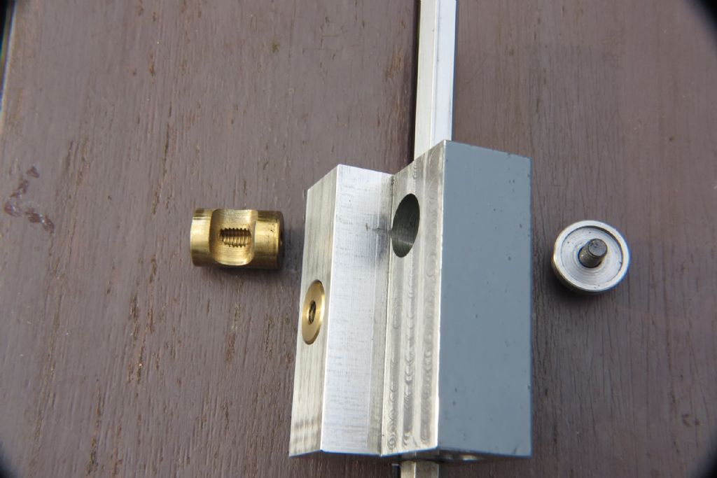

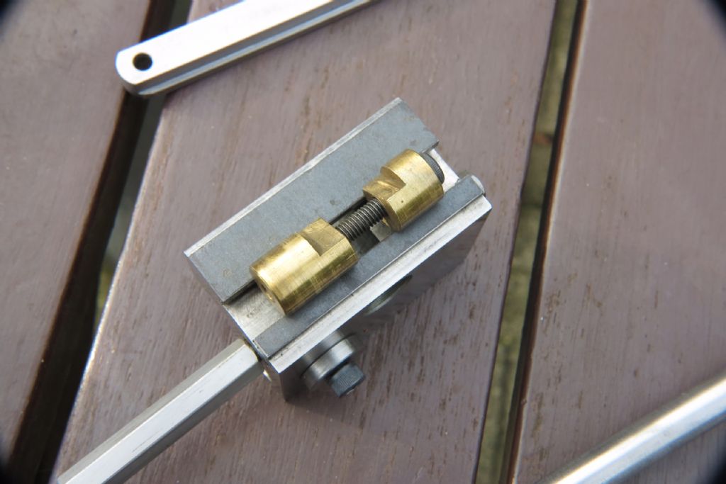

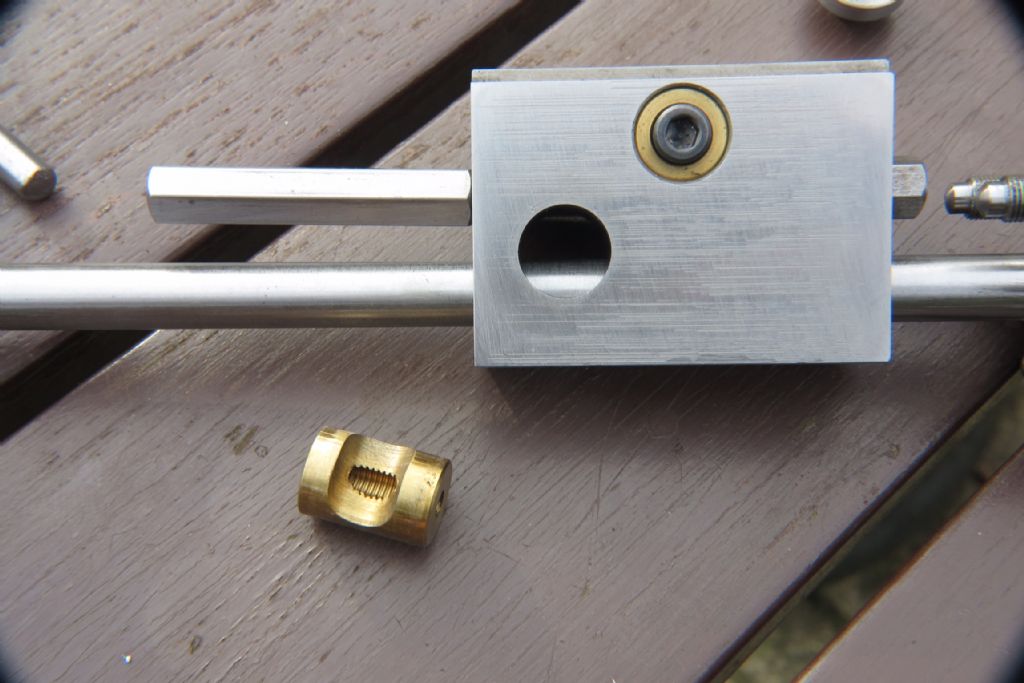

                  cecd318d-5c33-49a2-8440-b4e7d428dbca.jpegaeb4e81a-5e1a-4101-9dd7-cf68ef8c62e0.jpeg9eeb4773-b10c-4a85-abbc-5f2be13818a9.jpeg59353935-fbe0-4c60-9d76-7ffd91b46d40.jpeg3ded9756-50dc-4438-b983-ab54b9f5448f.jpeg
                  #502291
                  bernard towers
                    @bernardtowers37738
                    Hope the images are helpful, not sure about slits but there is a t slot at the rear. I did not have a casting mine is from a block of black steel

                        Thanks Bernard. The photos are really helpful. I understand now that the slits in the drawing are showing the cuts of the Saddle and Guide rail clamps although in your version you haven't split the Saddle clamp. Is that correct?
                        Also I understand that when you use the stop you clamp the stop block to the guide rail, but how is the saddle clamp used? Is it just clamped in place when you are setting upand then release during operation?
                        Thanks again – Jonathan
                        #502458
                        Baz
                          @baz89810
                          My personal opinion is that the saddle clamp is unnecessary, Myford provided a perfectly good one on the back of the saddle.
                          #502460
                          Jonathan Blake
                            @jonathanblake46754
                            Good point Baz. That saves some machining as well.

                                    The brass clamp (split cotter) does need to be split, one half is threaded and the other half clearance. Then tightening the screw pulls them together clamping the bar from both sides which is better than a simpler cotter that only clamps against one side.

                                          I did buy this from Myfords at a show a few years back. It does not do a great range of length but for small parts up the chuck end it works well in conjunction with a chuck backstop. The device makes use of existing tapped holes so no modification of the lathe required. Don't know if they still have any, maybe worth an eMail.

                                            Martin, I much prefer a stop on the left hand side, if you had different length screws you could possibly get a greater range of lengths, the Hemmingway version is only any good for a couple of inches and the big downside of it is that you cannot wind the saddle towards the tailstock, the clamping block being on the right hand side of the apron limits this so it is impossible to get say a boring tool far enough away for you to be able to measure a hole.

                                                    My Hemingway one is good for at least 6 inches and I don’t have trouble with the handwheel
                                                    #612715
                                                    Dave Wootton
                                                      @davewootton
                                                      I built the Hemingway one years ago to fit a very late ML7 only to find that the saddle will not traverse over the part that has to be fitted to the front of the lathe bed. So on some ML7's it will limit the travel and will need removing before the saddle can be traversed the full length of the bed, I did email Hemingway and they admitted that this happened on some later ML7's, with some glib comment about how useful I would find it anyway! There has never been a note put on the website to this effect, and I know from a previous forum post others have found the same. I was fortunate and sold mine to a friend and it fitted his S7 perfectly, but was still annoyed at the time wasted building something that didn't do what I needed. I think this is what ar ys means in his post.
