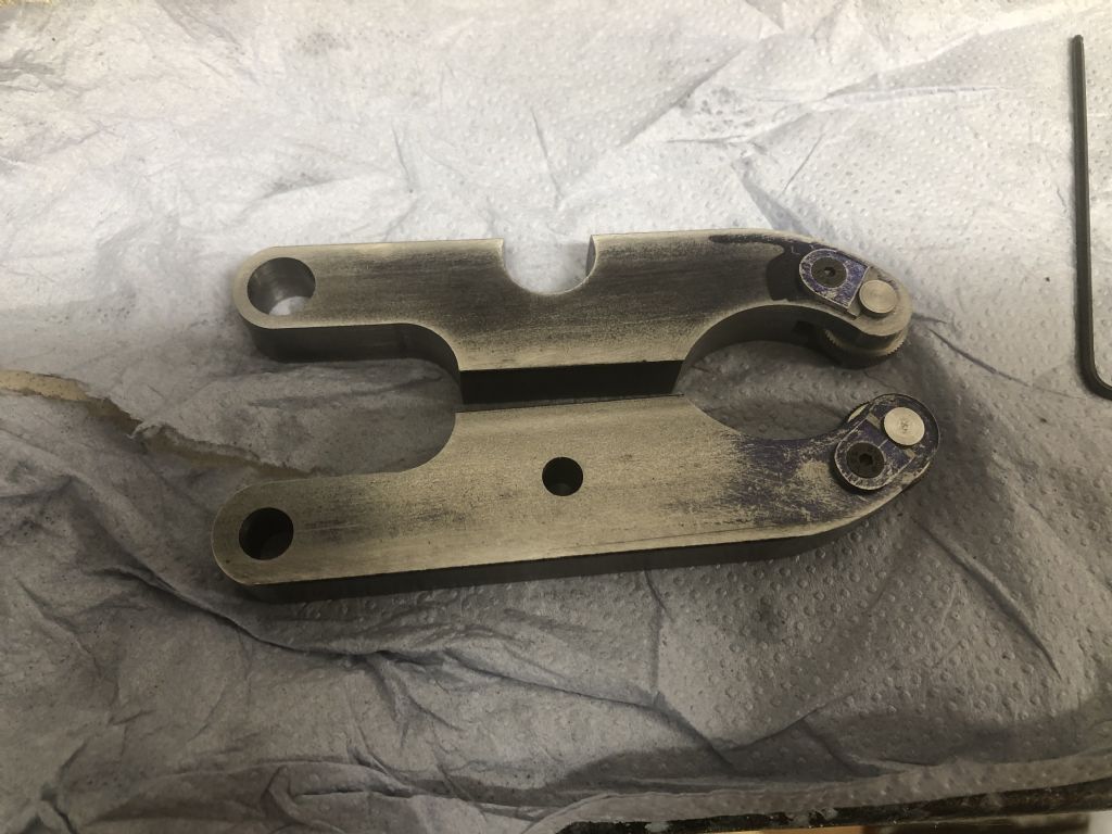

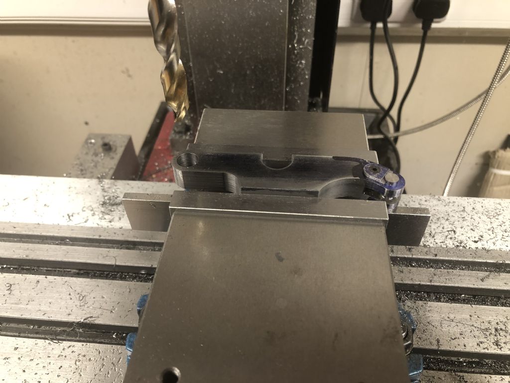

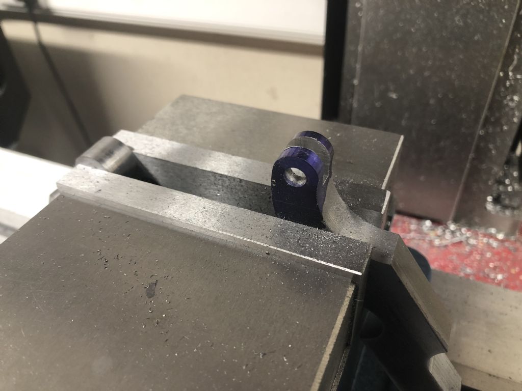

      Tonight I made a start on the slots in the arms where the wheels fit. The slot needs to be .188” or 4.775mm in my money. So I thought I would use a 4mm end mill and offset it .38 either side once I had got to depth. It would have worked, except the slot needs to be 15 odd mm deep and my 4mm end mill only has 11mm usable length in the flutes before it flares up to the 6mm shank.
      I used my cutter to make a start and ordered a ‘long series’ to take the final 4mm or so out.

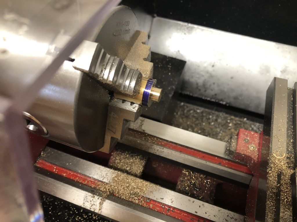

      As it was all set up, I left the mill and started on the bottom pivot on the lathe. I did have a go at the silver steel with a carbide insert, but I think I was taking it too easy and the silver steel seemed to be work hardening and at one point the cutter wouldn’t cut. I changed over to hss and made this:
      Both ends need facing off to length, but I’m pretty happy, the lathe is cutting it nicely with a bit of cutting fluid and both ends mic up at 6.35mm and are a nice sliding fit in a 1/4” reamed hole. I took them down to 6.4 and then finished them off with an emery board.

          Thanks for your comments. I have considered opening out the slots for the knurls and it makes a lot of sense. As I bought both the fine straight and fine diamond set with the kit, it would mean me making up washers to space these correctly.
          I have decided to build to plan, but keeping in mind that if I need to, in future, I can open up the slots to take the wider knurls.

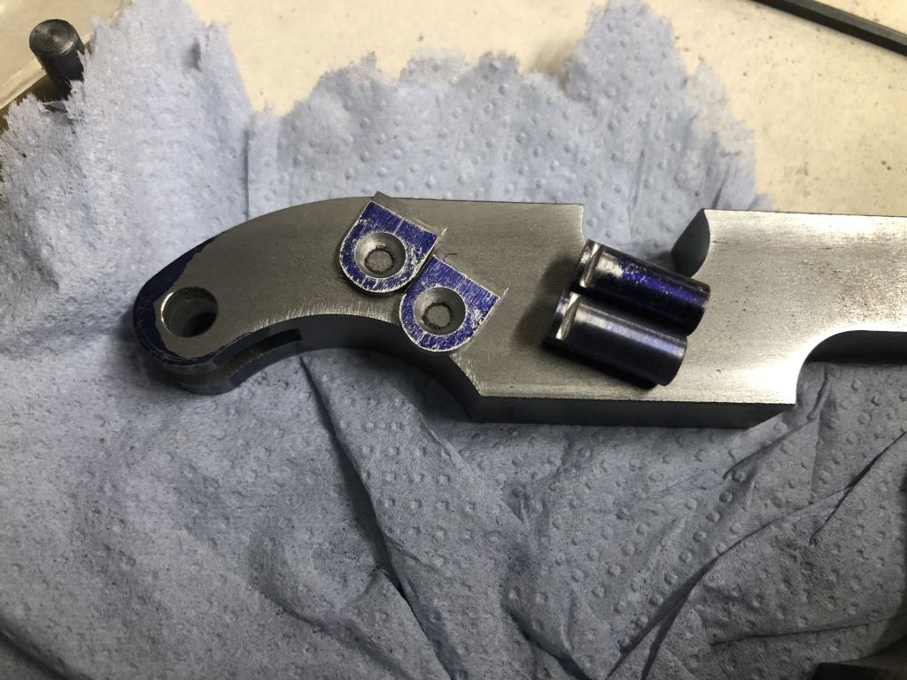

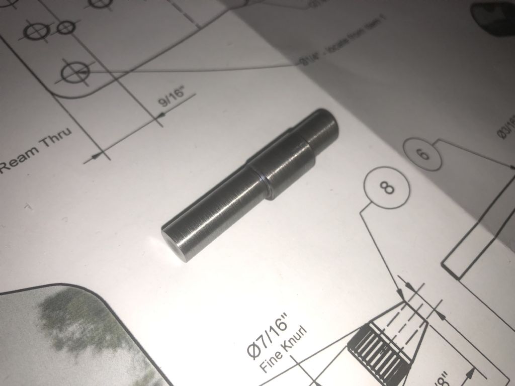

          I have got a bit more done this week, and I’m going to take lfoggy’s advice and harden the pins that the knurls run on.
          Apart from some cosmetic work to tidy them up, all holes are now reamed to dimensions and the arms are finished.

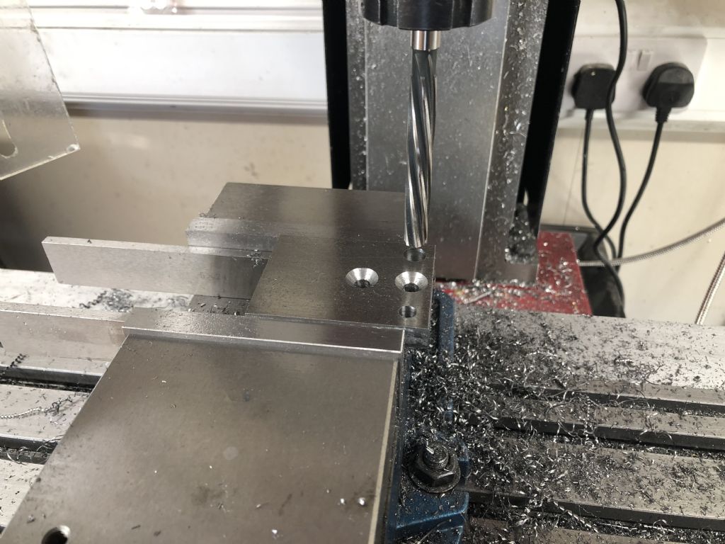

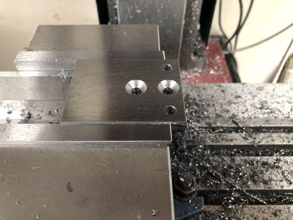

              I made a start on the side plates, squaring one edge up, using this and an edge finder to set up the DRO, then spotting all of the holes, followed by the necessary drill/ream/tap/countersink.
              It all worked out pretty well, it’s not far off as it all fits together. Now I just need to remember to bring the other edge square and to final dimension (both plates were supplied ~5 mm over length)
              I have decided that it makes more sense to do all of the milling operations that need doing with the vice, and then swap over to the rotary table and mill all of the curves.

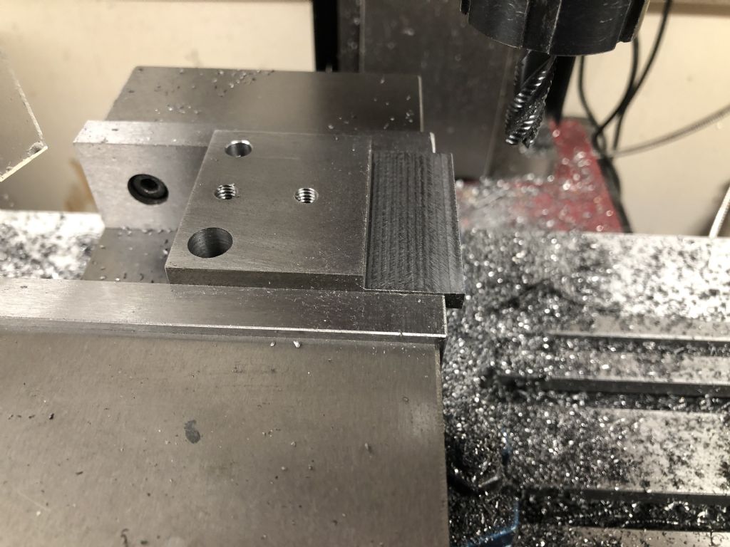

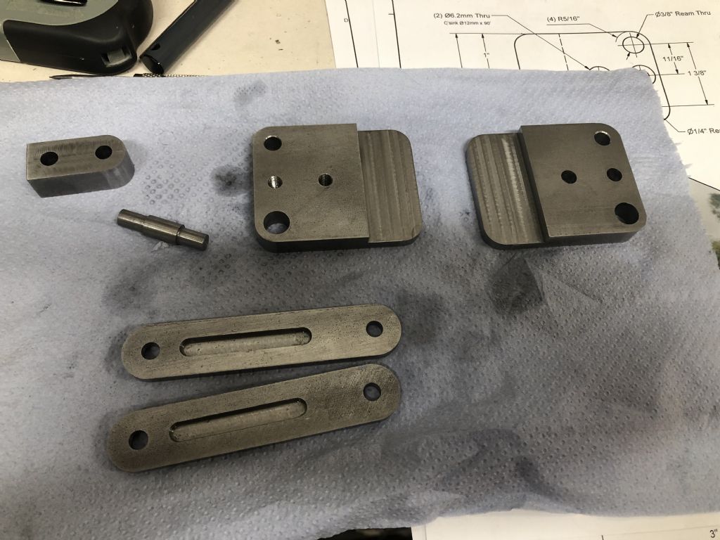

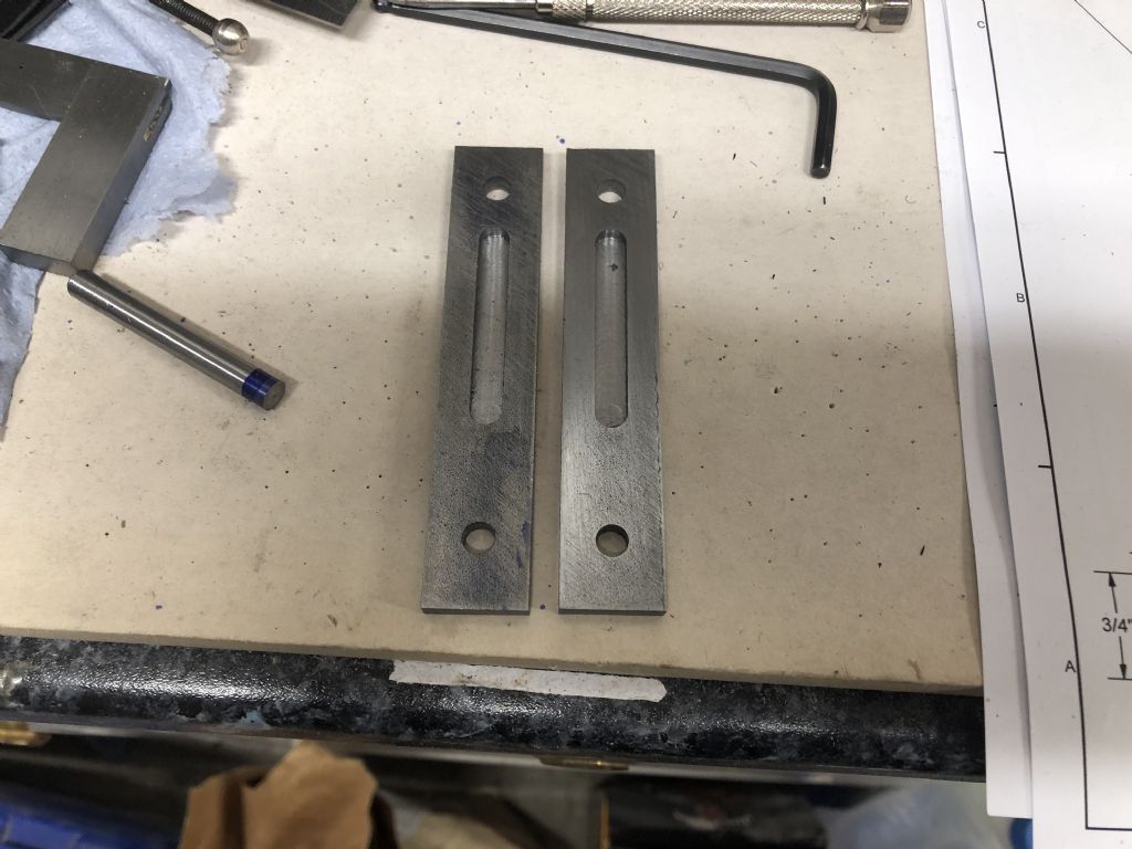

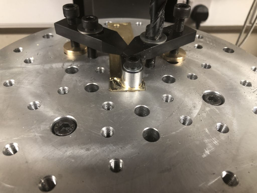

                Today’s jobs were to mill out the slots and drill the ends 6 mm for location on the rotary table on the adjuster side plates, I will use the 6mm holes and my 6mm silver steel to relocate these in the vice to finish off the holes to correct dimensions once the ends have been rounded off.
                I also made a start on roughing out the side plates, in the photo below, all dimensions are .25mm oversize, I’ll bring them into final dimension with a standard cutter.

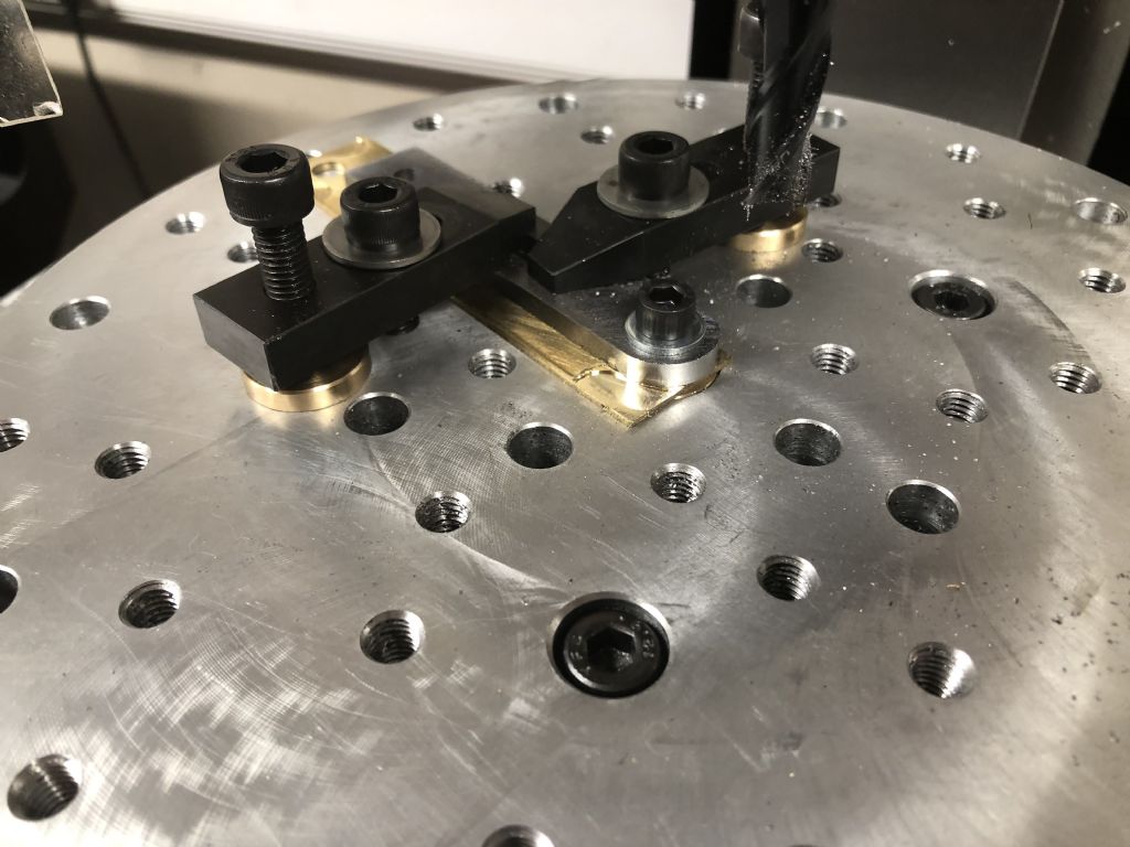

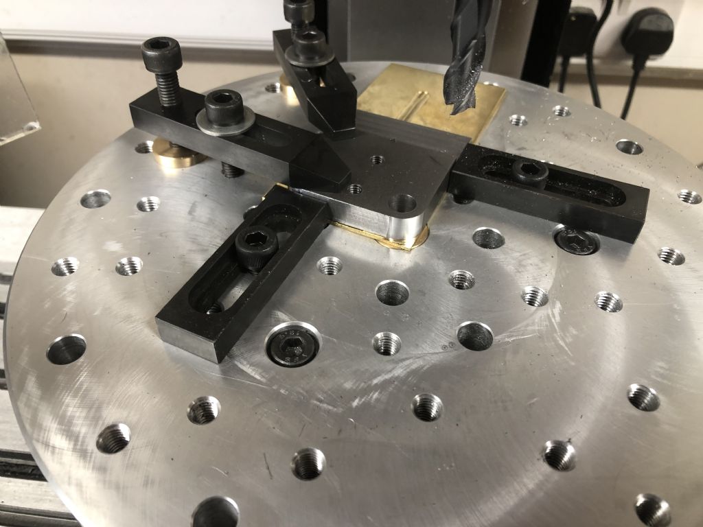

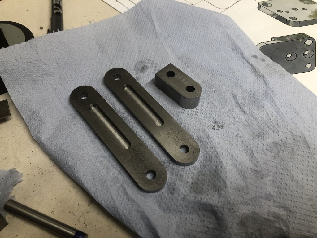

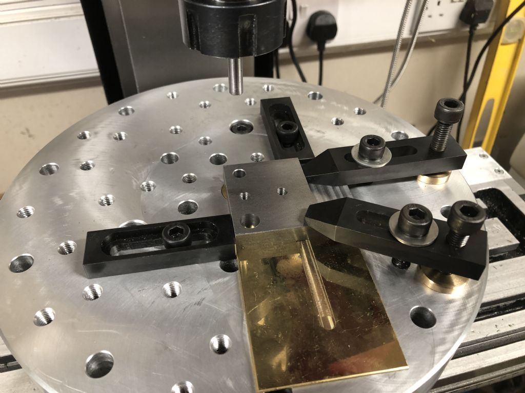

                  I managed to get a little more done this afternoon. Changed out the vice for the rotary table and sub plate and got the adjuster arms milled round and the spacer done as well.
                  Just the 2 main side plates to round all of the corners off and I can get the vice back on and take all of the holes to final dimensions.

                    Got a bit more done today, all of the rotary table work is now complete.
                    I set set up a couple of ‘fences’ so that the side plates could be located on each corner and checked location using the end mill before changing for the rougher and taking most of the meat before changing back to take the last .25mm.
                    Lots of tool changes and set up work, I couldn’t resist putting all of the bits together to see how it looked.

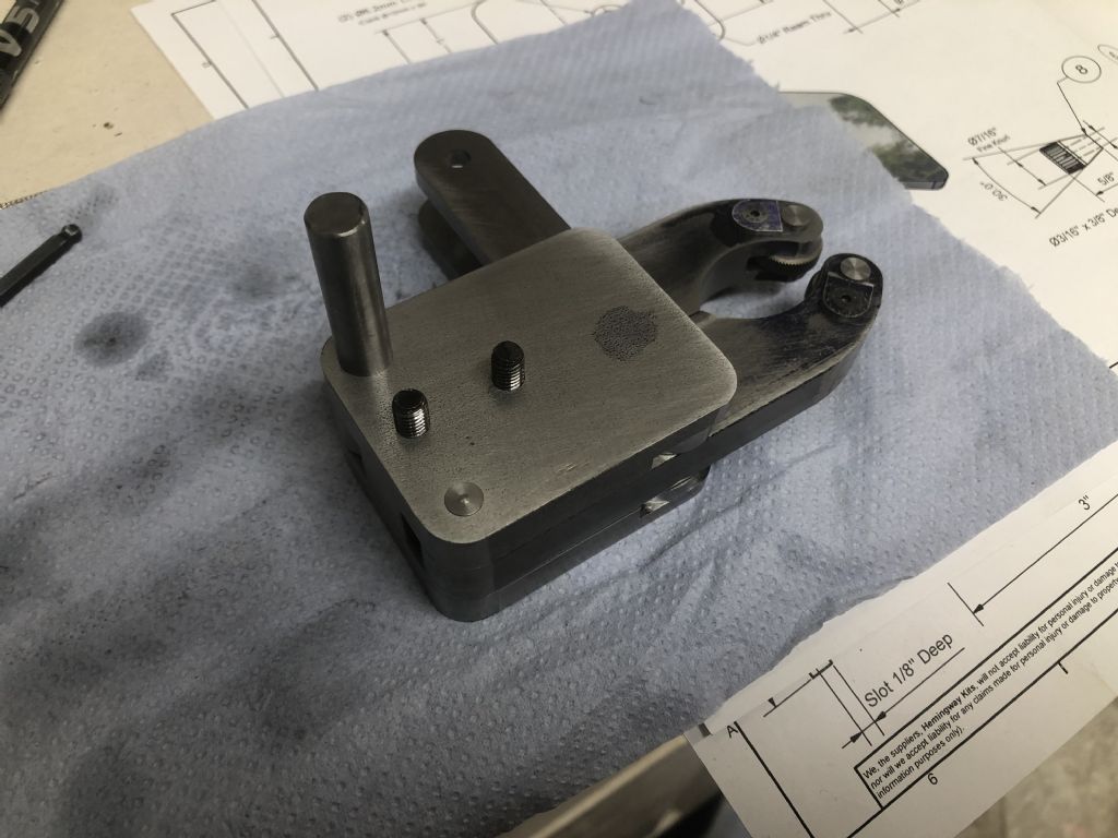

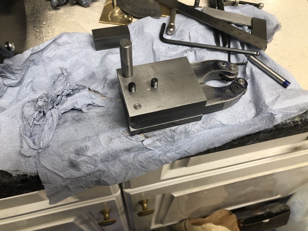

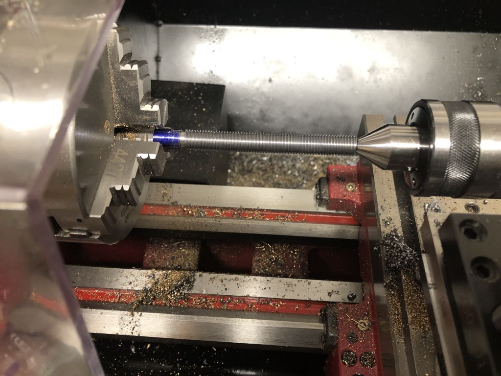

                      During the adverts of the Star Wars film tonight, I ran up the 3/8” BSF adjuster screw. Had to fit the 127 tooth change gear, I’m happy with how it turned out. First imperial thread cut and a die runs down it nicely.
                      Please excuse the state of the lathe. It needs a clean.
                      Cheers
                      Mark

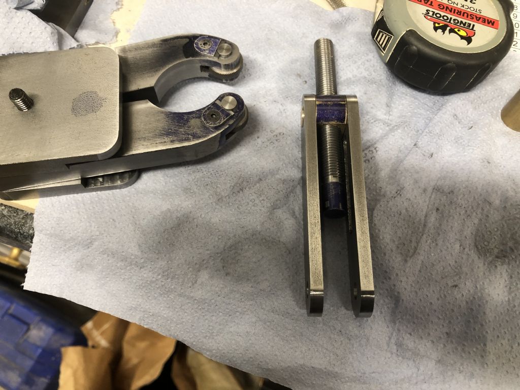

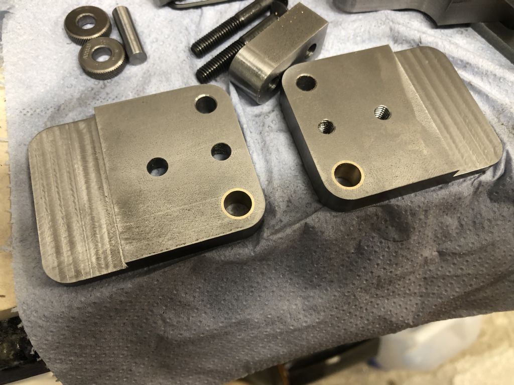

                              I got a bit more done this morning, starting with the adjuster nut. All went well, but what a nightmare to tap. I used a 3/8 BSF HSS tap, brass is not like tapping steel. I took it steady and it worked out ok.
                              Cheers

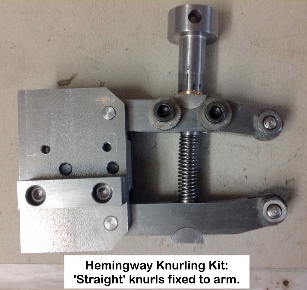

                              OuBallie
                                @ouballie
                                Excellent work Mark👏
                                Can recomment their kits.
                                Hemingway Knurling Kit
                                Geoff – Need to decide Workshop or Austin Seven?

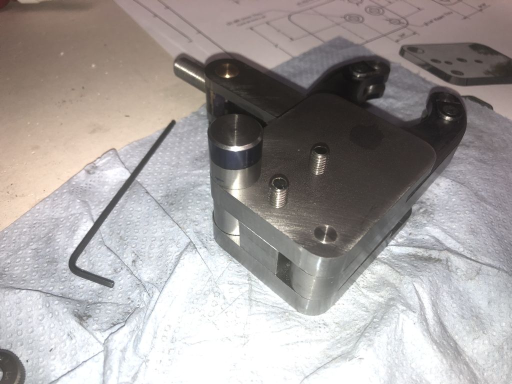

                                  Are they your spare knurls bolted to the sides near the adjusting screw?

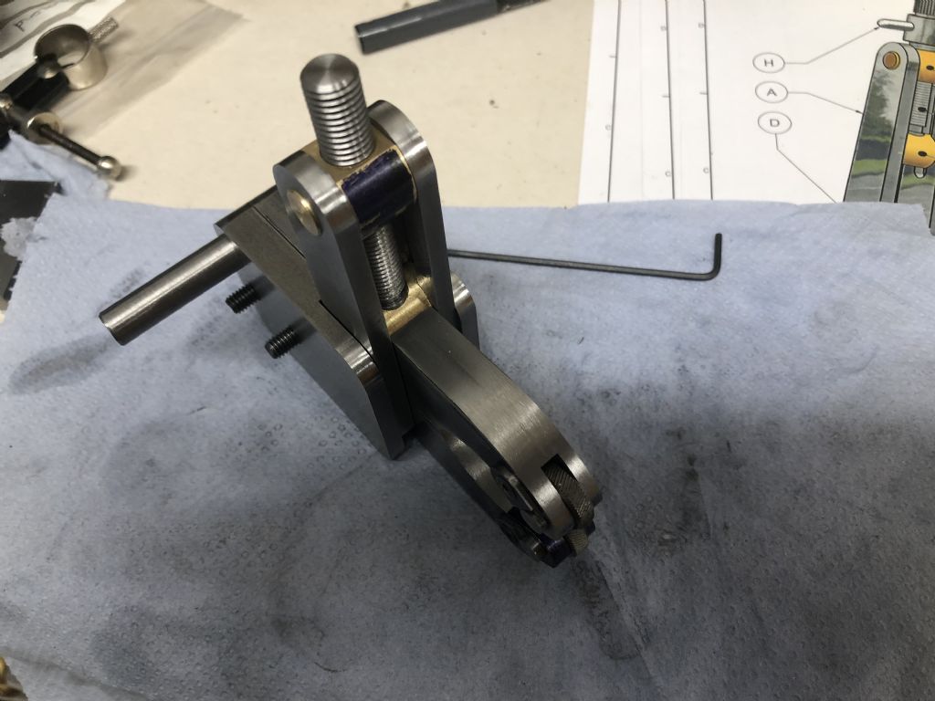

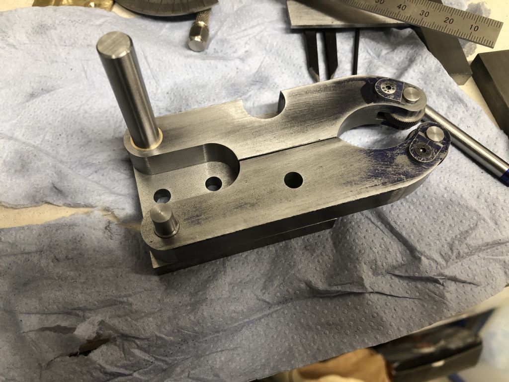

                                  First day back at work today, and thankfully, I got done early, so on with the project. I managed to get the trunnion milled into shape, it nearly broke my heart taking a stone to the new 3/8” drill to break the sharp cutting edges to drill brass, but as I’m all metric, I figured ‘it’s only an imperial drill, it’s not going to get much use’😂
                                  Tapping the small M4s was a joy compared with the 3/8 BSF
                                  It all works nicely, and I can run the adjuster by hand to both extents by just holding the threaded part. I’m happy with that as my first real fitting project.
                                  Cheers
                                  Mark

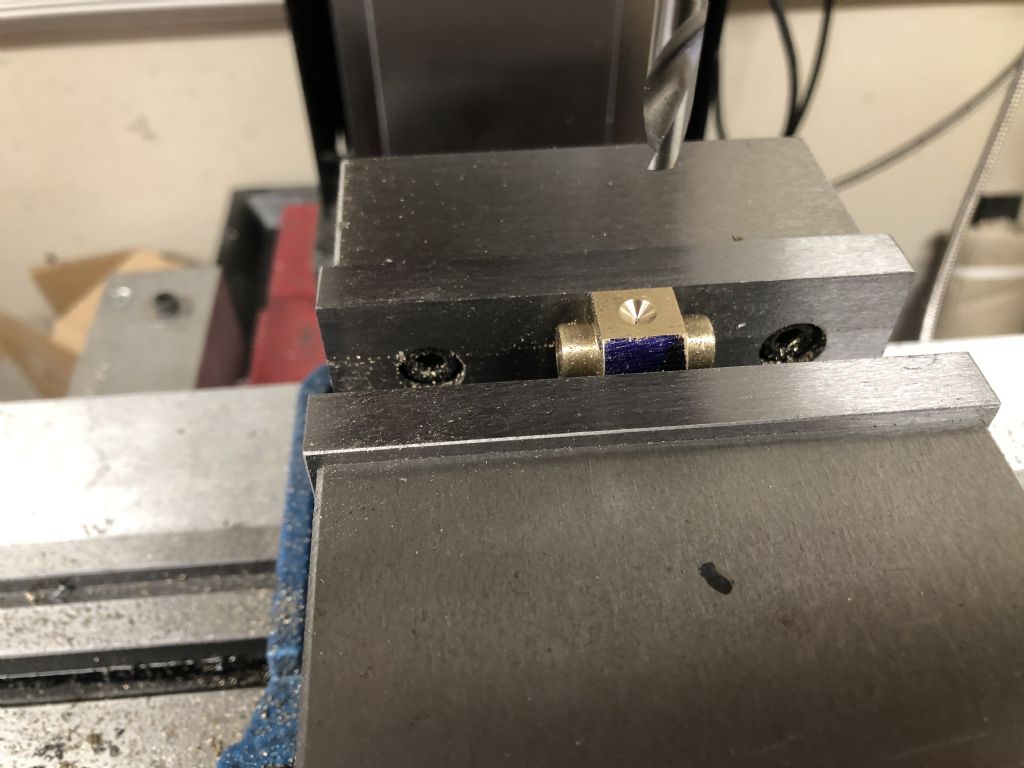

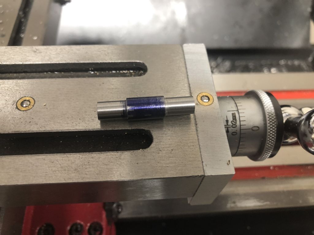

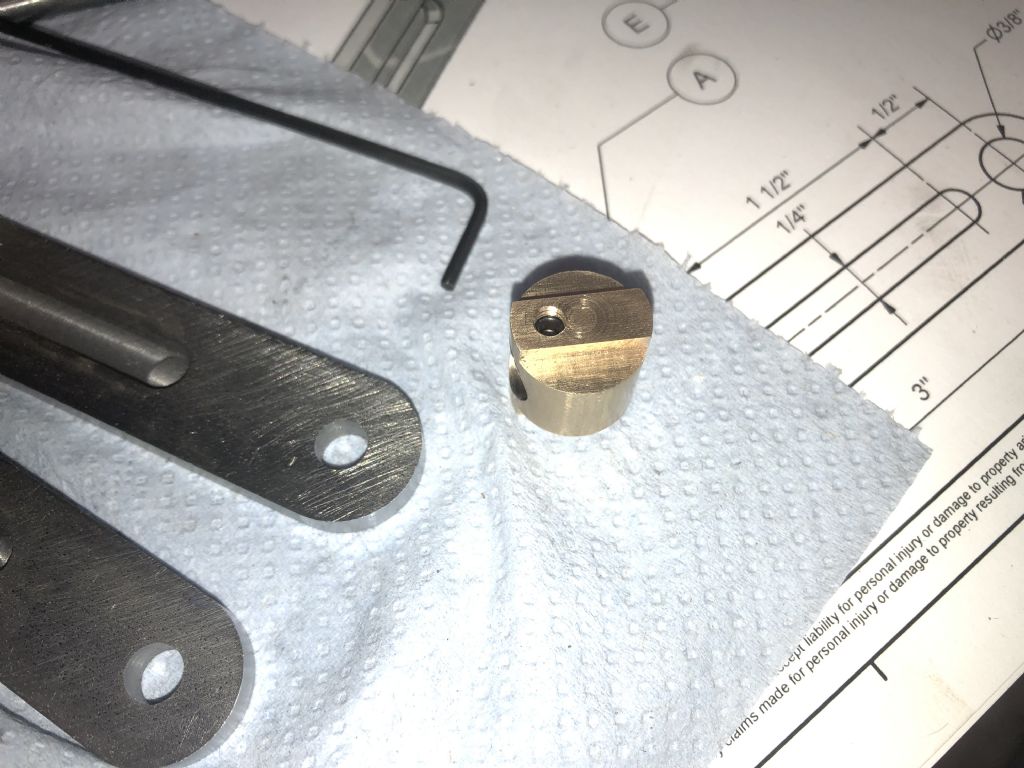

                                      I’m hoping so. Not had much time in the workshop this last few days. I did get an hour this morning and made a complete hash of the brass bearings. Got them drilled and reamed 5/16” then took the o/d down to 9.34mm – when I should have taken it to 9.54mm. Another lesson learned. At least I had some brass round stock to have another go at.
                                      I walked away from it this morning in disgust, this afternoon, I tried again successfully.
                                      They are a nice snug fit. Just a few little bits to machine up now to finish this.

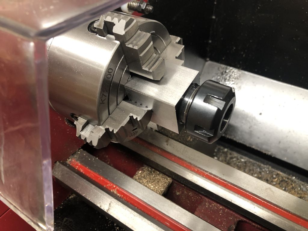

                                        I’ve made a start tonight on setting up to turn the offset on the upper pivot. I have set up the 4 jaw and am planning on holding the 3/8” silver steel in a Stevenson’s collet block to turn the long end. Plan is to then change to the collet Chuck to turn the other end. We will see how this works out…
                                        Cheers
                                        Mark
                                        #389863
                                        Mark Elen 1
                                          @markelen1
                                          A little bit more done today. The collet block worked a treat, cut the first end then changed to the collet Chuck to cut the other.
                                          Then made a start on the lever boss
                                          Cheers

                                          OuBallie
                                            @ouballie
                                            Mark,
                                            Somewhat lax in checking posts of late, sorry.
                                            Yes, they are the spare knurls bolted to the arm, it being the most convenient place I could thing of to put them.
                                            Geoff – Dusting time 😤
