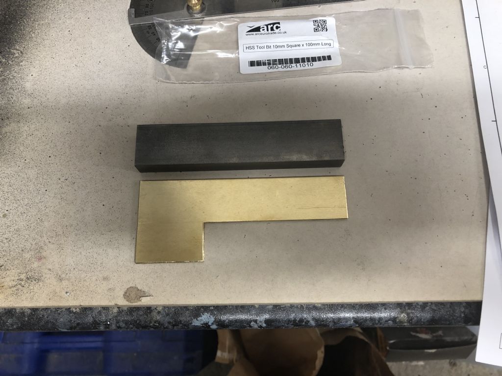

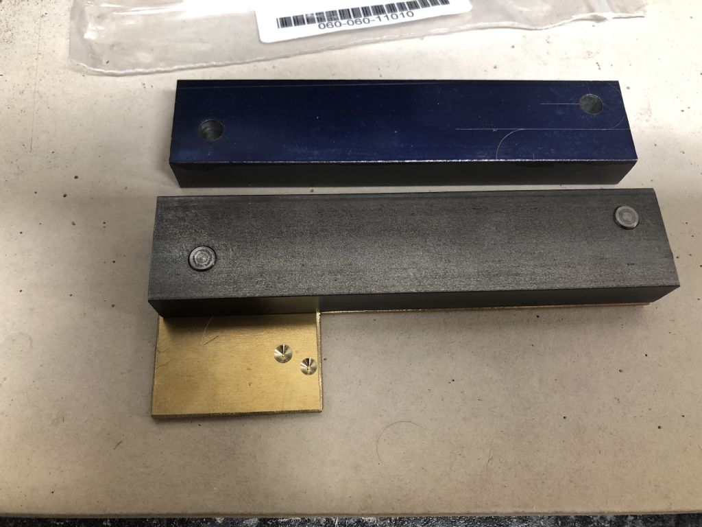

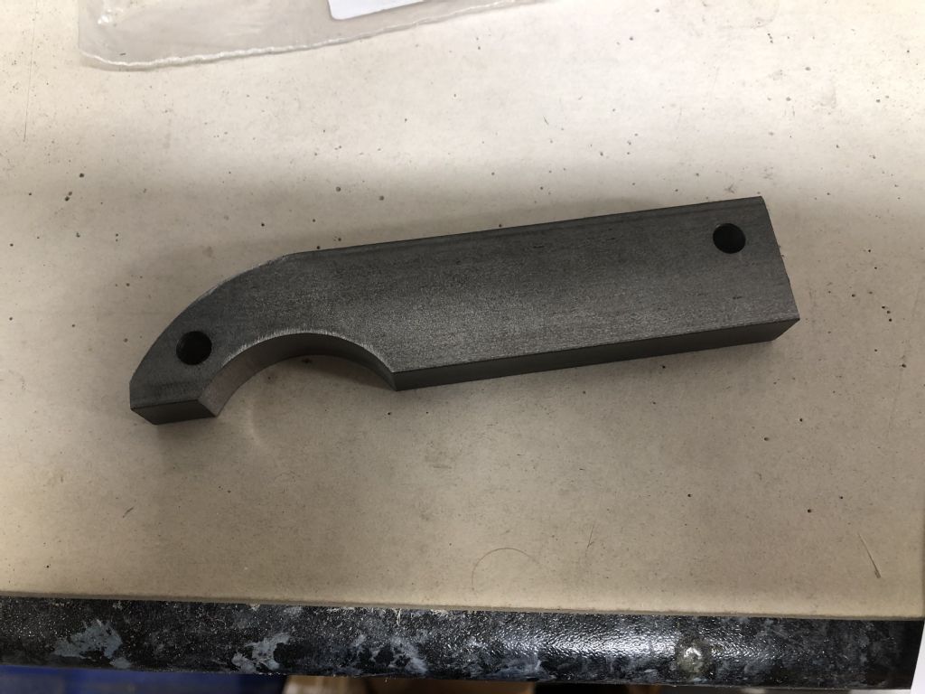

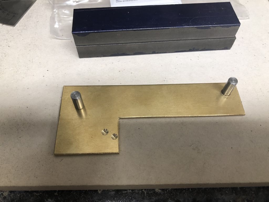

      I’ve gone off at a tangent with my hacksaw build to make another tool for use making the hacksaw. I need a knurling tool, so I thought I would make one.
      Now I’ve got the kit and the drawings, I’ve been busy working out sequencing. The first item on the list is the upper and lower arms from 1” x 1/2” BMS.
      There are 2 radius cuts to make on the ends of the arms where the wheels fit and I’m planning on milling these out on the rotary table. The only issue is that the centre of the radius is not within the material, so I’ve been busy pondering how to centre these on the table centre. I’ve come up with a plan to make a jig from a piece of 2mm brass that will both identify the centres and space the work up off the table.
      Tonight’s embryonic photo of said plate:
      Cheers
      Mark

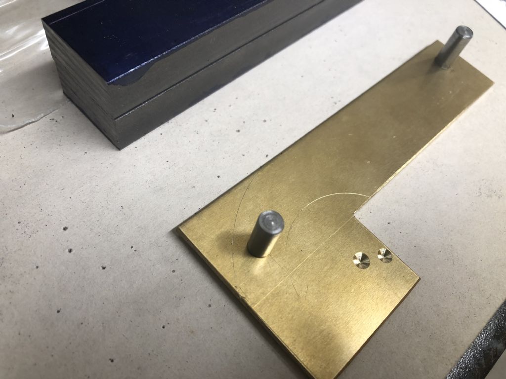

            Today I cracked on with the jig, made a couple of 6mm silver steel pins, drilled and tapped M4 and fixed to the jig with 10mm countersunk screws.
            I’ve marked out the centres of the offset radii using the dro.
            Cheers
            Mark

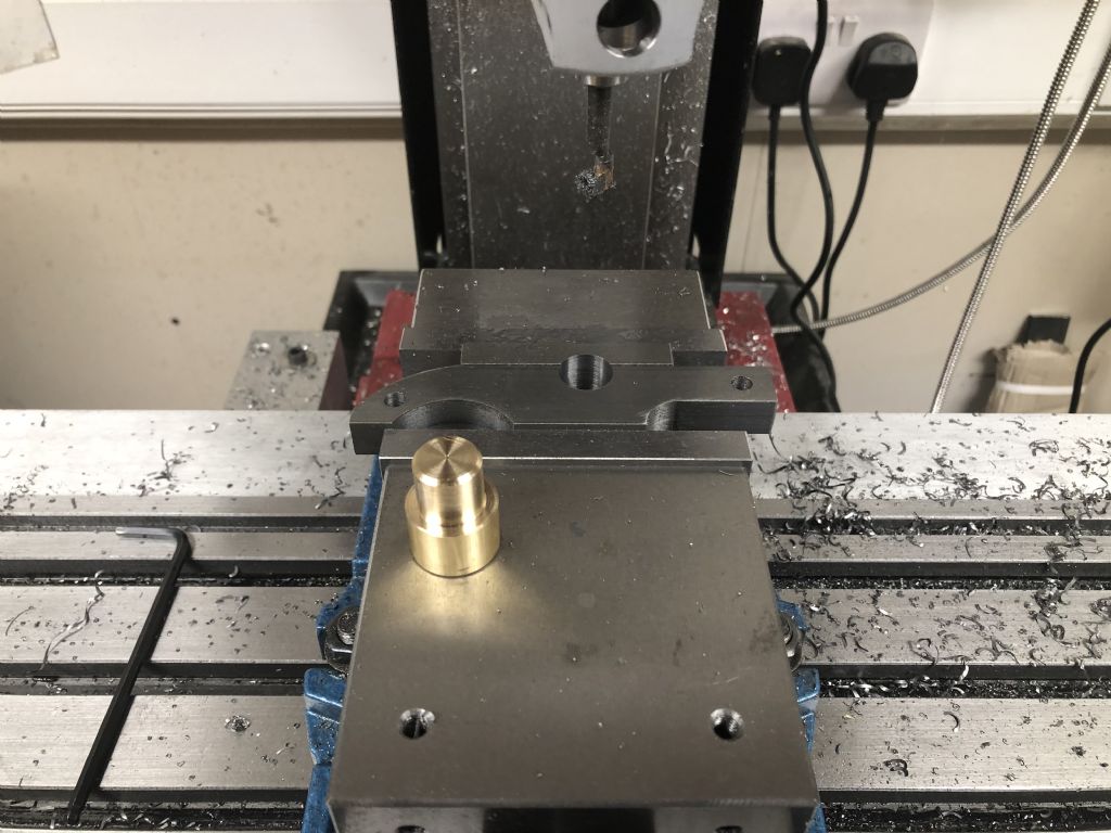

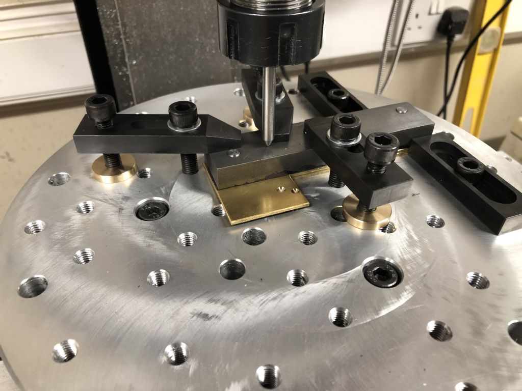

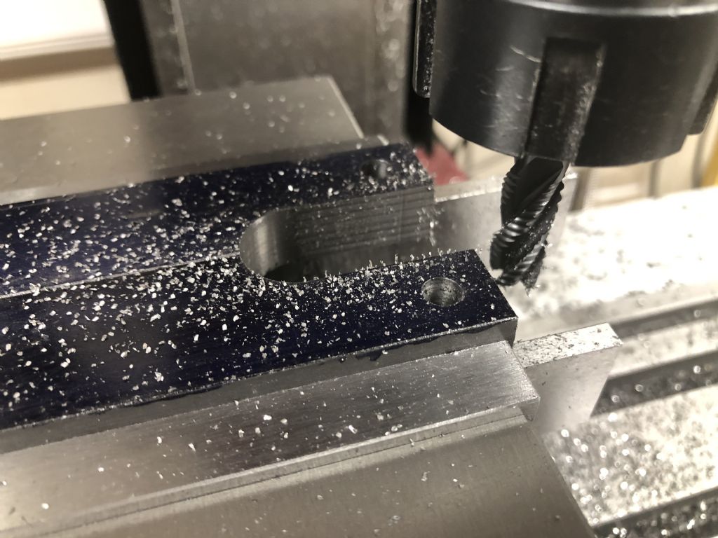

                      I have got all set up on the table and started milling out the ends of the arms:
                      I’m just nibbling .25mm at a time off as this is the first test of the fixture plate and clamping system.
                      Cheers
                      Mark

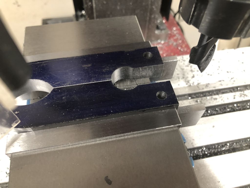

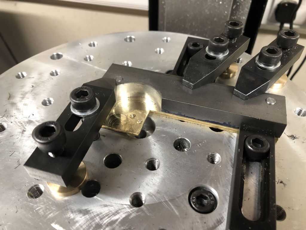

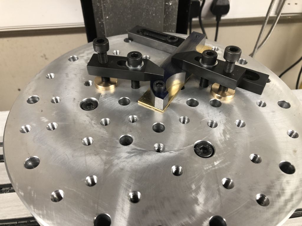

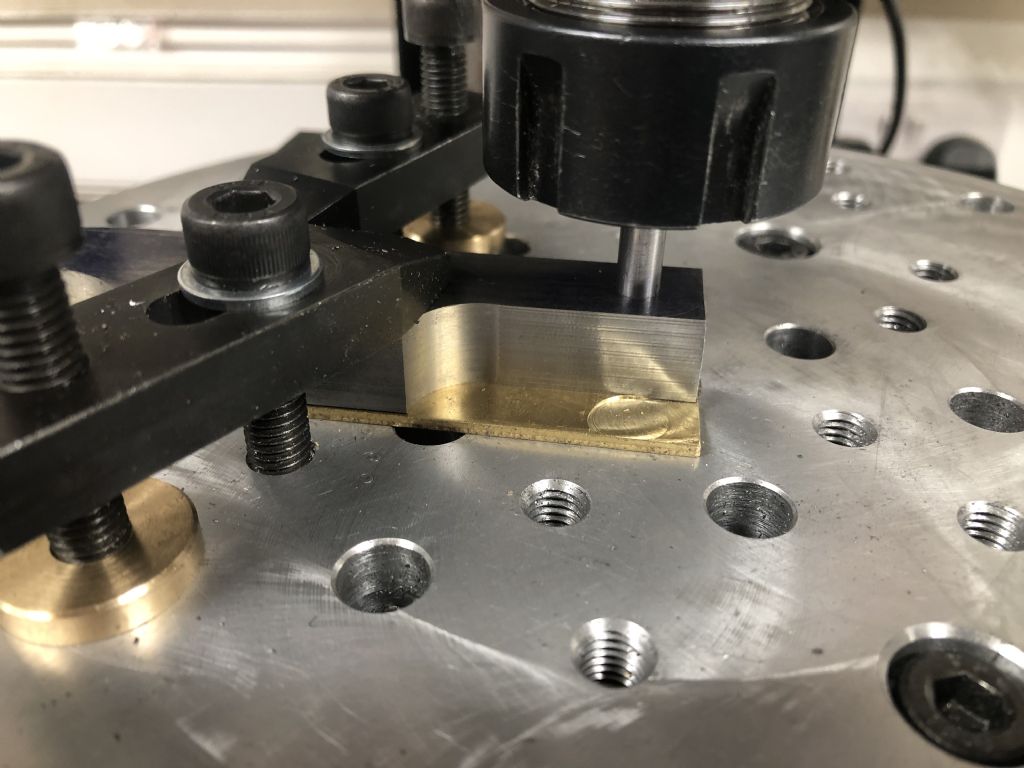

                      #384602
                      Mark Elen 1
                        @markelen1
                        Inside done, set up and milled the outside, I ended up taking 1mm at a time, the table seems secure, although, the backlash in the RT makes climb milling ‘interesting’. I ended up taking .1 mm climb with the table locks nipped down to finish off and it worked out ok.
                        Cheers
                        Mark

                          Mark Elen 1
                            @markelen1
                            Thanks lfoggy,

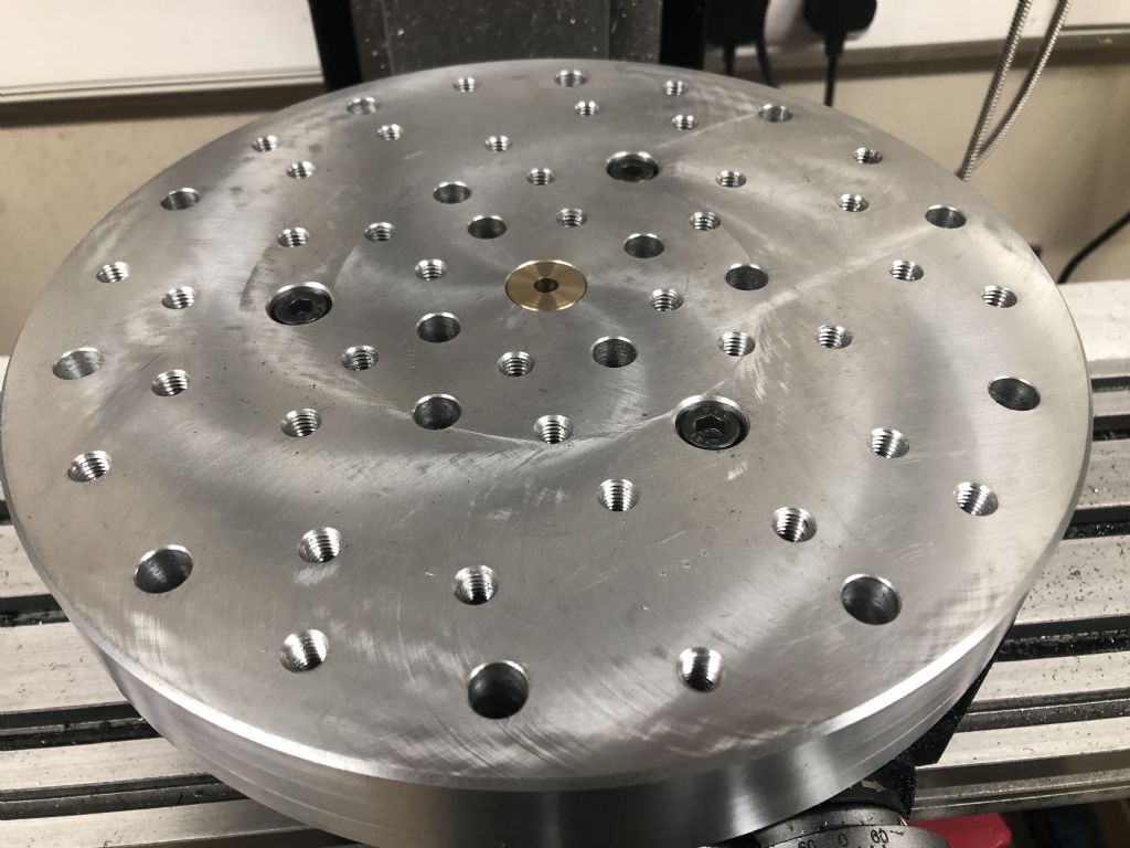

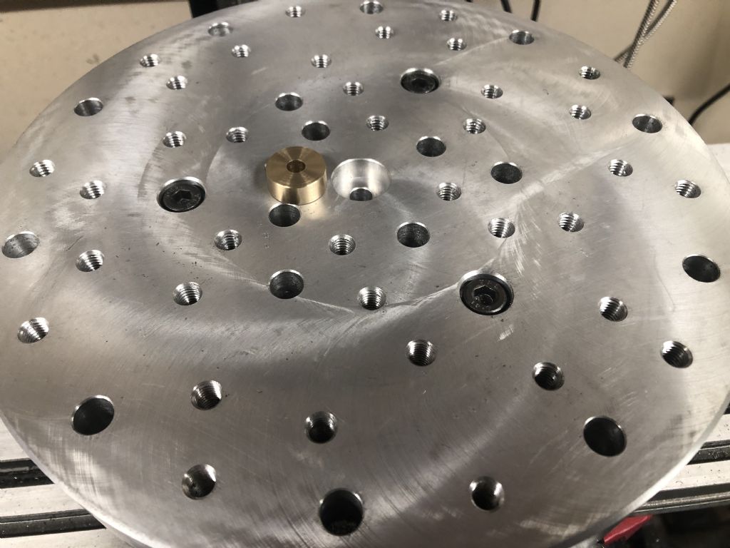

                            The sub-table is loosely based on Chris’ at Clickspring, see here:**LINK**
                            There are some build photos of my version of the sub-table on my hacksaw thread, starting here: **LINK**
                            As soon as I saw Chris using his, I knew it would get a lot of use if I made one.
                            Cheers
                            Mark

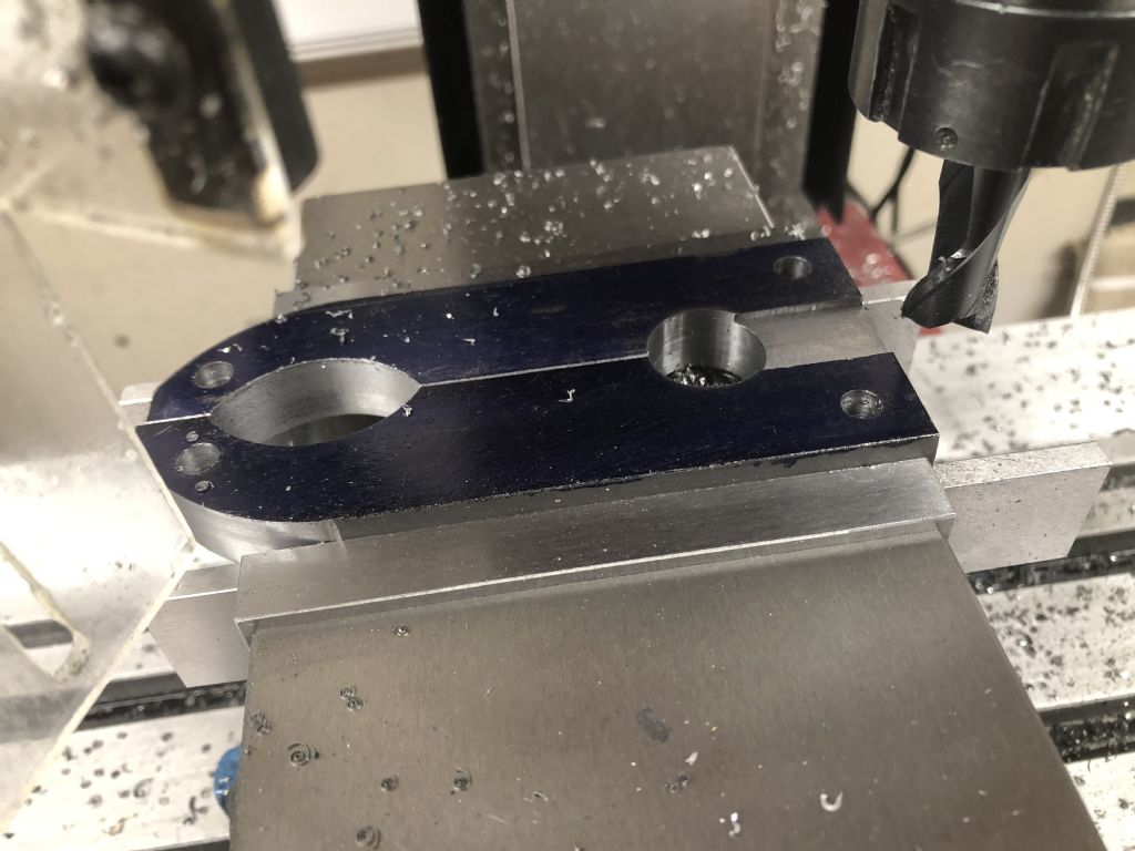

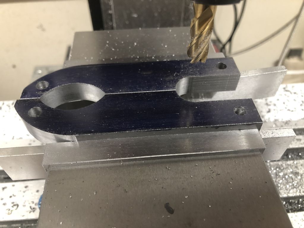

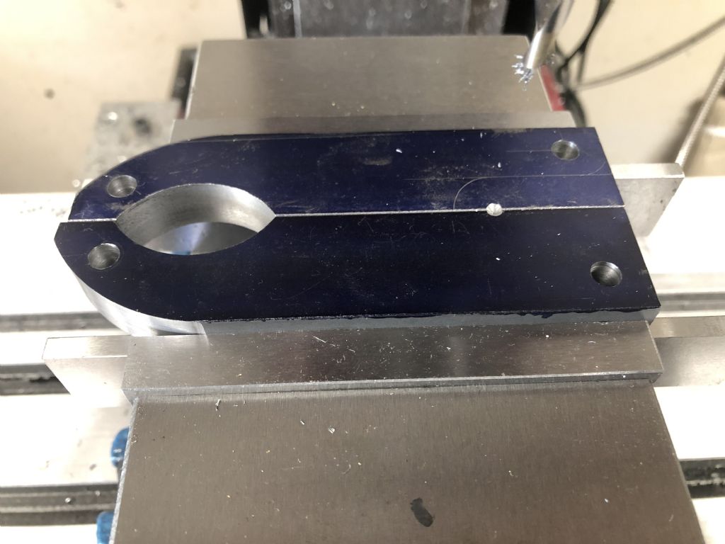

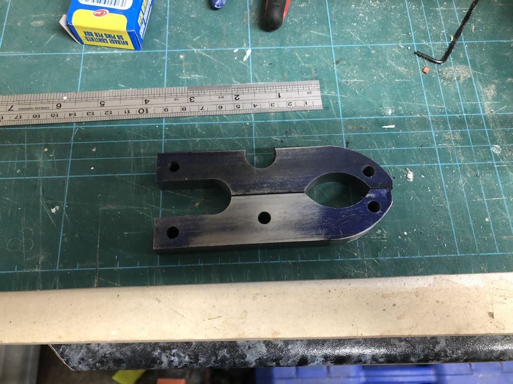

                                I got on this morning, made the other half and then got set back up in the vice to machine out the pivot ends. As they are both the same, I set both up together in the vice, used a piece of 6mm silver steel in the collet Chuck to register the pieces and confirm that they lined up correctly.
                                Still got a bit more to go with the boring head to get to dimension.
                                Cheers
                                Mark

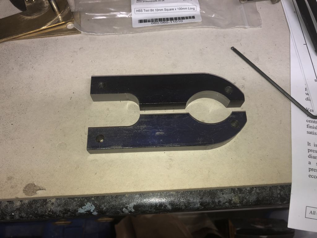

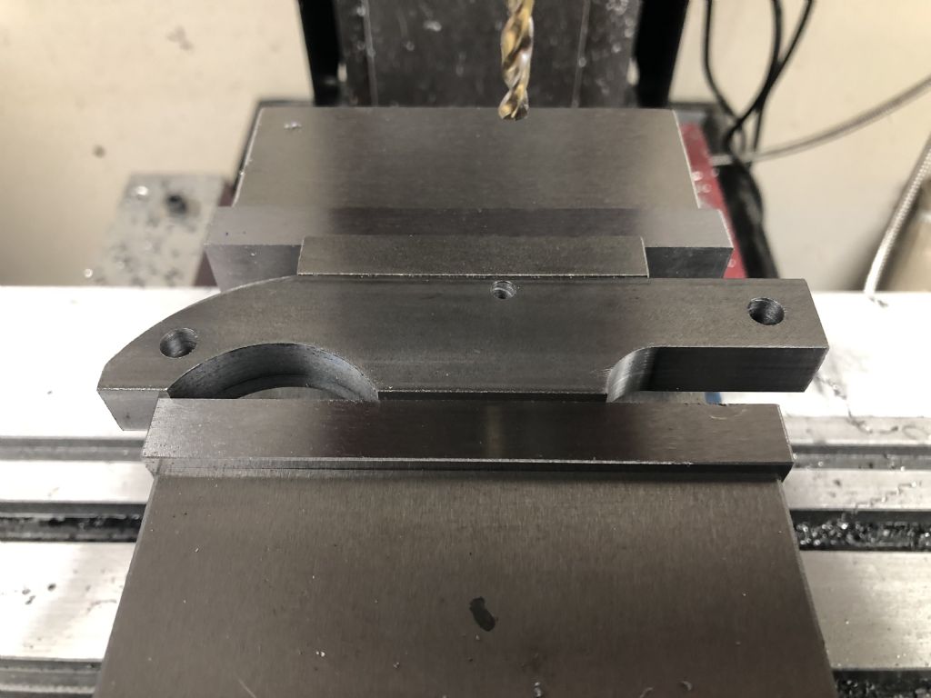

                                      I got the bore to final dimensions this afternoon, followed with a 14mm slot cutter, then I tried out a 10mm roughing end mill. Wow, that thing eats through it. I probably went a bit far with the rougher, I only left myself .1mm for a climb cut to finish with a standard end mill. There are still signs of the rougher in the finish. Never mind, every day is a school day.😂
                                      They still look a bit funny because one piece was about 2mm longer than the other before I started on them. I now need to set up the rotary table again to mill off the ends.
                                      Cheers
                                      Mark

                                        That fixture plate is a great idea. May make one myself. You need a big bit of metal to make this though. Why did you choose aluminum instead of steel? Lighter and easier to machine but may deform under clamping pressure? Clcikspring has used brass which seems extravagant !
                                        #384749
                                        Mark Elen 1
                                          @markelen1
                                          Hi lfoggy,
                                          To be honest, I used aluminium because I didn’t want to have to drill and tap 60 odd holes M8 in steel. My plate is 40mm thick, so I have blind tapped to 30mm. I was concerned about stripping threads, but it seems fairly durable, I’m sure time will tell.
                                          Chris used aluminium, because apparently, steel is hard to come by in Australia. If I was to make one in steel, it wouldn’t be 40mm thick, because, that plate of mine is heavy enough.
                                          I have done similar to Chris and machined a register in the middle and drilled and tapped the MT2 arbour that fits into the table M6.
                                          I expect that most of the time, in use, there will be a central hole that will be machined around, so it will do the majority of the clamping and the table will be more for location.
                                          Cheers
                                          Mark

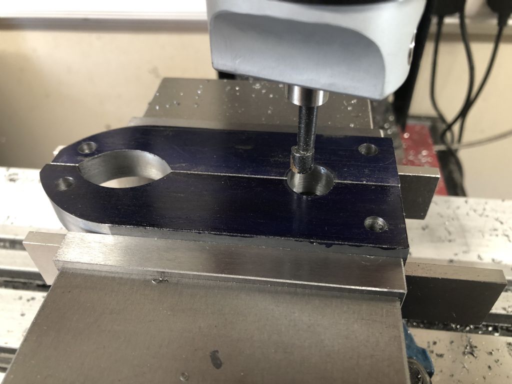

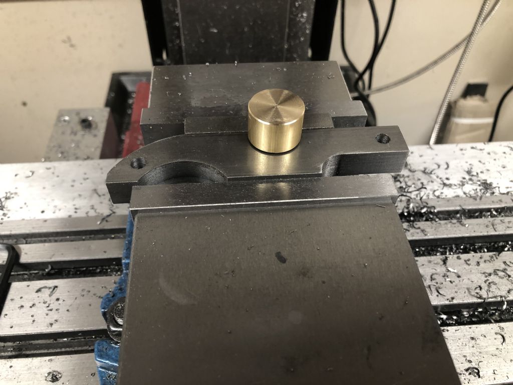

                                                After the success with boring the 5/8” hole between the 2 arms, today I decided to use a sacrificial piece of steel to bore the 5/8” hole on the top arm. I made up a 5/8” brass plug to gauge size. I really need to get a set of bore gauges.
                                                I also got the bottom arm drilled and reamed out 1/4”
                                                After using the bore gauge, i used part of it to make a centre for my fixture plate, just a plain centre, drilled and reamed 6mm for use on the next operation, rounding off the ends of the arms.
                                                Cheers
                                                Mark

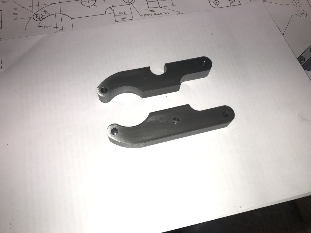

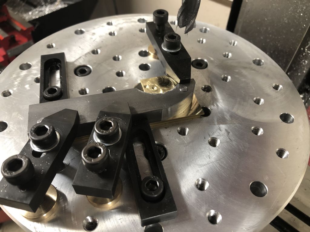

                                                    Tonight I’ve got all of the radiused ends done on both arms.
                                                    Here is my method of centering parts. I turned up a central spigot, as the locating holes in the arms were 6mm, it’s really just a 20mm extra thick washer reamed 6mm in the centre. I also turned up a 6mm silver steel rod with a point.
                                                    With the part free to move and the pointer chucked up in a collet, the pointer was fed through and located in the spigot, then the arm was clamped down and a 6mm screw is fed through the centre of the table and threads into the MT2 stub arbour that the sub-plate locates on.
                                                    It all worked a treat and I’m happy with the results.
                                                    Cheers
                                                    Mark
