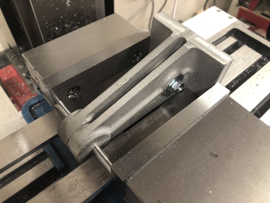

            Busy day today. Been to the midlands exhibition and bought a rotary table. Got home, marked out one of the 1/8” steel brackets, squared off the end and drilled it out. I now need to make some sort of mounting bracket to get it on the table to mill off the excess and round off the end.
            It’s a bit of an extravagance, I could easily file it off, but I’m like a kid in a sweety shop when tools are involved.

              I guess ETW expected people to hook the bow around the table of a drilling machine and support it directly below where you are drilling.
              #376549
              Mark Elen 1
                @markelen1
                Hi Neil,
                You are more likely correct. The instructions call for filing most of the parts to shape, even the slide ways in the bow. I’m using this project as a learning process and also as a means to build up my workshop.
                One of the reasons for buying the rotary table was because I’ve got all of the bits for the CNC Arduino conversion in MEW a year or so ago. I can see a use for that in the future. I got the stepper and Arduino wired up a few weeks ago and tested out, now I need to make up the ‘mechanical interface’ (if it’s anything like this project, it’s 5 years away)😂

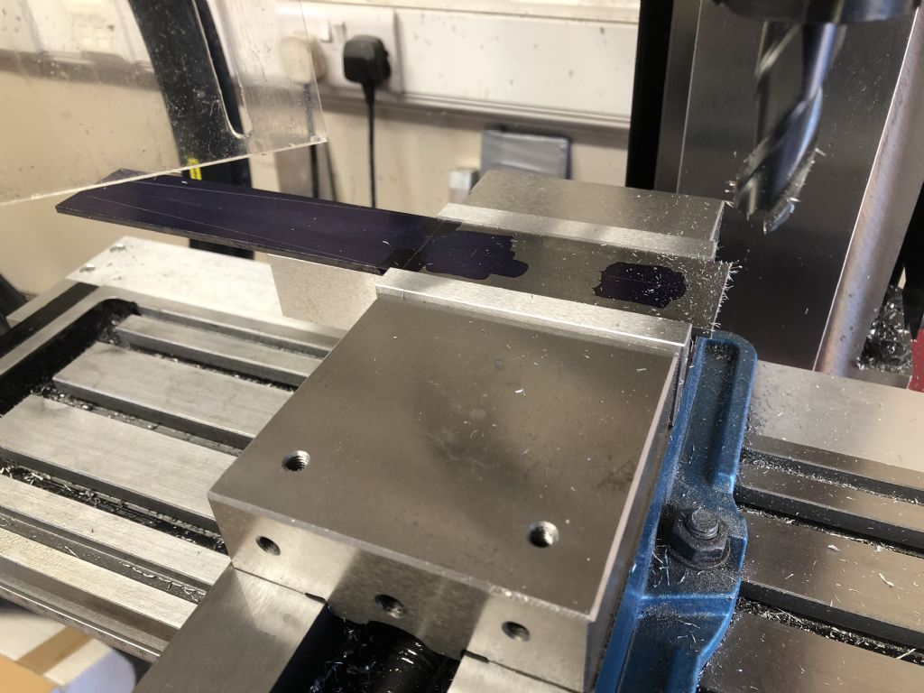

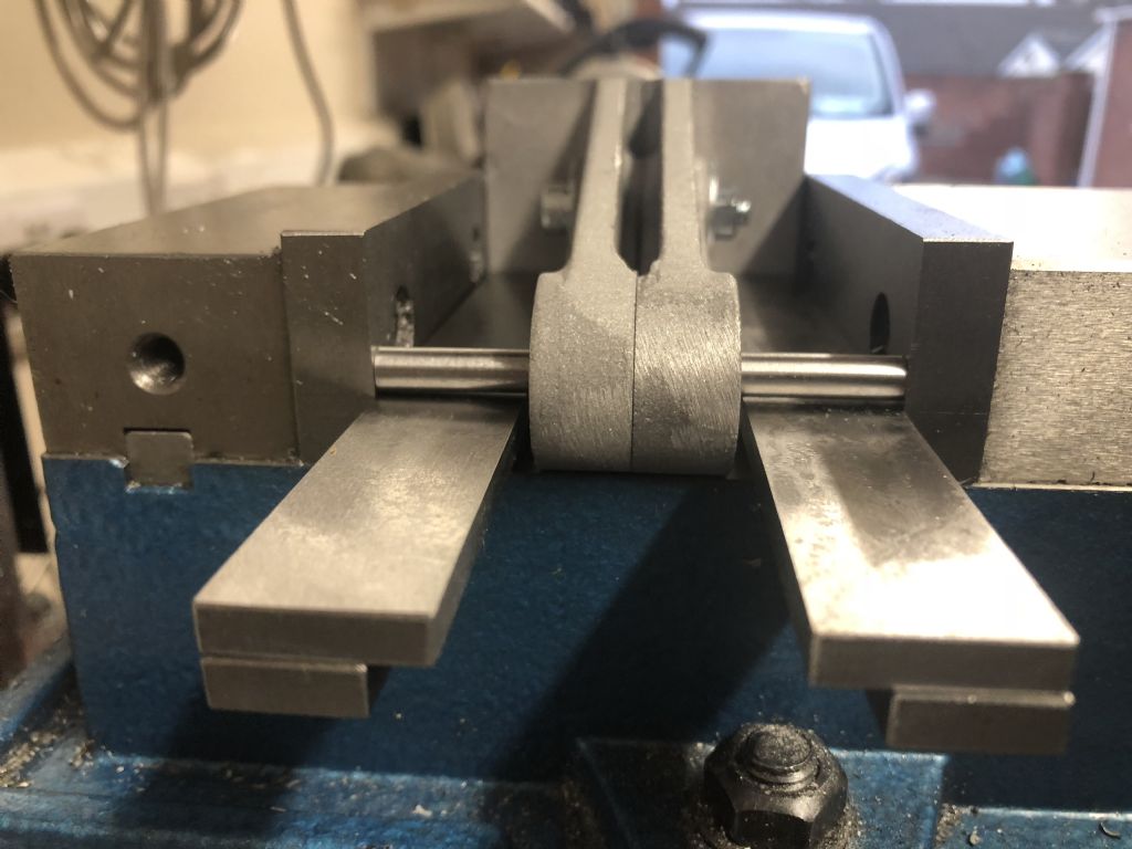

                  As per usual, buying new tools makes it necessary to make new tooling. I got the rotary table, then it became apparent I was going to have to hold things down to it. I haven’t got any t-nuts that fit the table, so I’m going to have to make some.
                  I toyed with the idea of holding the arm on a sacrificial piece of Ali, but I’m not happy it would be secure, so I’m going to make a ‘rotary table fixture plate’ similar to the one Chris has made at Clickspring. **LINK**
                  While I’m waiting for the billet to arrive, I got started making up some clamps
                  That came to a stop as I haven’t got a 2 flute slot drill.

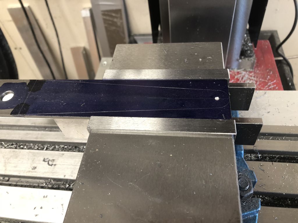

                        Neil, I just need to slot out between the two holes on the right of the photo. I’ve reamed them out 8mm so just need to take out the chunk in the middle.
                        Cheers
                        Mark
                        #377017
                          Posted by Mark Elen 1 on 21/10/2018 20:44:57:
                          Hi Gents,
                          Thanks Jim👍
                          Cheers
                          Mark
                          Any cutter 8mm diameter or smaller shoudl manage that

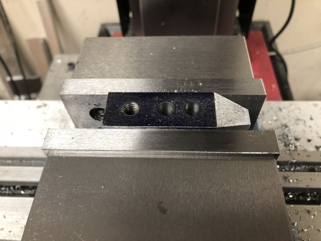

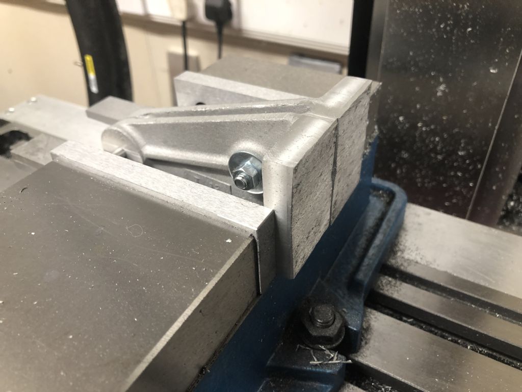

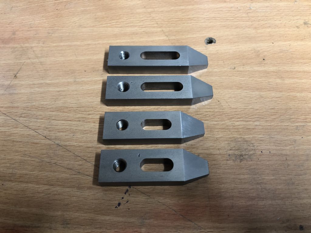

                            Called in at Leicester today as I was working just around the corner. Picked up a 8mm 2 flute slot drill.
                            Got home and slotted the first clamp out, filed and polished, then proceeded to drop it on the concrete floor and mark it.😬
                            I’m thinking of oil blacking these when they are all done. 5 more to do, another the same length as this, 2 off, 10mm longer with 10mm longer slots and 2 off 20mm longer.

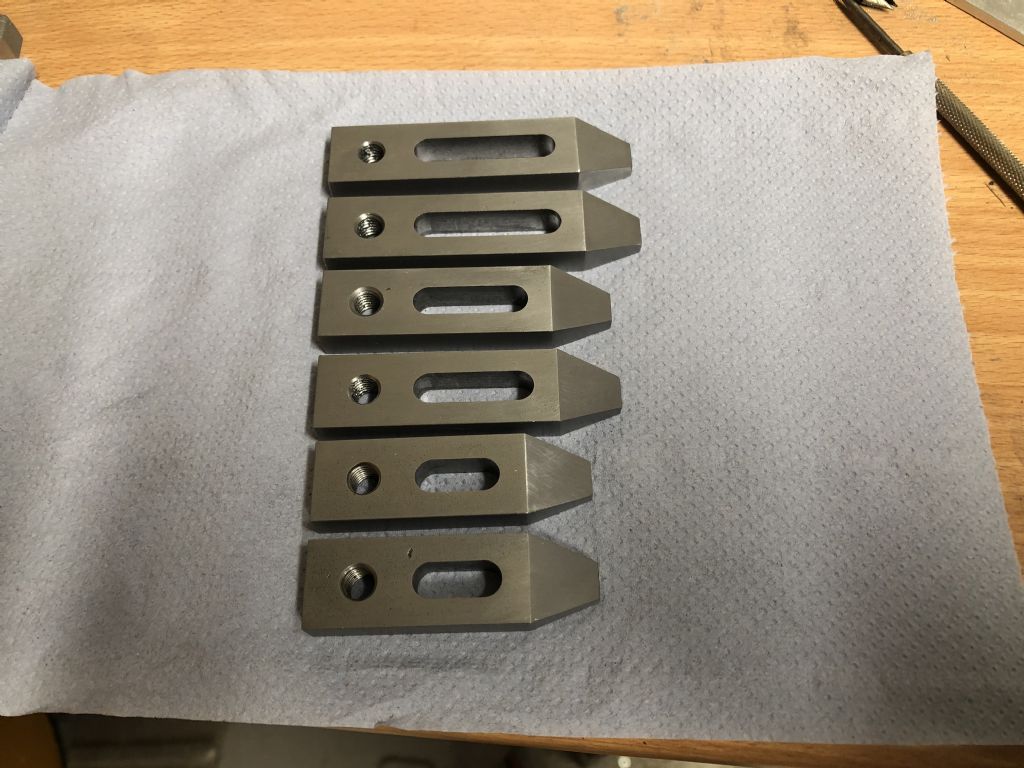

                              The clamping kit is coming along. 4 clamps done, 2 to go, but I’ve run out of 20mm x 10mm stock. I changed my mind about oil blacking these and ordered some Birchwood Casey Perma Blue after seeing Tubal Cain using it on YouTube.
                              Cheers

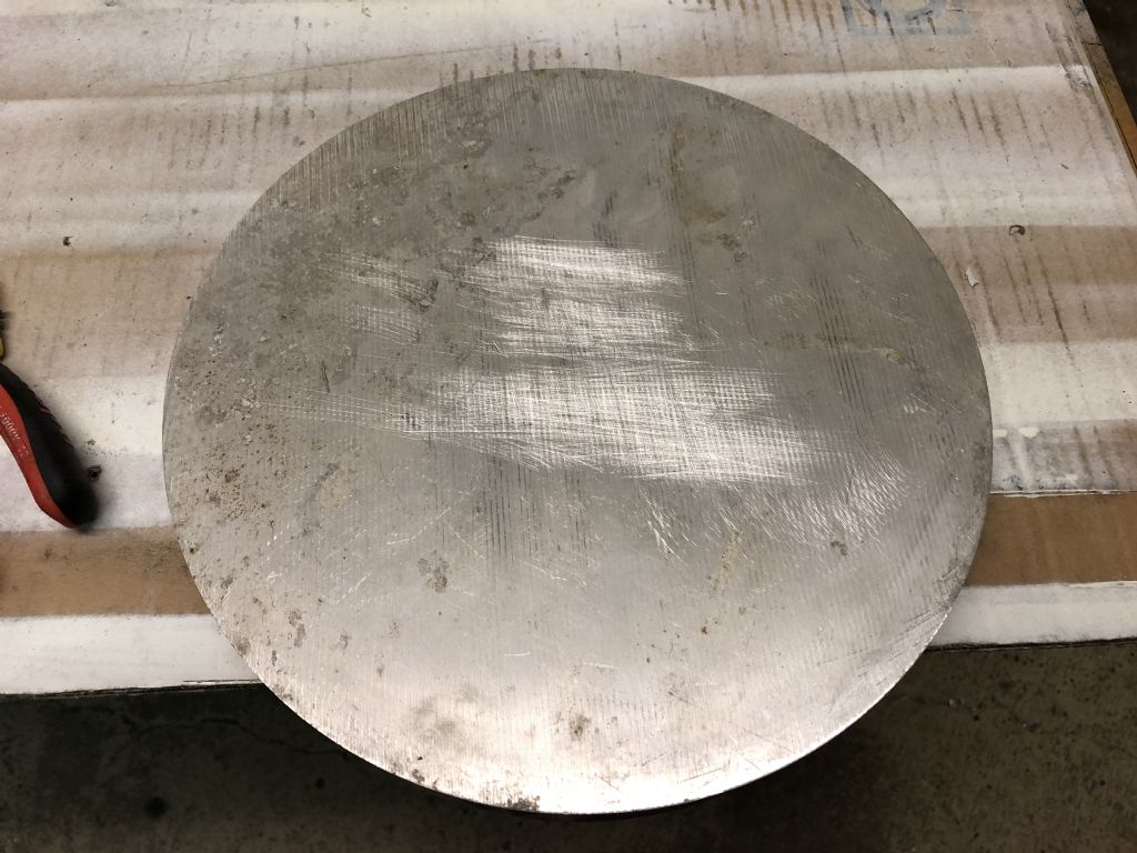

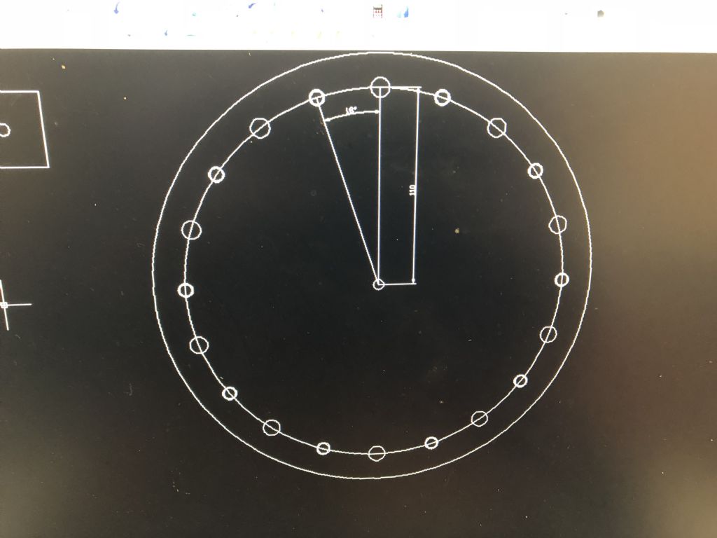

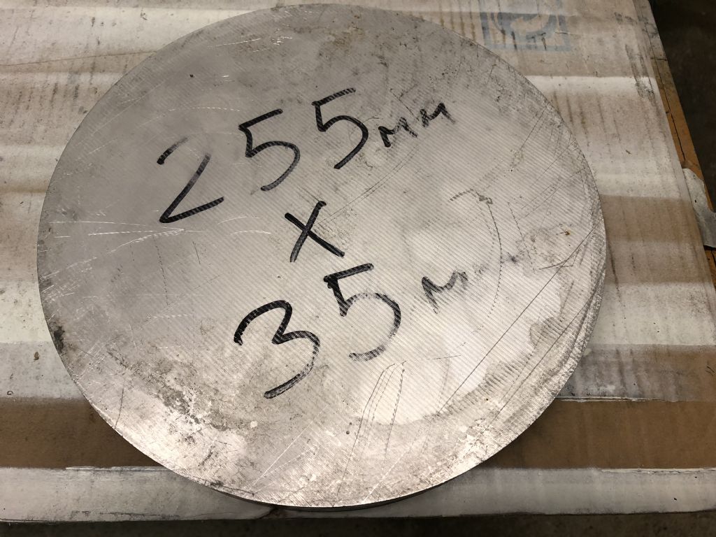

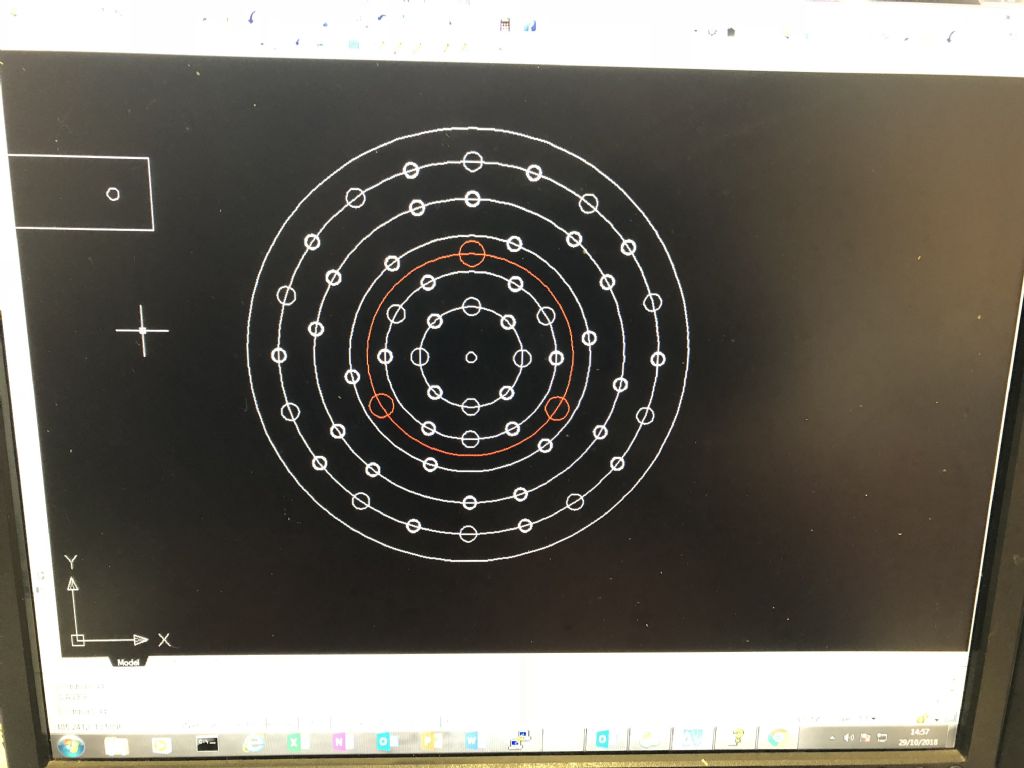

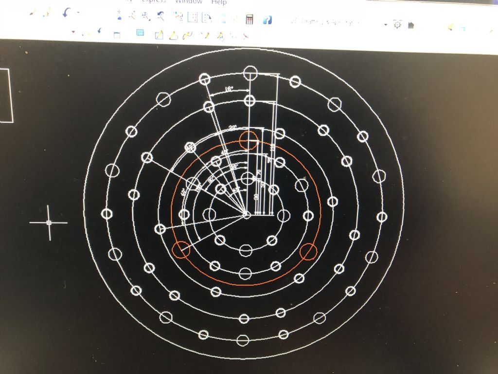

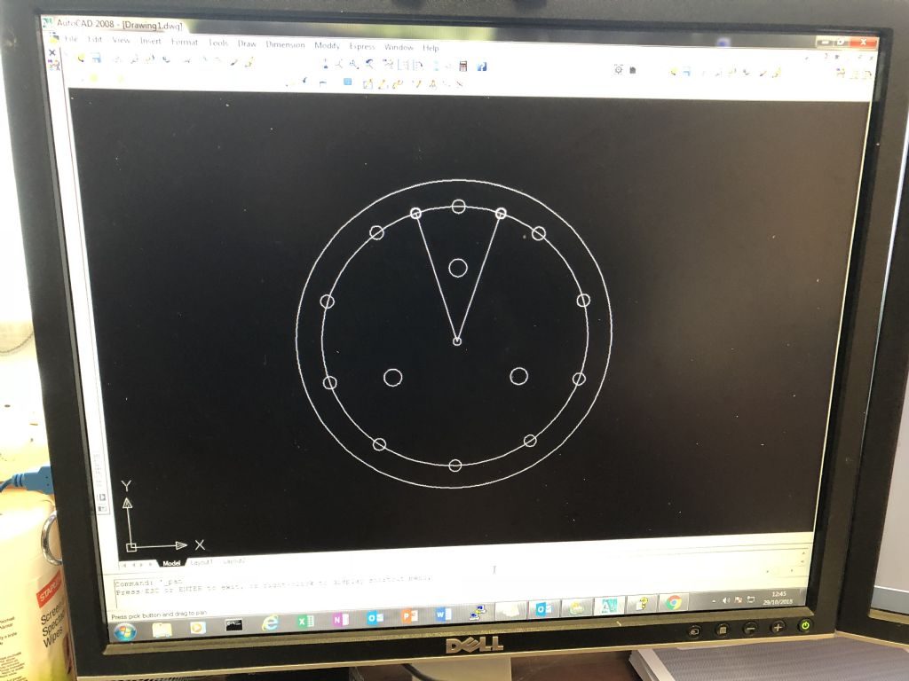

                                    I spent a little time today drawing out the hole layout for the fixture plate. Drew it out in Autocad, and layered up each PCD with its relevant dimensions.
                                    Here's the billet
                                    it just needs a quick facing up and then loads of holes to drill and tap.
                                    The plan is to print out each PCD with its dimensions as a separate sheet, that way I can set it up on the rotary table and work on each separately.
                                    I just need to finish off the clamps and t-nuts, then I can get the Rotary Table on the mill and crack on with this.

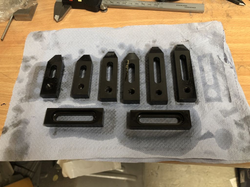

                                      Not much more to do on this, then I can get back on topic. I managed to get the clamps blacked today, this is them, covered in slide way oil.
                                      I’m really happy with how they have turned out.

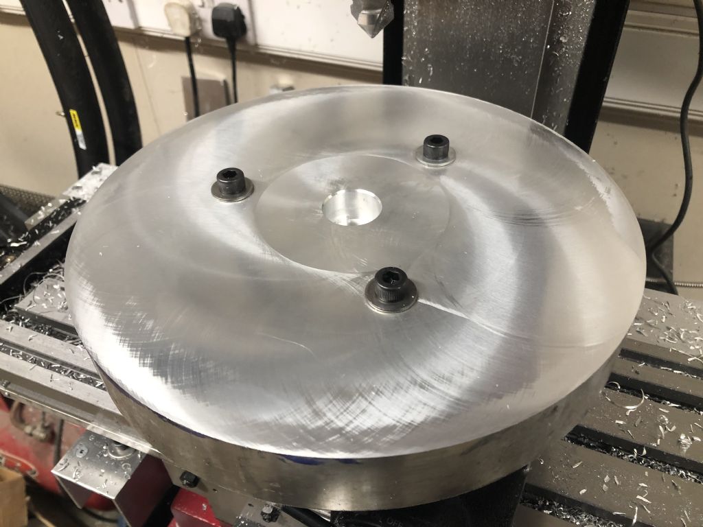

                                        I made a start today on the ‘rotary table sub-plate’, it’s a shame None of the table t-slots line up with 0 degrees. One of them is 4 degrees out.
                                        I made up 3 temporary M4 t-nuts and drilled out at 4, 124 and 244 degrees, and counterbored M4. The plan is now to turn over the plate, counterbore the fixing holes, fly cut the bottom, then the holes can be opened up to 8mm for the final fixings.
                                        Once the holes are opened up, I can bolt it down and mill out a spigot on the bottom to accept the MT2 blank arbour that will locate the table.

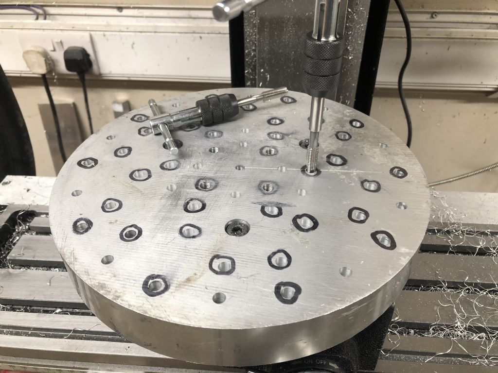

                                            Still tap, tap, tapping away. 38 holes to tap M8, taper and plug. At least the square drives on the taps fit 2 different tap wrenches.
                                            Holes spotted
                                            All holes drilled 6.7mm. Because the mill hasn’t got a depth stop, I raised the head so that full quill extension drilled the holes 25 mm. Another job to get around to is to make a depth stop. I marked up the holes that need tapping, all of the others will be drilled then reamed 10 mm to accept dowel pins for location.
                                            More tapping
                                            Nearly there. I’m looking forward to using this.

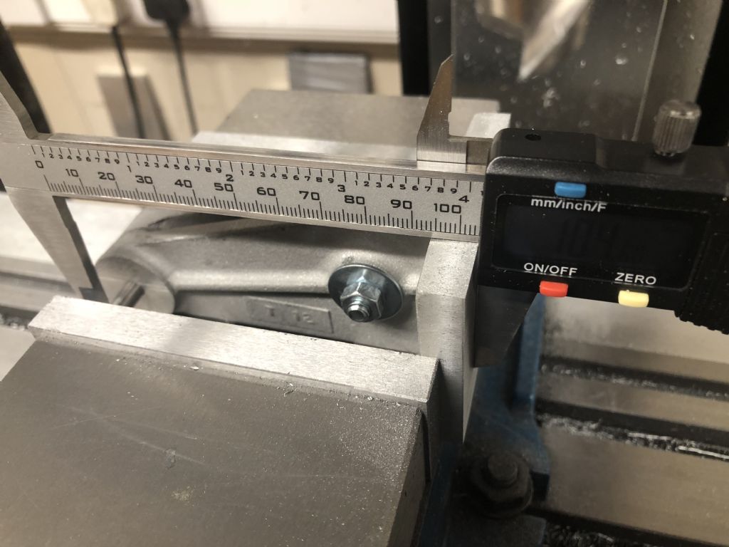

                                                Things all came to a grinding halt today. I finished tapping out all of the fixing holes, then I drilled out all of the ‘dowel holes’ to 9.7 mm and reamed out the first one to 10mm. Unfortunately, the 10mm dowel pins don’t fit.
                                                The shank of a 10mm drill fits perfectly, but when I checked with my callipers, it is 9.95mm, the dowel pins are 10.05mm.
                                                Now I have a 10.2mm drill, but I don’t want them being a sloppy fit, and, I’m not paying £40 for a 10.1mm reamer,so I’ve ordered a 10.1mm drill and it will ‘have to do’.
                                                I don’t want to tear down my setup to work on anything else and have to zero it all back in, so I’m stuck to waiting for the drill to turn up.

                                                  Before you open up your 10mm reamed holes, can I suggest using 10mm round bar for the pins instead of the dowel pins.
                                                  Regards
                                                  Vince
                                                  #380154
                                                  Vincent Cutajar
                                                    @vincentcutajar96446
                                                    Use stainless steel round bar for the pins. I forgot to mention that in the above reply.

                                                      Make your own dowl pins Mark .
