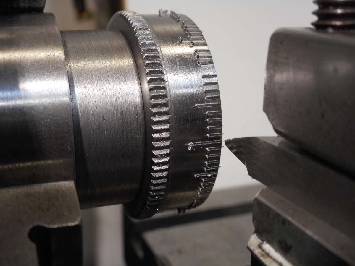

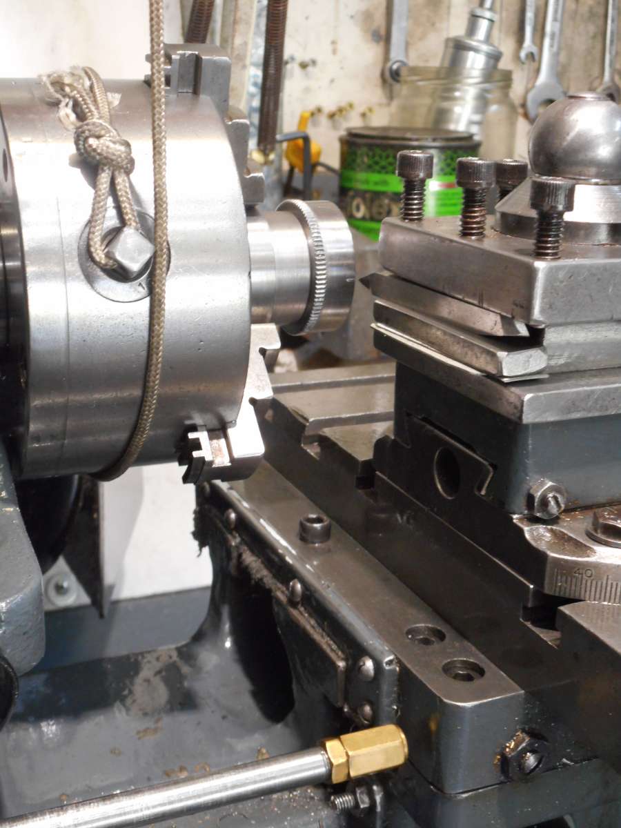

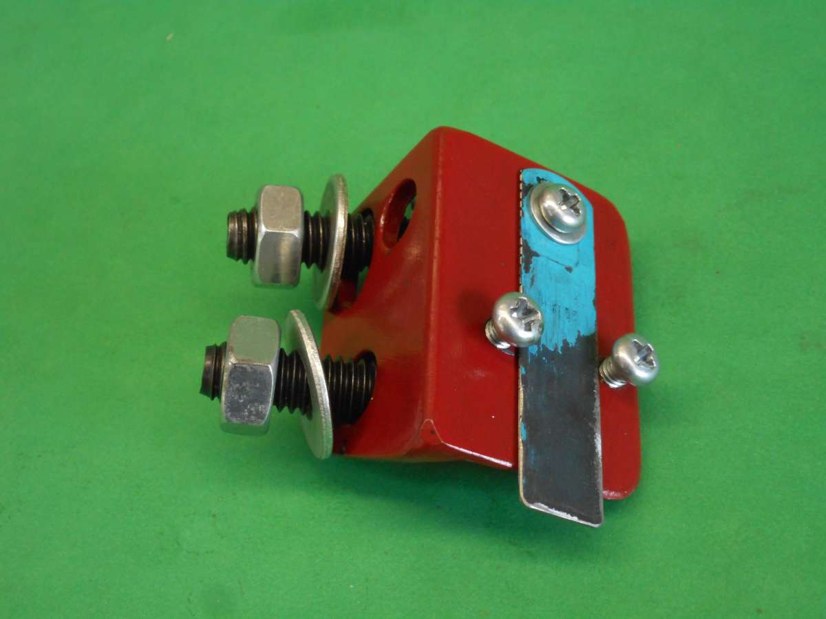

                          Couple pics of my hacksaw blade detent/ratchet. A piece of cord around the chuck and up and over pulley with a weight attached helps keep the gear teeth hard up against the detent in a constant position.
                          Photo 8 Resettable Dials
                          Photo 9 Resettable Dials
                          Photo 10 Resettable Dials
                          Engraving the first of the medium length lines on the second time around the circle after leaving blank spots every 5th click of the detent.
                          Photo 14 Resettable Dials
                          Followed by another lap to do the long lines.

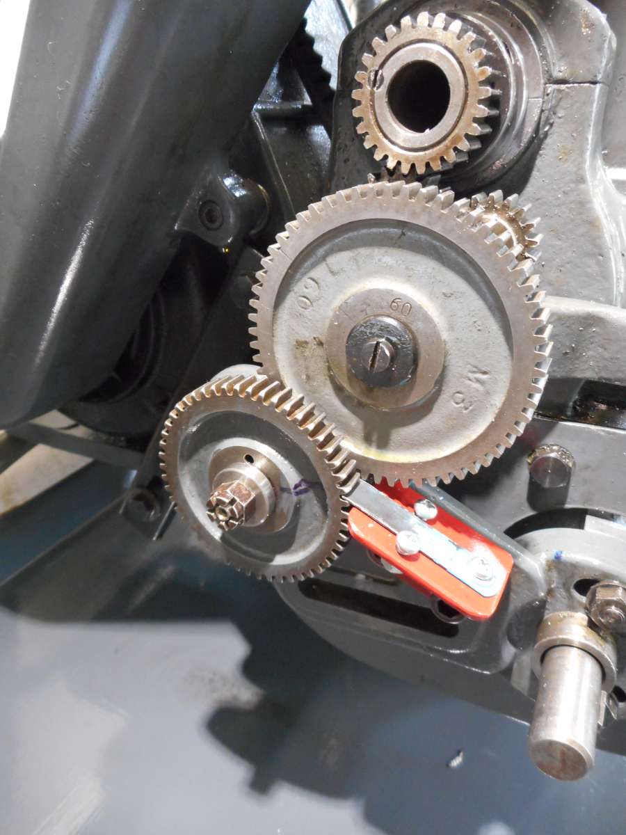

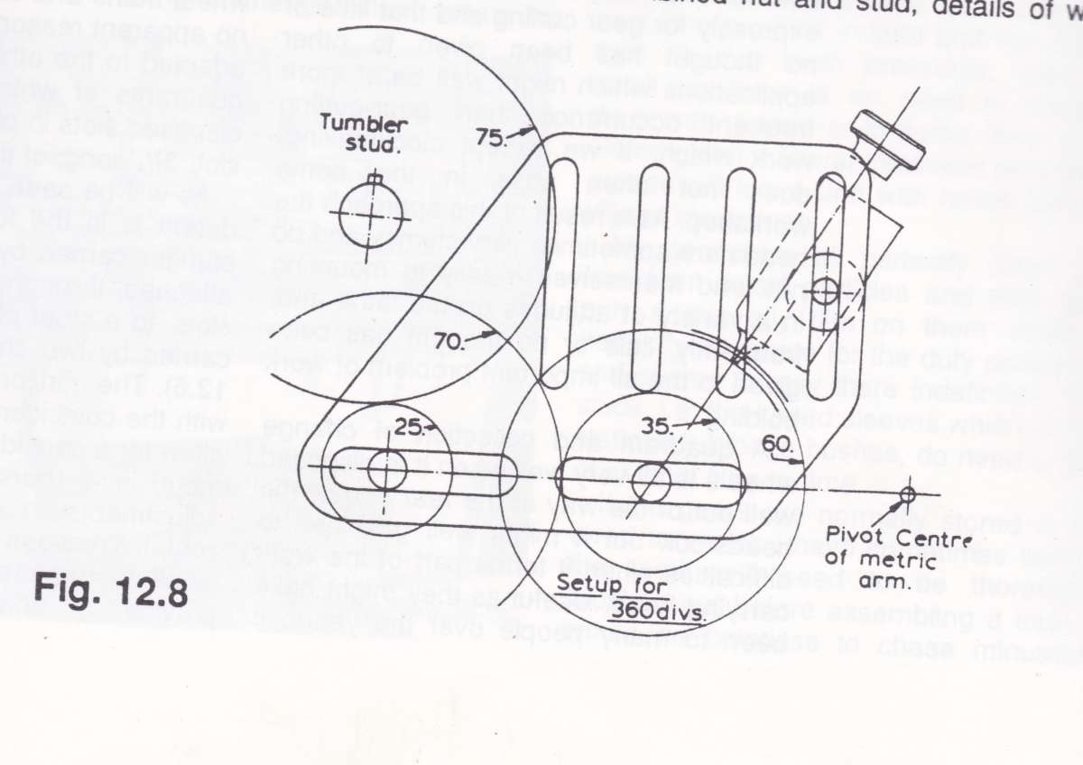

                                  The above pic I posted earlier shows the gear train for doing 100 divisions, using the 50T as the indexing gear engaging with the hacksaw blade detente. The 60T above it is part of the 2:1 gear train (60/30) used to get the 50T to rotate twice for each spindle revolution, giving 100 divisions on the finished dial.
                                  The gear train for 360 degrees will look like this below. Not sure if it can be replicated on the standard Myford banjo but I think it probably can. Otherwise there were some suggested other gear combinations posted above that could be used also. This one uses the 60T as the indexing gear with the plunger and then a combination of 2:1 and 3:1 gearing to achieve the required 6:1 to make the 60T rotate 6 turns for every one turn of the headstock spindle. Clear as mud? Good!
                                  60T gear train for 360 divisions

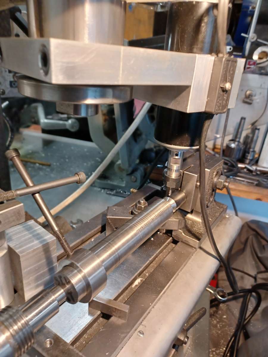

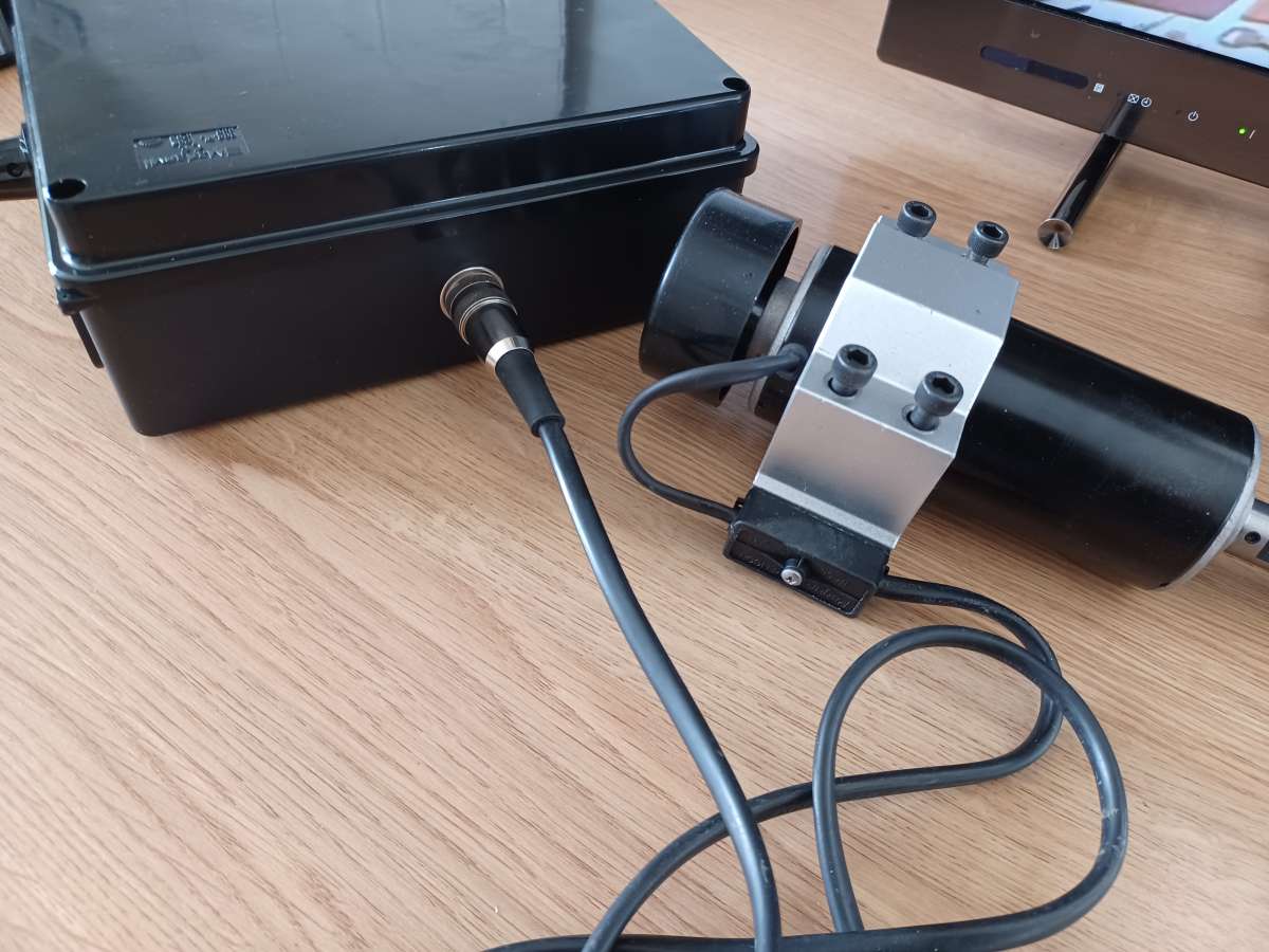

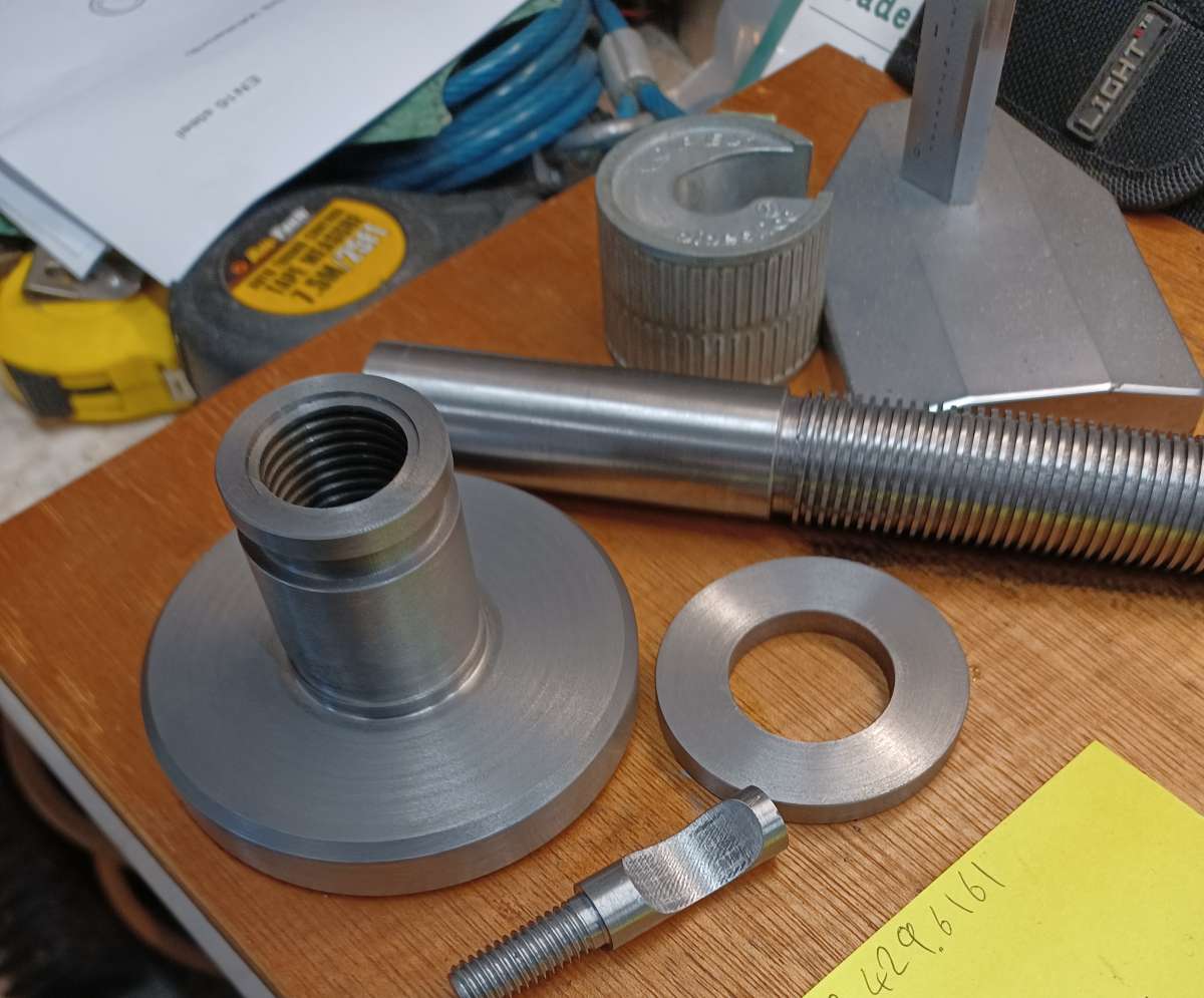

                                    i made a clamp piece to hold a high speed spindle with ER collets from china. This fits on to my mill as when i used my mill at high speed for a long time it soon got too hot and risked damaging the motor. I can now mount jobs onto the dividing head or between centers and still use the DRO on my mill to engrave items like a new tailstock or dial with little problem.
                                    20220310_20325920230205_223041
                                    20220717_122022
                                    David

                                      Nice setup there David. Yes, I think if I were looking at engraving 360 marks, presumably on multiple dials on a universal tool & cutter grinder etc, I would be looking seriously at some kind of engraving spindle like that. Cheap as chips from old mate Ali and do a tidier job than the sideways V lathe tool I used. It leaves a burr on each and every line that has to be removed afterwards.

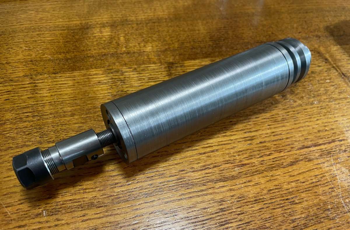

                                                  Using a spindle tail gear train on my 1921 Drummond M was my first response, though I did build Harold Hall’s basic dividing head a few years back. However I haven’t got around to arranging a good way to fit it to the lathe bed whilst using the Duplex keyway cutting set up – which occupies the whole saddle and slides.
                                                  But I have made a grinding spindle to successfully regrind my 3 jaw chuck to c0.002” run out!
                                                  Maybe I should investigate your suggestion….

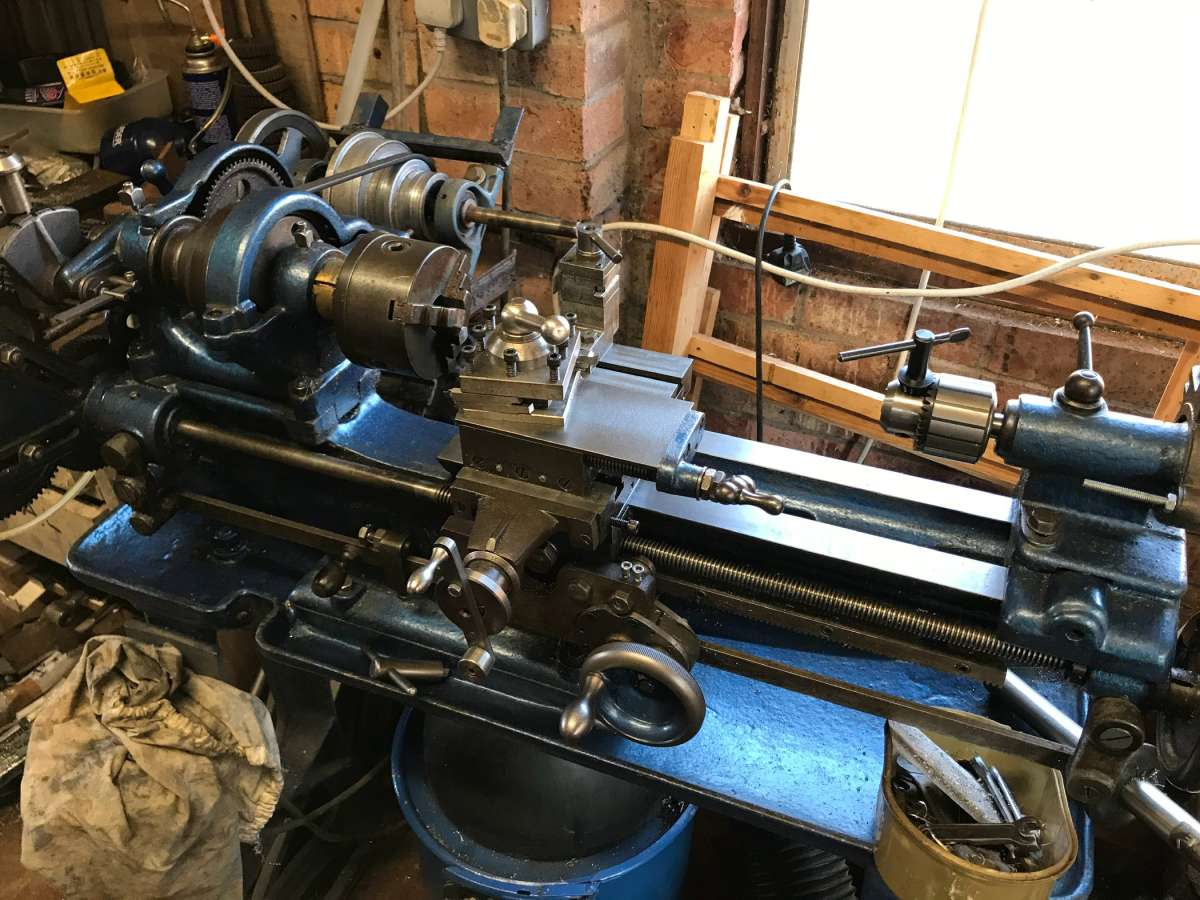

                                                    My Drummond 3

                                                      Grinding Spindle 5 copy
