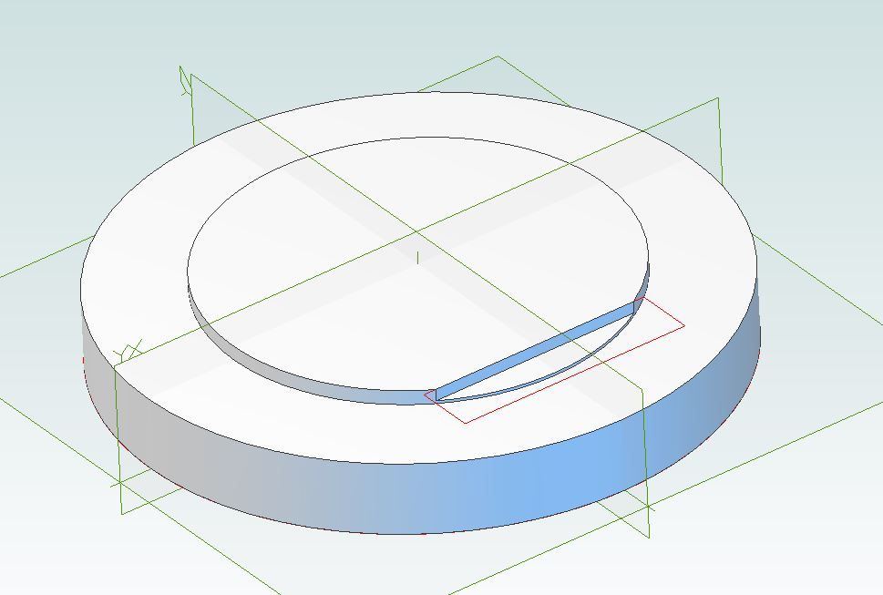

            Hi I have just about completed the first tried on air the other day could not get it to work at all, reset the timing nothing tried timing again 180 degrees nothing. Went back to it today working my way through how it should work following the air route.
            I have not cut the top of the cylinder to meet up with the port hole, so when you put the cylinder caps on no air could get to the piston. I now remember I did not have a small end mill to cut this I was to order one , guess who forgot, carried on the build.
            End mill now on order. Will let you know if and when it runs ( No I should say WHEN it runs)

              If you ca't wait for the cutter then you don't really need anything special, just a cut across the spigot to remove a small amount of metal will do

                Hi Jim Thanks for your kind comment and interest in the Mill engine. As for the air passage as Jason said it doesn't have be to fussy as long as their is a way through for the air it will work you could just use a small file or even a small chisel to make the passage..
                Stew
