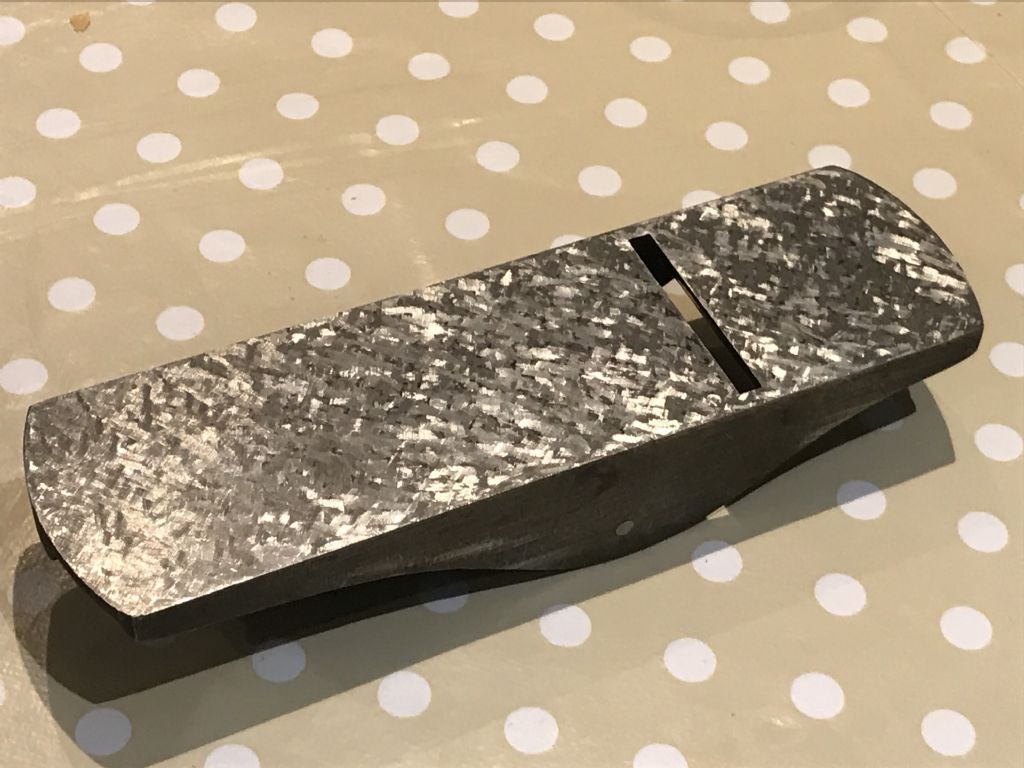

            For a machine build recently I did a bit of scraping – It avoided a couple of rather dubious setups on a surface grinder, as my mill is large enough to rough out the areas in 1 setup.
            Before I did that I did a little practice piece, on a gash 2" x7" wood plane. This is the end result:
            I only had to knock a few thou off the plane, and I was only trying to get flat, not flat and in alignment to something else.
            I have a new granite plate which I used as the reference.
            2d1566ea-d07a-4602-87d6-8f67582a8a19.jpeg The biggest thing that helped with consistency was buying an ink roller to spread the blue out. Before that I was using a wadded up cotton pad, which was very hard to get consistent blue spreading. I also ended up lookng like a smurf a lot…
            For a scraper I used a chunk of power hacksaw blade clamped to a handle made from a wooden file handle and some scrapbinium:
            Scraping is very relaxing, although physical work – it has a natural rhythm and work proceeds at a leisurely pace. I think the plane took about 4 or 5 evenings of an hour or two, but I wasnt rushing and I was learning as I went. The machine build needed a couple of weeks of evenings IIRC, bu then I did manage to mill it a bit wonky, so had to correct the geometry a bit as I went, as well as making the 2 dovetails fit together.
            There are a few more photos in the planar plane album.
            How bad are the surfaces of the plates you want to sort out? The odd pit wont matter to much – as long as there are not loads of them.
            Editied to add: I have a mill that is large enough to face off your plates in a single setup (TOS FNK-25) Im based in Castle Donington if that helps. They wont be meterology flat, but they will be close and clean.
            Edited By Dave S on 03/08/2021 18:24:11

              That herbert grinder looks excellent, that's the sort of work I plan tackling. Some bits will have to be farmed out, but the more I can do the better.
              I'll get a roller, getting the blue even is something I'm struggling with. I did a very, very small amount of blueing work as an apprentice, the instructor there was of the opinion that if you can see anything useful in the blue at all, it's too much :O This is not helped by the variable finish of the plate, some areas have black oxide in the pitting bottoms and it makes judging the amount of blue very difficult.
