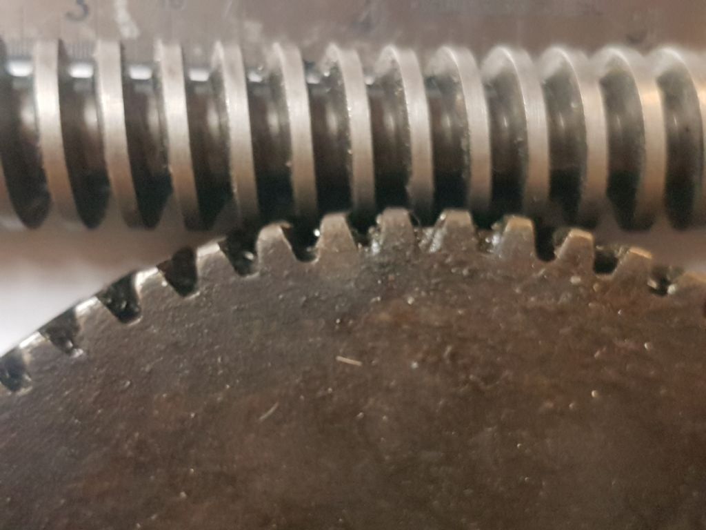

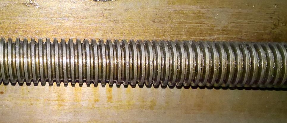

      FEED_SCREW_DETAILHello, I am getting very confused by square threads.
      I need to make a feed screw for my Milling Machine, and can't identify what type it is.
      It seems too deep for an Acme thread, and too sloped for a square thread.
      The dimensions I have are;
      Outer diameter = 5/8
      Inner Diameter = 3/8
      TPI = 5.
      The best I can measure the thread, it is approx 0.08in wide with a gap between threads of 0.12in to make up to the 0.2in for 5 TPI.
      According to wikipedia, an Acme thread of 5/8 should have 8TPI.
      So is it a wide Acme thread? Or a square cut one?
      If an Acme thread, do I need to grind a cutter to the correct 29 deg angle? I have a Myford and a grinding wheel, so can this be done using the top slide? So the angles are precise?
      Or any other clues would be most helpful. I last cut a thread about 20 years ago in a college workshop…
      Many thanks in advance, and sorry if the description is a bit garbled. Threads still confuse me. Every bolt I come to is always a trial and error..is it a Whitworth, a BA, a metric, a AF….So Acmes, Square threads, Trapeziodal threads….,

        #605547
        old mart
          @oldmart
          Square threads are sometimes made with slightly sloping flanks, that may be why you are having trouble.. If you have any slips, you might find the taper by checking the unworn part of the thread.
          #605548
          David George 1
            @davidgeorge1
            Fairly easy to make a cutter from HSS. Just copy the shape of the thread form from the original on to a piece of tool steel and make sure there is cutting clearance on end and both sides but leave the top flat. Then just turn the blank to size and plunge the cutter in till correct depth 8 TPI.

              #605552
              Anonymous
                Looking at the picture the thread is definitely Acme/trapezoidal, not square. Forget Wikipedia, Acme style threads can be whatever the manufacturer decides, although there are standards for the shape of the thread form.
                Looking at the picture can we assume that the screw mates with a gear? If so then the flank angle of the thread should match the pressure angle of the gear. Furthermore the depth of the thread will be determined by the addendum and dedendum of the mating gear.
                Andrew

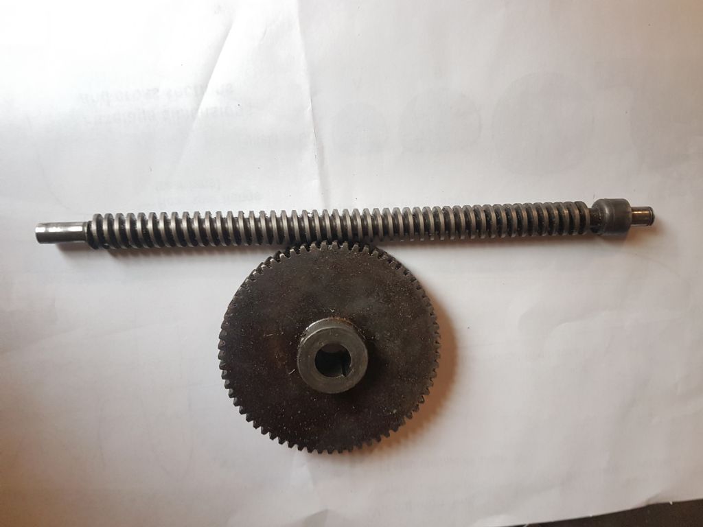

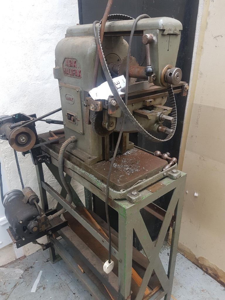

                    20220713_003649.jpgThanks for the replies.
                    To add more details, I have added a photo of the whole mill, and a close up of the large gear wheel tooth.
                    The part I am replacing is the feed screw for the table. The Mill was dropped in transit, and the handle broke off. I've had it for a few years, and have been putting off repairing it. But needed a circular saw this week, and so it prompted me to look again.
                    So, the consensus seems to be it is an Acme, but use the existing thread form as a guide. How accurate does the grind have to be for the tool? If it is a Acme thread, then should it be 29 deg? Would that be two angles of 14.5deg? I can't imagine my freehand grinding would be accurate enough, hence the thoughts of using the lathe.
                    I can set the tool post to the correct angle, and with the grinding wheel in the chuck, get pretty close. But will this damage the lathe?
                    Do I need to think of anything special regarding the cutting tool? With the depth of the cut, and the the narrowness of the blade, I fear broken cutters all over the place. Parting blades are notorious for breaking, well at least with me! What speed should I run at? Is it better to go fast or slow? Does it need coolant?
                    Anyway, many thanks for the guidance.

                                      Looks like a helical gear and worm, not easy to get the worm cut correctly to mesh fully. Interesting information here that I often used to use KHK Gears

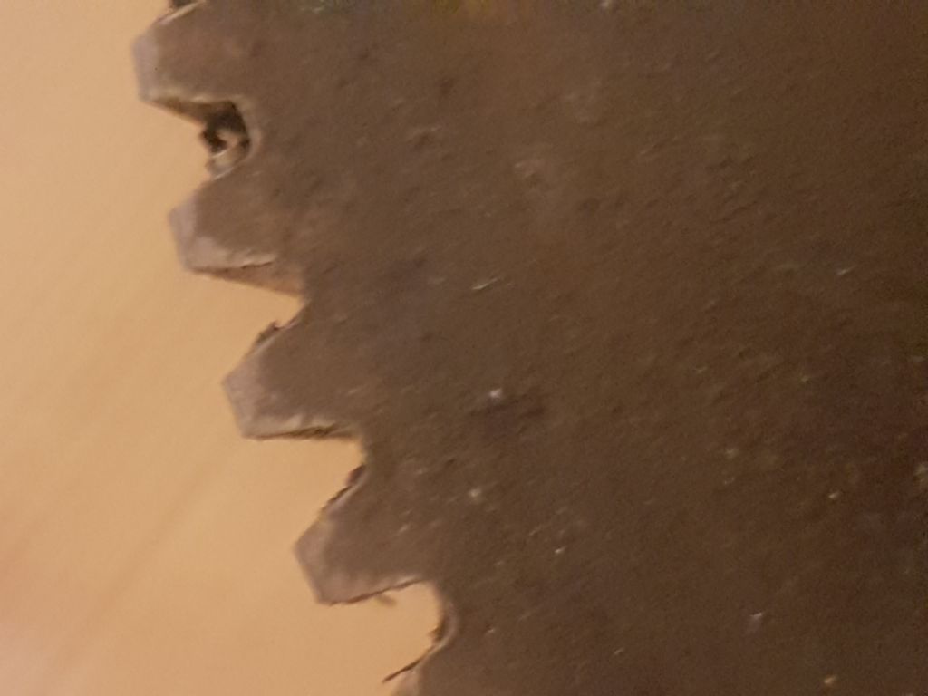

                                            If the "thread" is to drive a gear, as NDIY says, it is not a screw, but a worm
                                            So the "pitch" needs to be the circular pitch of the wheel that is driven.
                                            Without further recourse to Ivan Law's book I could imagine that the form is straight side, like a rack.. But I may well be wrongt.
                                            If it is not rack form, it would need to be the same form as the teeth on the wormwheel, probably involute. (But an involute rack (If that is not a contradiction in terms ) has straight sided teeth with a suitable helix angle.
                                            Come on gear experts!

                                                Looking at the enlarged picture:
                                                The broken Leadscrew looks as if it would engage with a nut to provide cross feed for the Table.
                                                The upper square shaft would probably be end of the Leasdscrew that moves the table, across the Knee, to or from the main column.
                                                Does the lower Leadscrew provide the vertical movement for the Knee?
                                                But with what does the gear, that is visible engage and what does it do?
                                                Howard

                                                AJAX
                                                  @ajax
                                                  I have the same milling machine.
                                                  The broken leadscrew drives the x axis when the worm wheel rotation is locked.
                                                  The leadscrew also acts as a rack. When the worm wheel is unlocked it acts as a pinion, allowing rapid traverse with a handle.
                                                  On my list of jobs to do is to get rid of this drive as it is a source of vibration.

                                                    Nicholas Hill
                                                      @nicholashill23289
                                                      Many thanks for all the info.
                                                      Overnight I ordered Brian Wood's book on Gearing of Lathes, and it seems the people calling it a Worm are quite correct.
                                                      I had never heard of Diametral Pitches before. But after looking into them, it works out almost exact. The larger gear wheel has 66 teeth and is 4.1 inch in diameter, giving a DP of 16.1.
                                                      A DP 16 has a pitch of 0.196 inch giving the 5TPI I measured!
