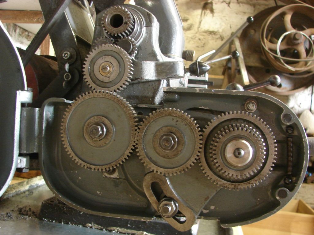

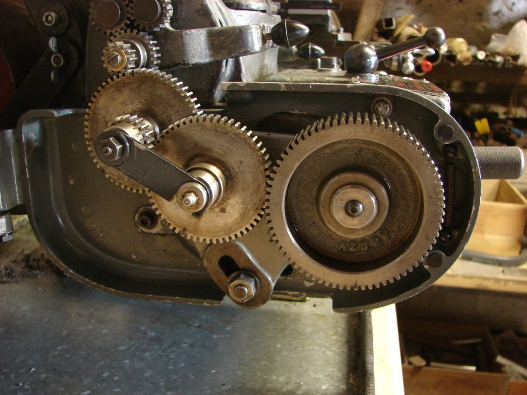

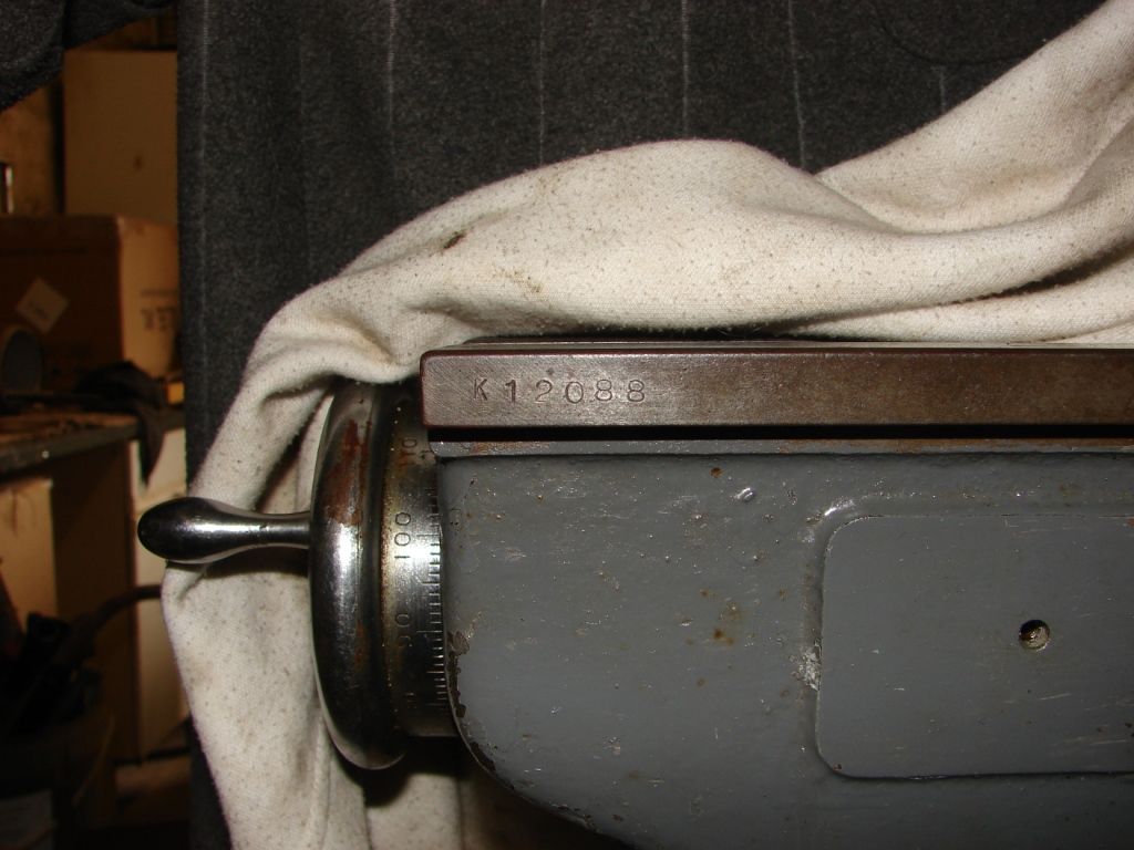

                    dsc01965.jpgdsc01958.jpgdsc01953.jpgdsc01948.jpgdsc01946.jpgdsc01945.jpgHere are some photos. I found a serial number on the back of the bed but can't see one on the gearbox as the Myford manual shows. The manual I got with the lathe has the same number on the front in biro along with two other numbers K25915 and R9960 maybe one of these is for the gearbox ?
                    I took a photo of both the imperial and metric gear set up just to make sure I have it correct, the two small gears on the 60T leadscrew are just used for spacers.

                      The last but one of your photo's shows the cover plate of the older Mk1 gearbox. The newer Mk 2 gearbox also has a cover, but it has a 2:1 step down gear pair hidden behind it. The import of this is that Myford decided to run the internals of the gearbox at twice the speed of the original design. I would imagine this was a ruse to reduce the torque transmitted by the gears as at that stage of its development the internal gears of the QCGB weren't hardened. Eventually Myford built these gearboxes with hardened gears inside, but that's another story.
                      Further evidence of this being the old Mk1 slow speed gearbox is in photo 3, which shows that the mandrel gear is 12 teeth. This gear is 24 teeth when driving the Mk2 g'box. I'm assuming that the set-up with the two 51/17 gears between the mandrel and the broad 72 T g'box input gear cuts TPI's as detailed on the g'box top label – i.e. the imperial settings all work out, it's just the metric conversion kit which has screwed things up.
                      Unfortunately it seems that Myford only ever made a metric kit for the Mk2 g'box, though there were undoubtedly two versions of this kit and so there are two different label diagrams with the accompanying table of gears to use. This appears to have been a cost cutting exercise – that later kit has one less gear in it. AFAIK you can use the banjo with either selection of gears.
                      If you can fathom out a way of reducing the input speed of the g'box by half I think you will have solved the problem you have encountered with cutting threads of twice the pitch expected. A 120T gear on the leadscrew would do it, but I'm not sure it'll fit in the space available.

                          Hi Simon and Many thanks for getting back. The sticky for uploading photos by Neil was a god send and easy to follow.
                          I forgot to add the gear sizes from the top in my last post they are 25T then the two on the revers lever are 20T Left and 18T right 25T-12T cluster then 57T-19T and reversible 19T-57T then to the 72T
                          I've not checked to see if the imperial side is fine but will give it a try and see what I get.

                            Though no expert, on seeing the pictures The box does not look like mine which I knew was the later one, so it must be the ealier version with unhardened gears. I must also thank Simon for the long explanation, I had not realised that the later box had a 2:1 ratio in it . 51/17 sounds like the back gear ratio ? Though I have never tried to use it I do have a 127T change wheel for metric threads, came in a box of bits – not sure it would fit ? The cover would not close ! Noel
