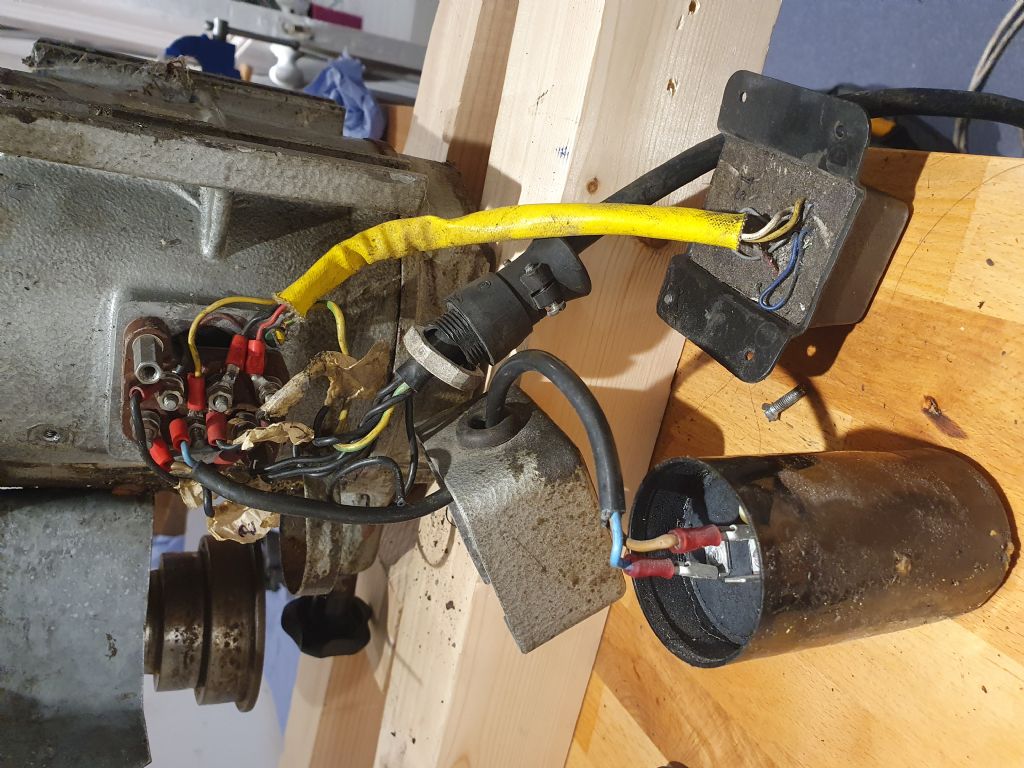

      Hello all,
      I am in the process of restoring an old Schaublin lathe that hasn't been used in a while.
      I have recently turned my attention to the motor, which I had had running previously but only for a short time.

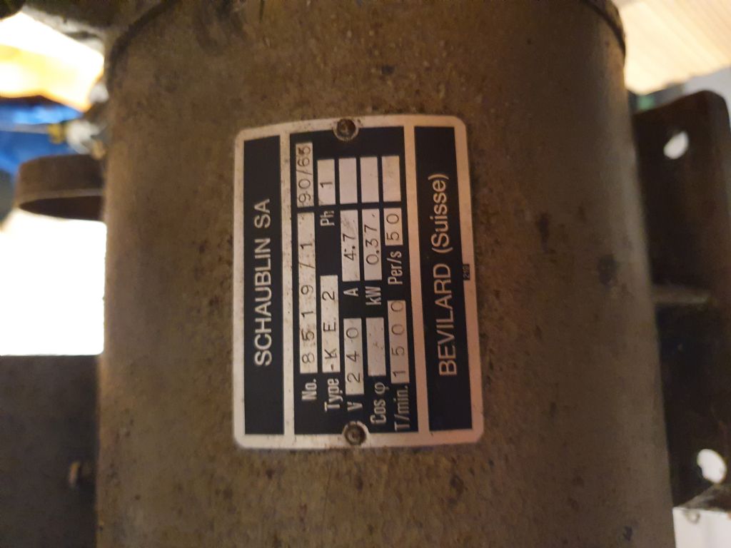

      Here is the motor plate for ref.
      Apologies for the rotational issues, they are the correct orientation on my computer!
      As you can see it is a 240 V single phase unit.
      This is the current state of the wiring at the back of the motor, it is connected to a 3 position, forward and reverse switch.
      From my limited understanding, the cylinder is a starting capacitor, which I know to work as the motor does start when plugged in.
      It then runs very hot and started to smoke so I quickly un plugged it.
      Again, from my limited understanding this unit is the running capacitor:
      It doesn't have any markings except for ISSA.
      Could a fault in this be the reason for the motor to run so hot or will it more likely be an issue with the windings?
      I imagine it is probably difficult to know without someone with more knowhow than I possess looking at the motor but I thought I would ask and see if anyone could shed some light on the issue.
      Many thanks,
      Matt

          I'm fairly certain that the device marked ISSA is a timer to switch the cap that you have in and out of circuit when needed
          Rather than having mechanical switches inside the motor ( centrifugal switch)

            This looks very much like the Centrifugal Switch has stuck the part of this switch is the sleeve that moves on the armature shaft disconnect the start winding and changeover to the run winding . when this does not change the motor runs hot very quickly and starts to smoke , You are going to have to dismantle the motor to check for problem does happen when a motor has not been used for some time.
            Regards Bee.M

                Good luck, but I think the motor is likely ready for rewinding/replacement. Can’t be sure but it will be lucky if it is recoverable.
                Smoking likely means one of the windings will be short circuited by now – enamel insulation melts before starting to smoke. No brushes in an induction motor.

                        He did say that the old mechanical centrifugal switch must have broken at some point, and that the mystery black box was an electronic replacement.
                        If it's not worth repairing I will search out a 3 phase equivalent.

                            Yes, but… Even if that part was faulty it was not where the smoke was coming from, that is likely to write the motor off.

                              But it will be the timer switch that has caused the smoke to be let out.
